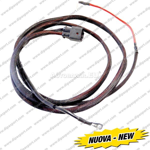

Hey Croma users. I want to ask where i can buy end connectors or whole cable for servo pump ... something like this but a bit cheaper. I found out this was a whole problem which caused red steering wheel, but connectors must be replaced

Hi,
Also look for a lead for the Opel / Vauxhall Vectra C. They use the same physical pump and have the better connector (pump software is different so you can't use the Vectra pump on a Croma).
Even a connector from a scrap Vectra is better than the Fiat one.
Example at random no idea if seller or aitem is ok
www.ebay.co.uk/itm/2007-Vectra-C-5DR-1-9-CDTI-POWER-STEERING-PUMP-WIRING-LOOM-13160253/183759277688
Robert G8RPI.
As Robert says get a scrap Vectra one. Fitting is easy enough - take the drivers wheel off and the access panel to push it into place. Only tool you need is to connect it to the battery.
