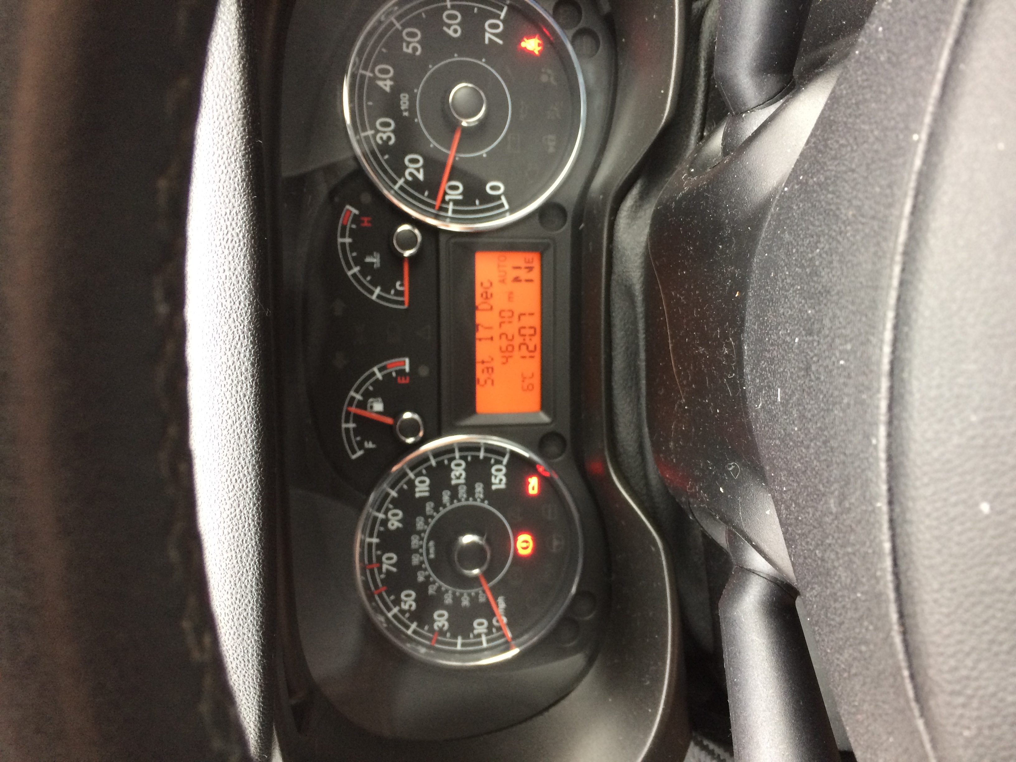

Hi there. when the car has been locked for a while and I unlock and open the door I hear a noise as though something is starting up. I f then close the door and open it straight away the noise doesn't happen a second time. The engine will turn on fine but when I put it into gear the car starts beeping. A red flashing light comes on under the speedo at the right hand side of the circle but I cant find a reference to it anywhere in the hand book. Also where the clock is the words "CHECK TRANSMISSION SEE HANDBOOK" come up. But the handbook says nothing about this and nothing about semi/auto dual logic transmissions. Its almost as though its a book for a different car. Does any of this shed any light on the problem? Car still just says is in neutral at all times
Kind Regards Jim
Attached pic of light

its basically a lot of sensors not "talking" to each other,,
so either a porr wiring connection , or limited electrical power,
the basics would be get the faults CLEARED..if possible - then see what returns quickly.
could be a dodgy connection / loose wire,
broken part..
or maybe just a poor car battery dropping too low in power on cold frosty starts..
