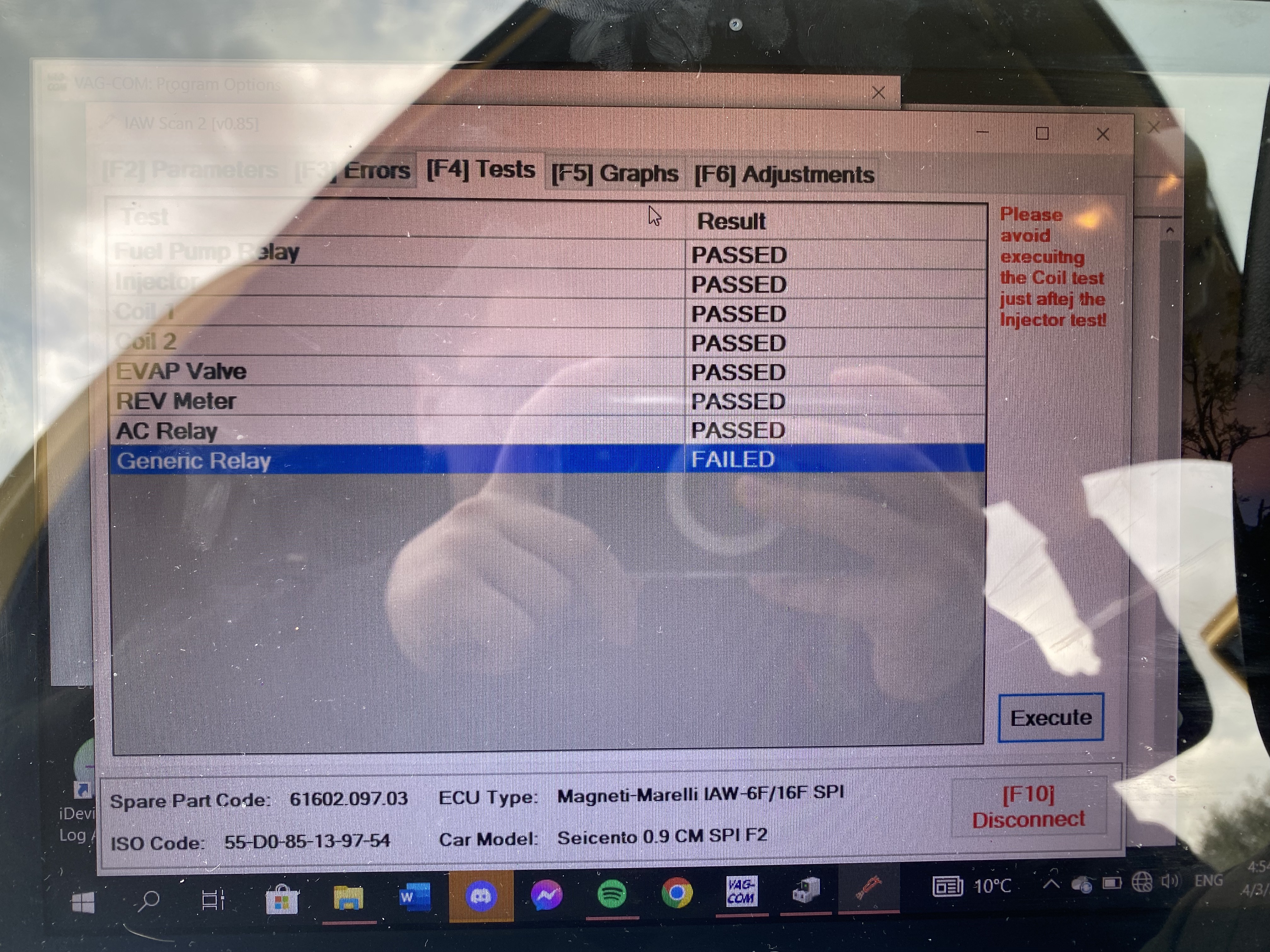

Hello, I have a 1999 Seicento Sporting Spi and i have a problem where when i leave the car for few days untouched, it doesnt want to start.
It's cranking until i let it go. I can see fuel in the tb, i believe it doesnt give spark to ignite.
To begin, i have changed spark plugs, coil packs, plug leads, injector, fuel pump, new alternator, fuel filter, map sensor, icv, tps and cankshaft position sensor.
The problem persists so i ordered vag kkl cable and plugged in my computer.
No error, run all tests and the iawscan2 said a generic relay failed.
I think this is causing the cold start.
Please, if you have any ideas i'm more than happy to try.

The generic relay test is also failing in my seicento sporting. I believe that is just a problem with the iawscan.
Right so it’s no problem. Then what is causing my cold starting problem?
I’ve really run out of ideas.

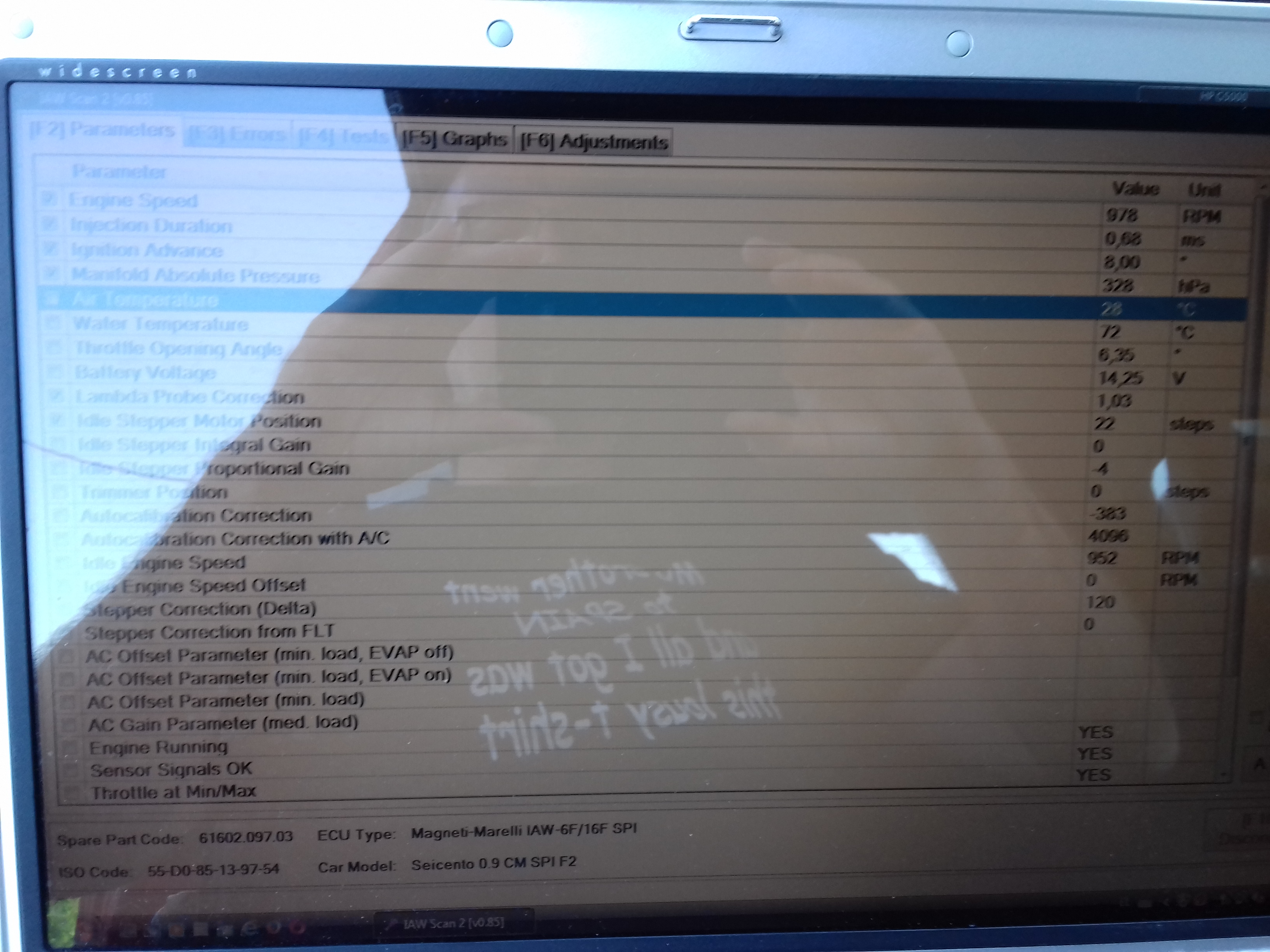

When it runs, are everything all right; New icv may need resetting. I believe you can do that through the Adjustments tab of iawscan2. I have also attached a photo of the iawscan parameters screen of my 99 seicento to compare normal working values.

so my values are around the same as the ones you attached when the car starts.
It's before it starts that something is happening.
