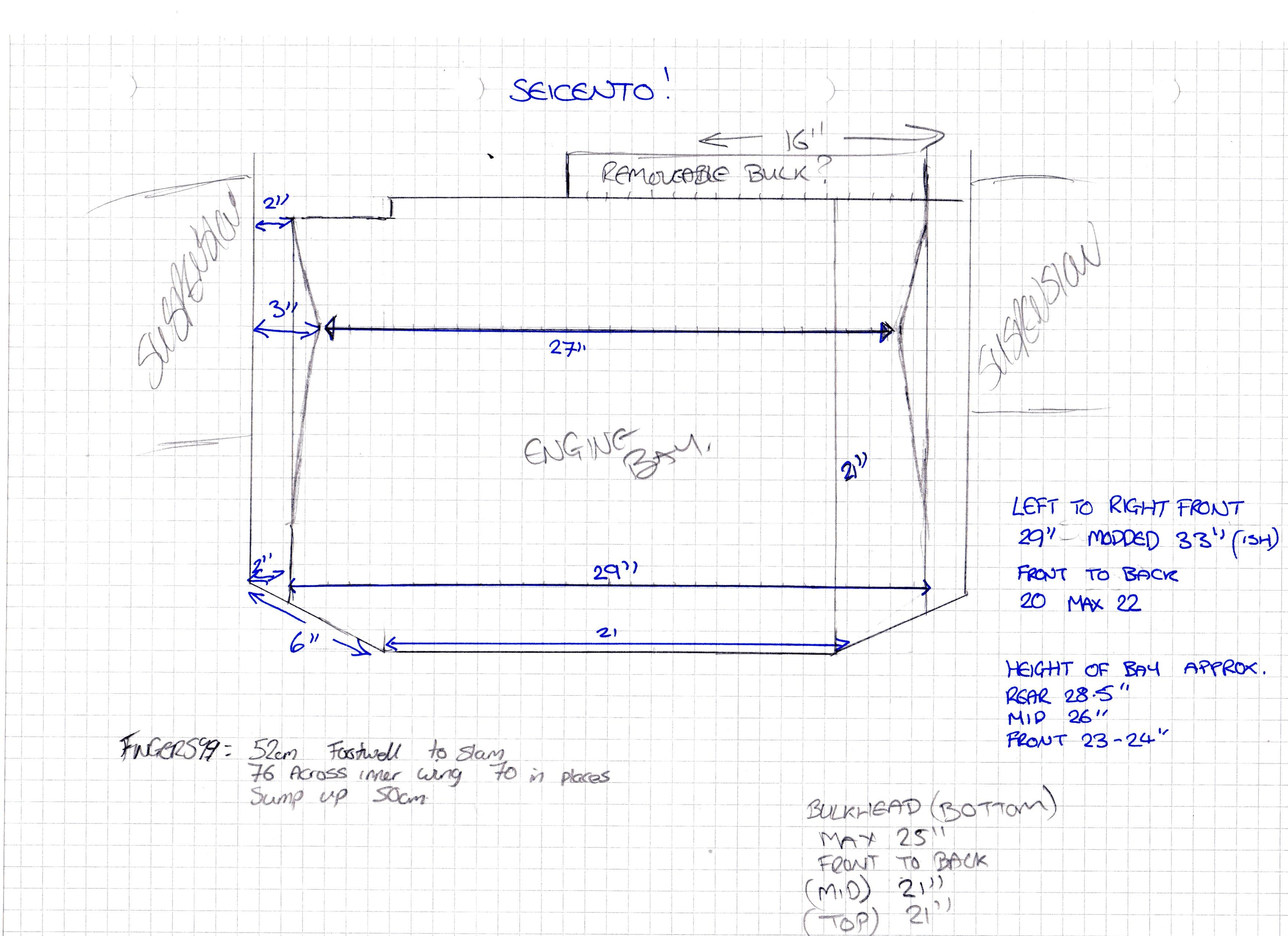

So, the dimensions -- should be just about identical for Sei
52cm bulkhead (footwell) to slam panel
76cm across inner wings (the "horns") but approx 70cm where horns bulge inwards
from sump bottom to top of bonnet approx 50cm

Going on them measurements the engine is approx 10cms too heigh (which could be altered with 15" wheels, and lowering the engine) and im about 5cms out on the width of the whole thing. This is in keeping the car as a non-flip idea...

Today has been a busy one... got back from the scrap yard and started to underake some blue-peter style drawings, measurements and general brainstorming... so far i think the flip front is the best option... as going by the measurements so far it looks as if there would need to be a lot of bulkhead and inner wing work doing.... And it might just be easier to cut it all off and start a fresh. If im to keep all the inner wings i would need to remove the horn sections completely, and then cut out the footwell and move that complete piece around 4 inch's back into the car... with the frame i can avoid that all.
Ive planned out MAX measurements of the engine, obviously in some places there will be a difference etc with things like the gearbox being lower etc....

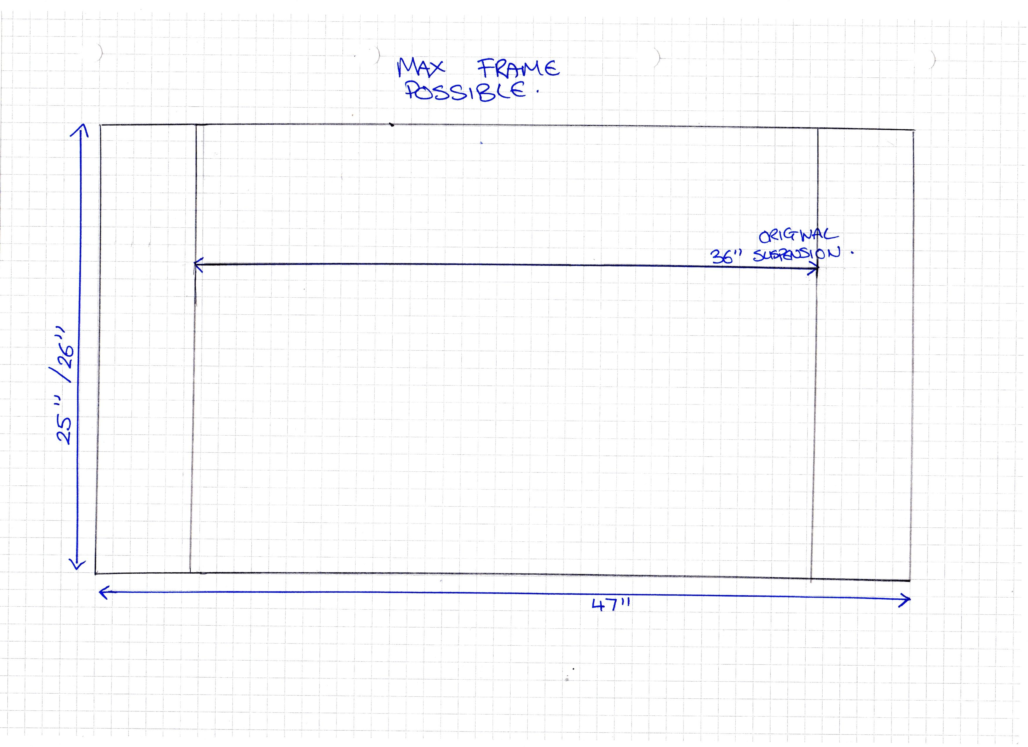

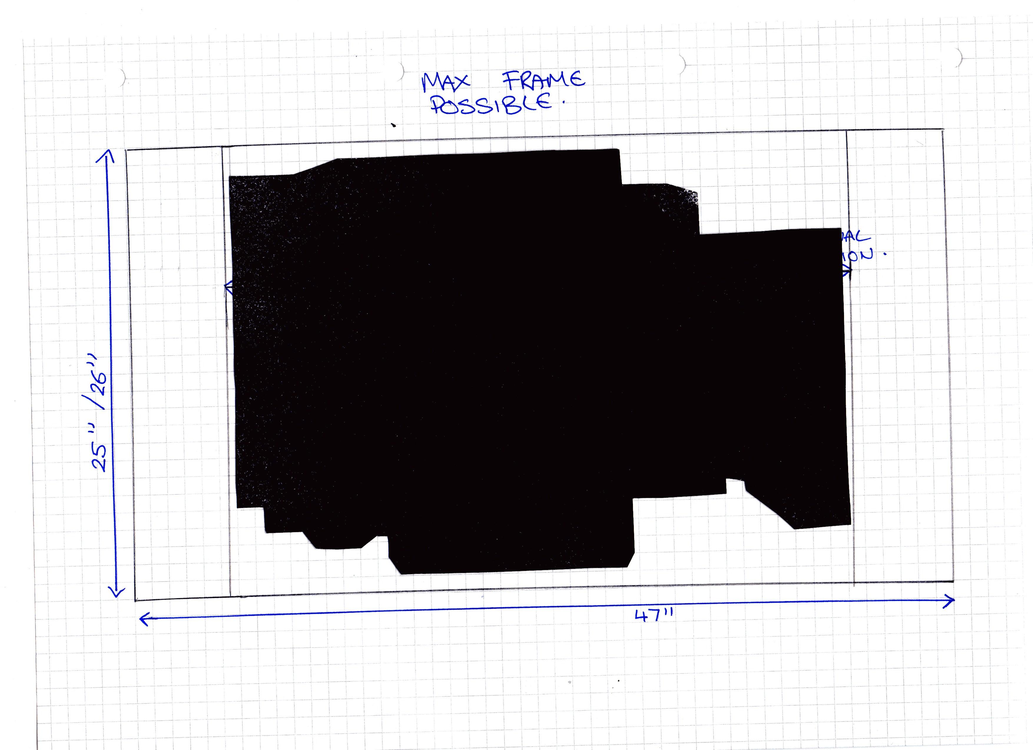

So far this is what i have got... were moving onto the 3d plan next (sounds stupid) but were going to knock a scaled engine bay up out of wooden coffee stirrers (thank you ronald mcD) and see what the engine would foul on... Also were going to make up a temp flip frame one up too to see if its easier to work with.

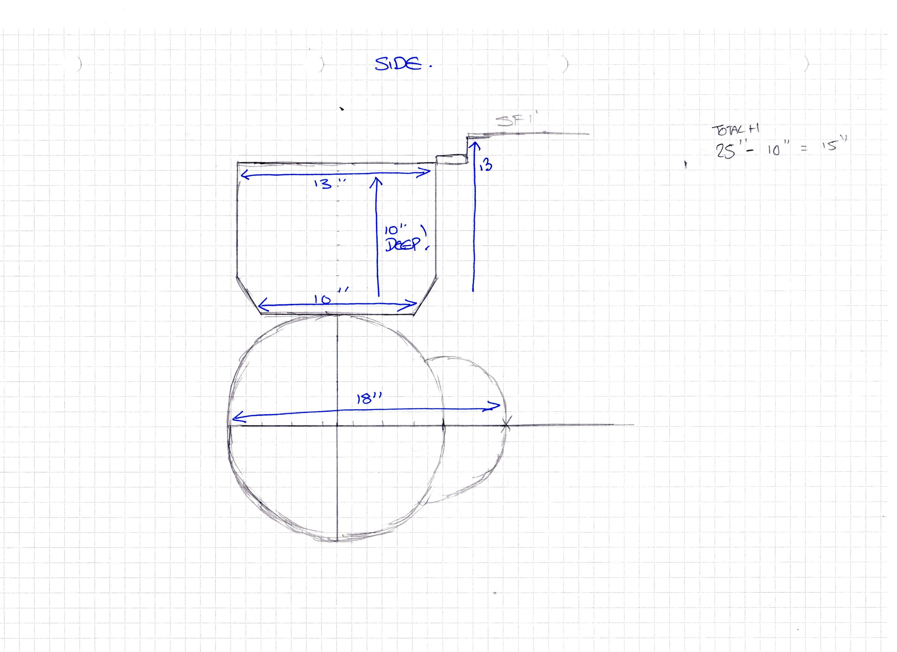

The height of the block is really going to be an issue as i dont want the engine to be that noticable... i need to make 5" up somewhere.... :S
Thinking of mounting the engine lower than it is in the sei, and then raising the bonnet a tad, not sure really how i can get round it on paper, as i can only really judge it when the frame has been built...
These are the measurements i took today, and also incorporating some of your info also...
(everything has been scaled on graph paper, yet you cant see the squares from the scan).
(i know the gearbox isnt to scale on the side on of the XE)
