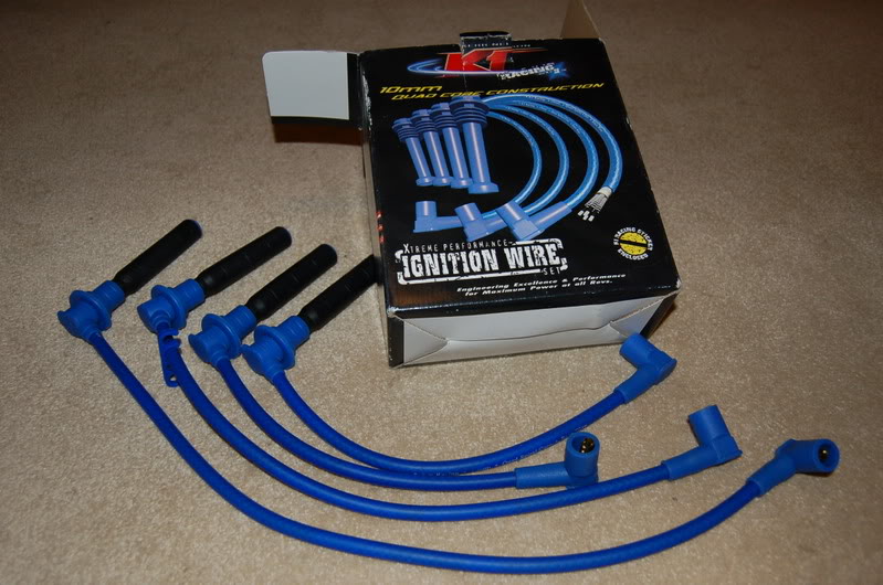

Latest purchase for the project are these K1 Racing ignition leads which i found brand new on ebay for a bargain price of £36 :D They retail at around £80 in shops :eek:
