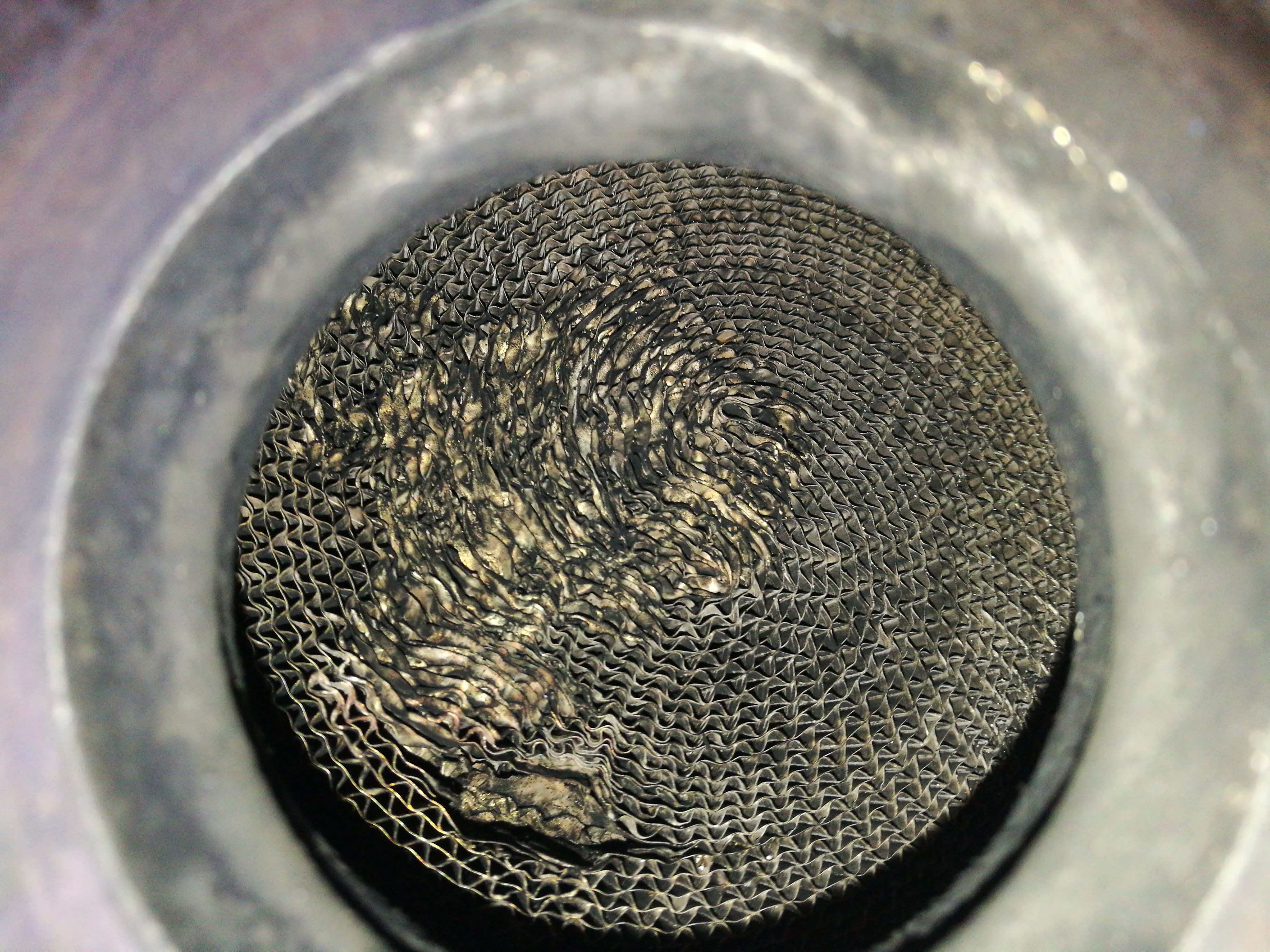

I've ordered elm and leads, for now I'll just see how it goes, due a regen Friday/Saturday. I'm keeping the live mpg on while driving because I won't know if a regen is taking place if there is no smoke! I've measured external temp of pre cat now and it's 128°. The pic is of my old pre cat

My old precat looks in good condition sooty on inlet side (from engine) but filter clean on outlet, filter looks unmarked,. So I will see how it goes.
