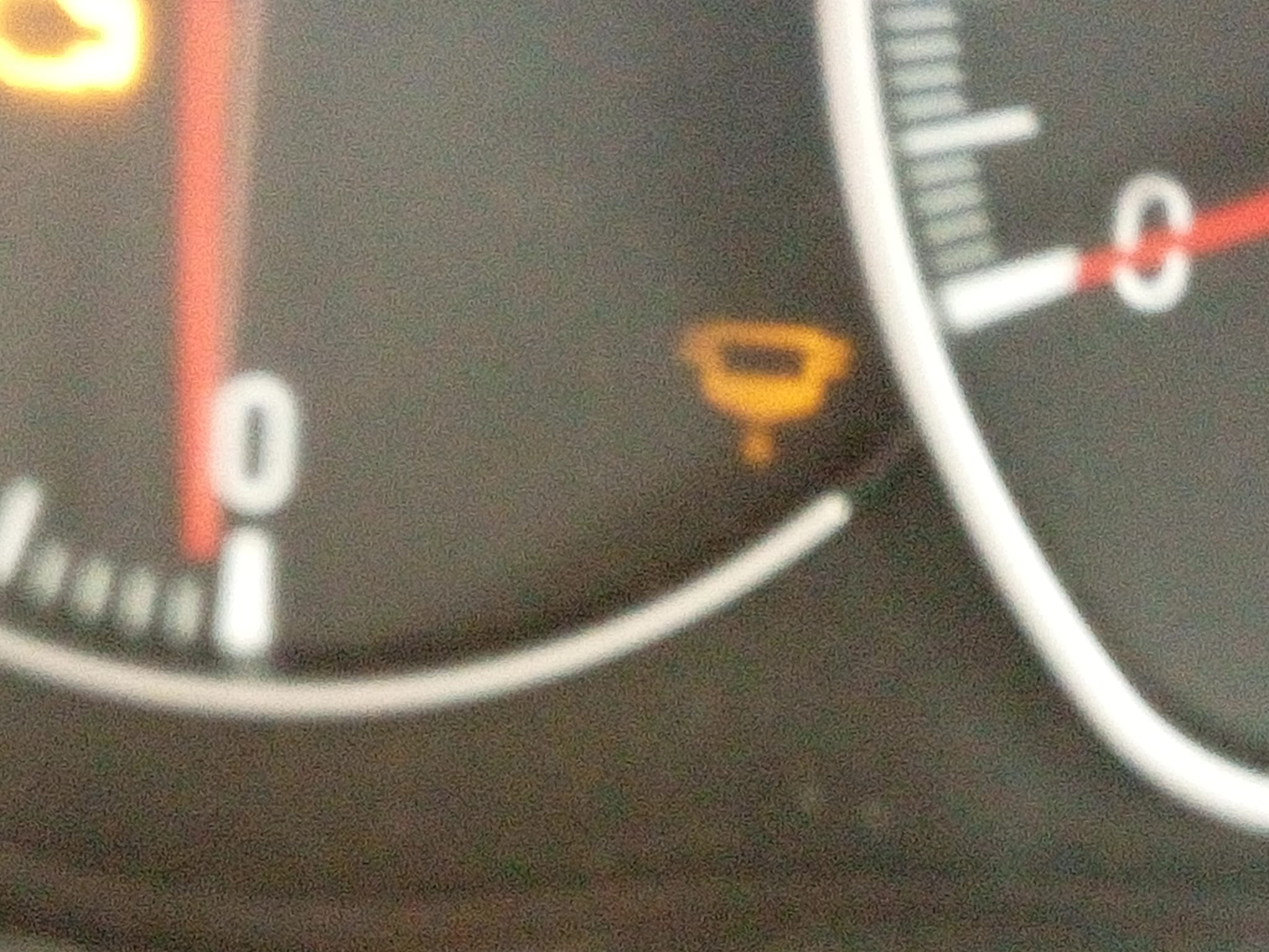

Still got this problem with my brake pedal. I checked the obd info with a meter for error codes but there were no codes stored for it.
I now have a new light that displays on the dash for the last 2 days never seen it before but it disappears when the engine starts up (have uploaded it). I'm reluctant to try and remove the ABS to send it off to ECU to be bench tested as it might not be faulty. Plus I'm not experienced enough to remove and refit it.
Any ideas anyone?

Looks like this one:
