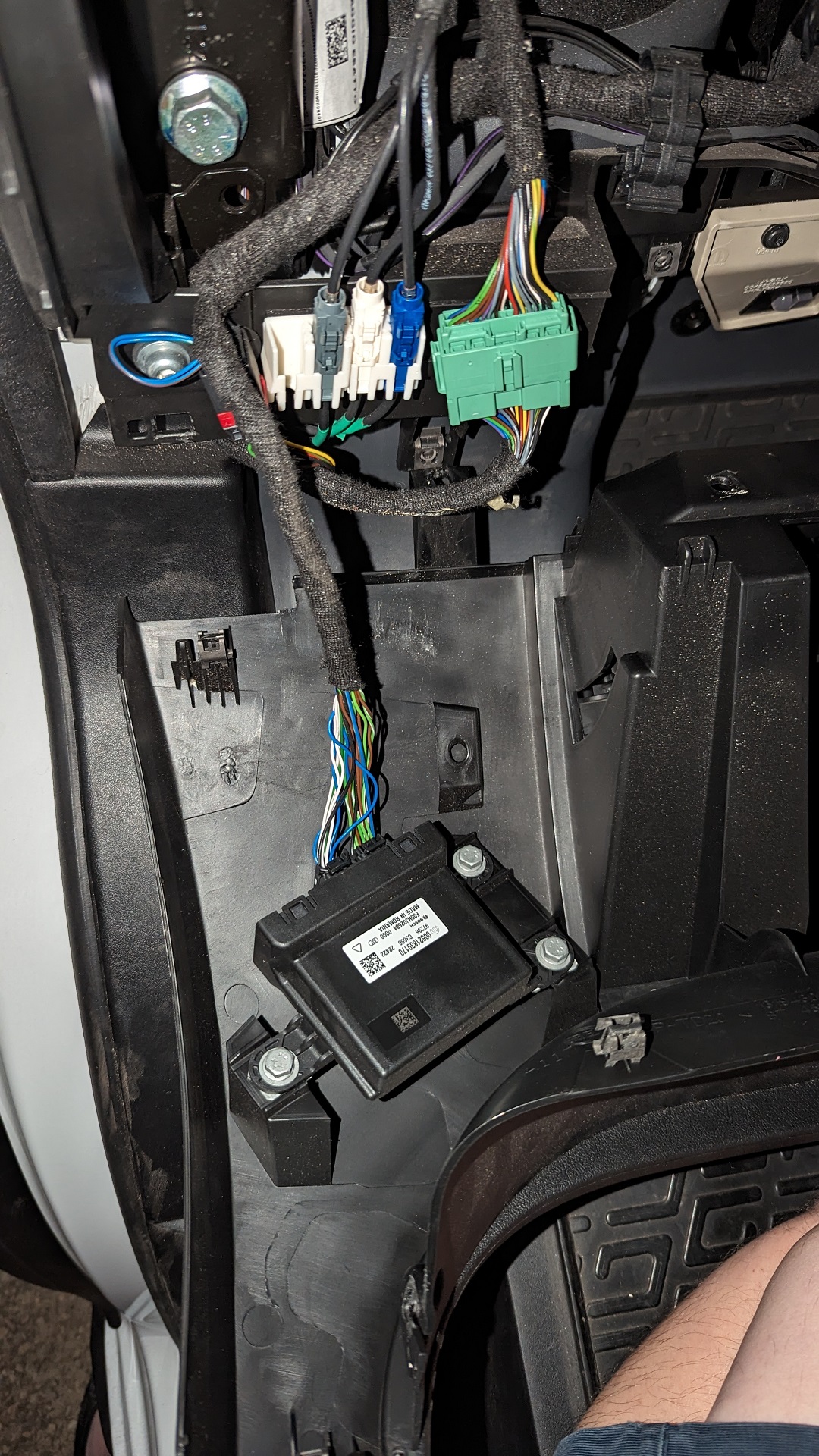

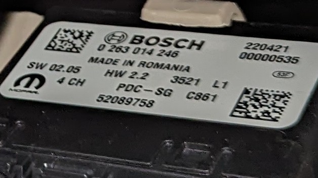

I looked up the codes on that box and it appears to be something to do with parking sensors? Definitely no mention of a SGW module. The plugs appear to be correct 8+12pin.
Ive found a similar parking sensor module on my 2022 Ducato. Same 8+12pin connectors plugged in to it. Do we assume this is the SGW module? I'm about to buy a SGW bypass cable, is it all safe to unplug the parking sensor module and connect a obd2 scanner? I read somewhere to disconnect the battery before unplugging the sgw module?

Where is this box located as I am not sure it’s correct. It definitely isn’t anything to do with parking sensors. If you unplug the incorrect thing you may throw up a code and not be able to clear it my SGW on a 22 ducato is behind the dash on the passenger side you can see it from the side panel
Just took the picture looking up behind brake/accelerator pedals. RHD aus delivered Ducato. Were should i be looking on the passenger side? What do you mean by see it from the side panel?
Difficult but if you drop your glove box down you should see it it’s help in place with two 10mm but you can just unplug the two cables, keep us posted

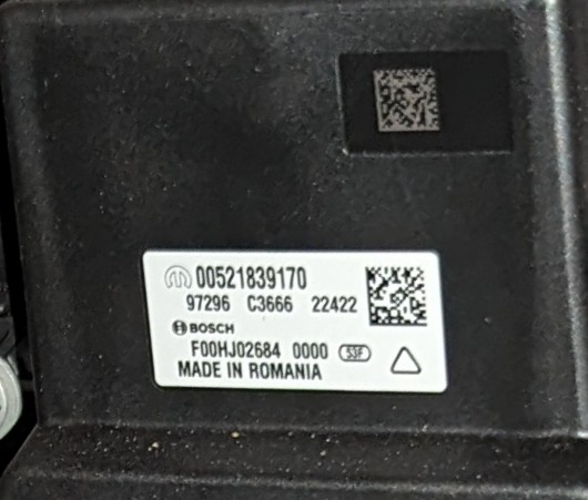

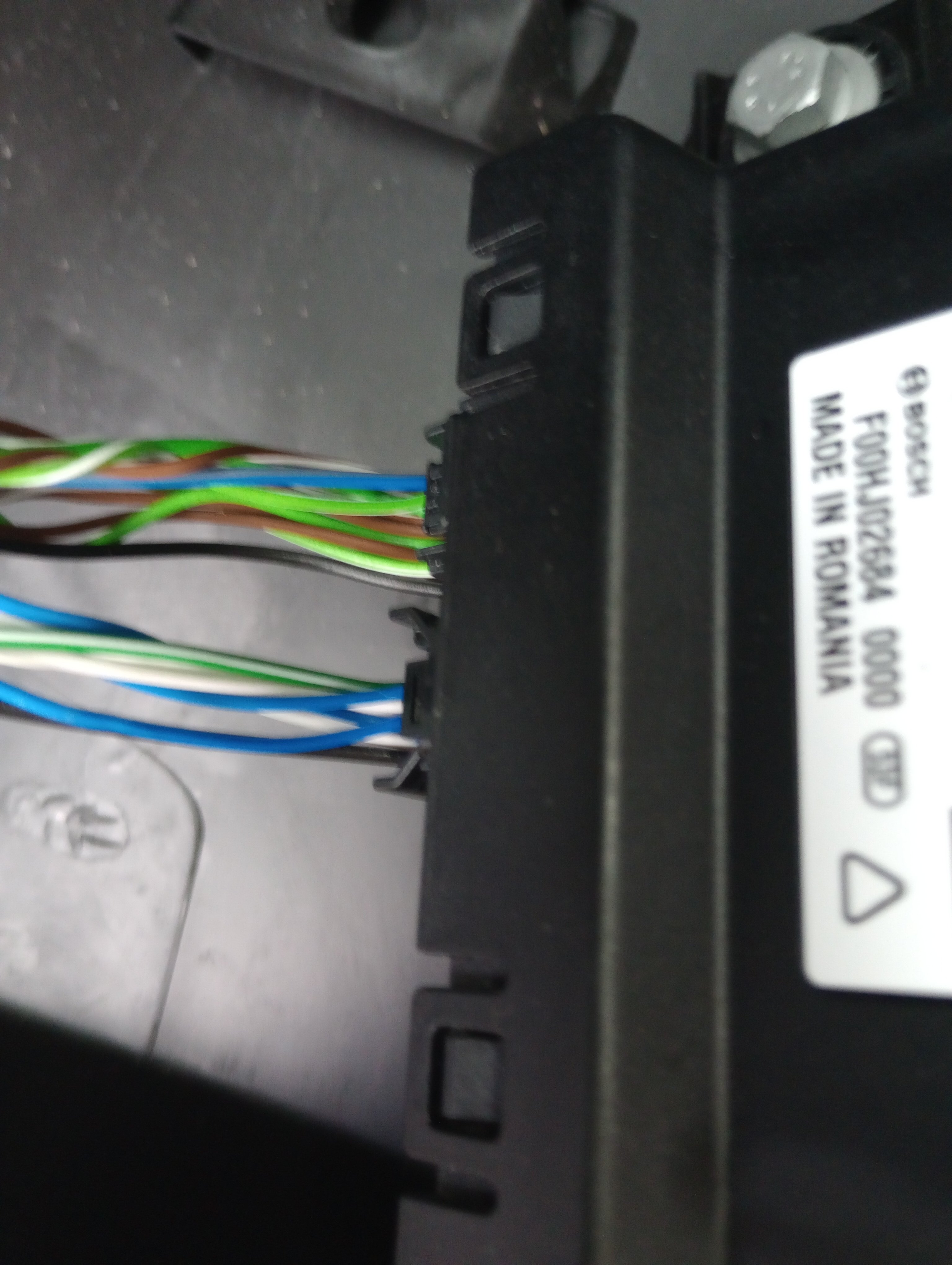

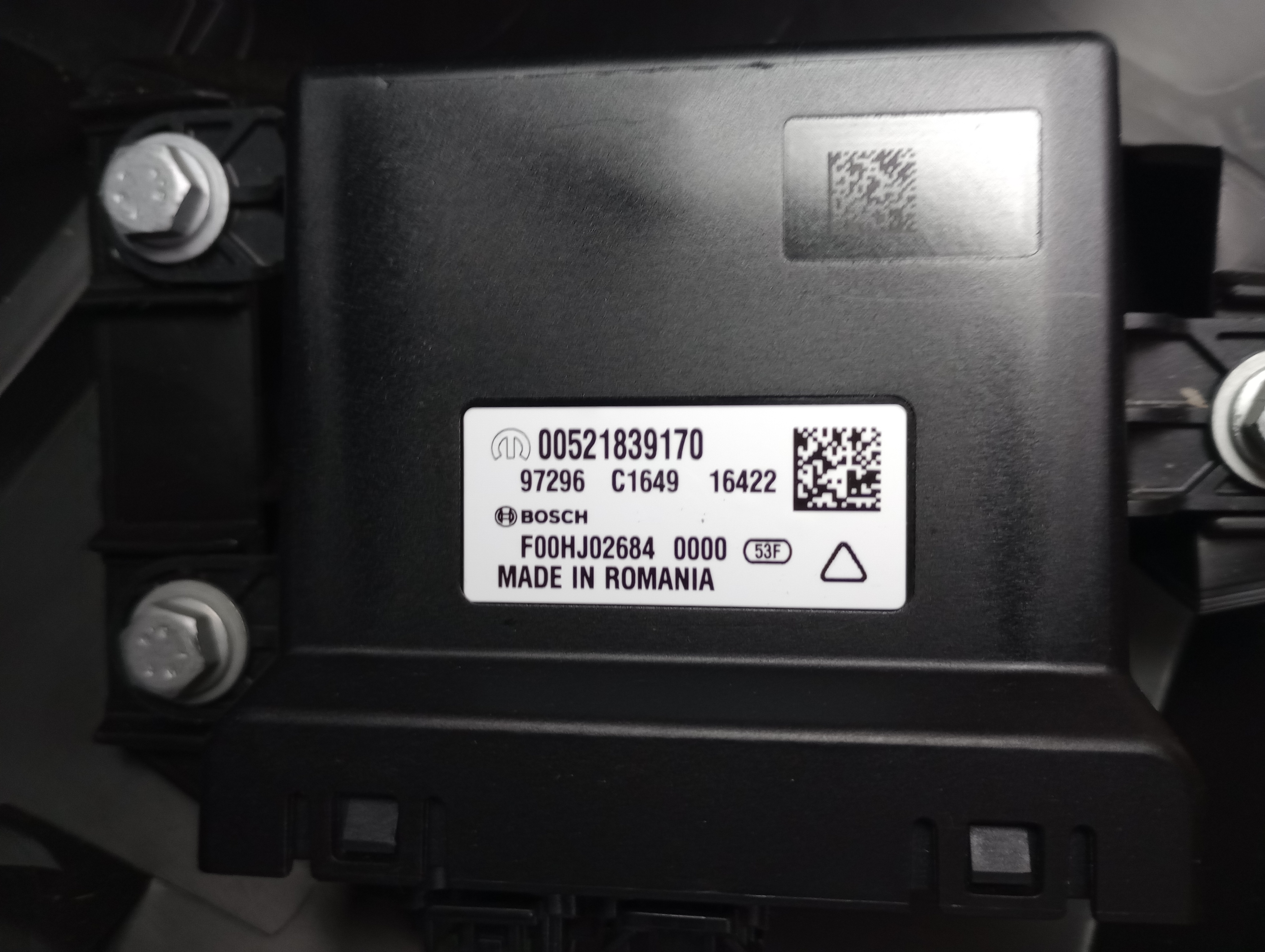

You appear to have attached the image from the doblo 1.3 rhd guy above. That is a different vehicle. As i said before i googled the numbers from that image to find that was a parking sensor module. I then found the same module in my 2022 ducato, googled the numbers to find it was a parking sensor module too. Ive now removed the glove box to find another same dimensions box with the same 8+12plug googled the numbers again and found this one is for the automatic transmission. image attached. will keep looking

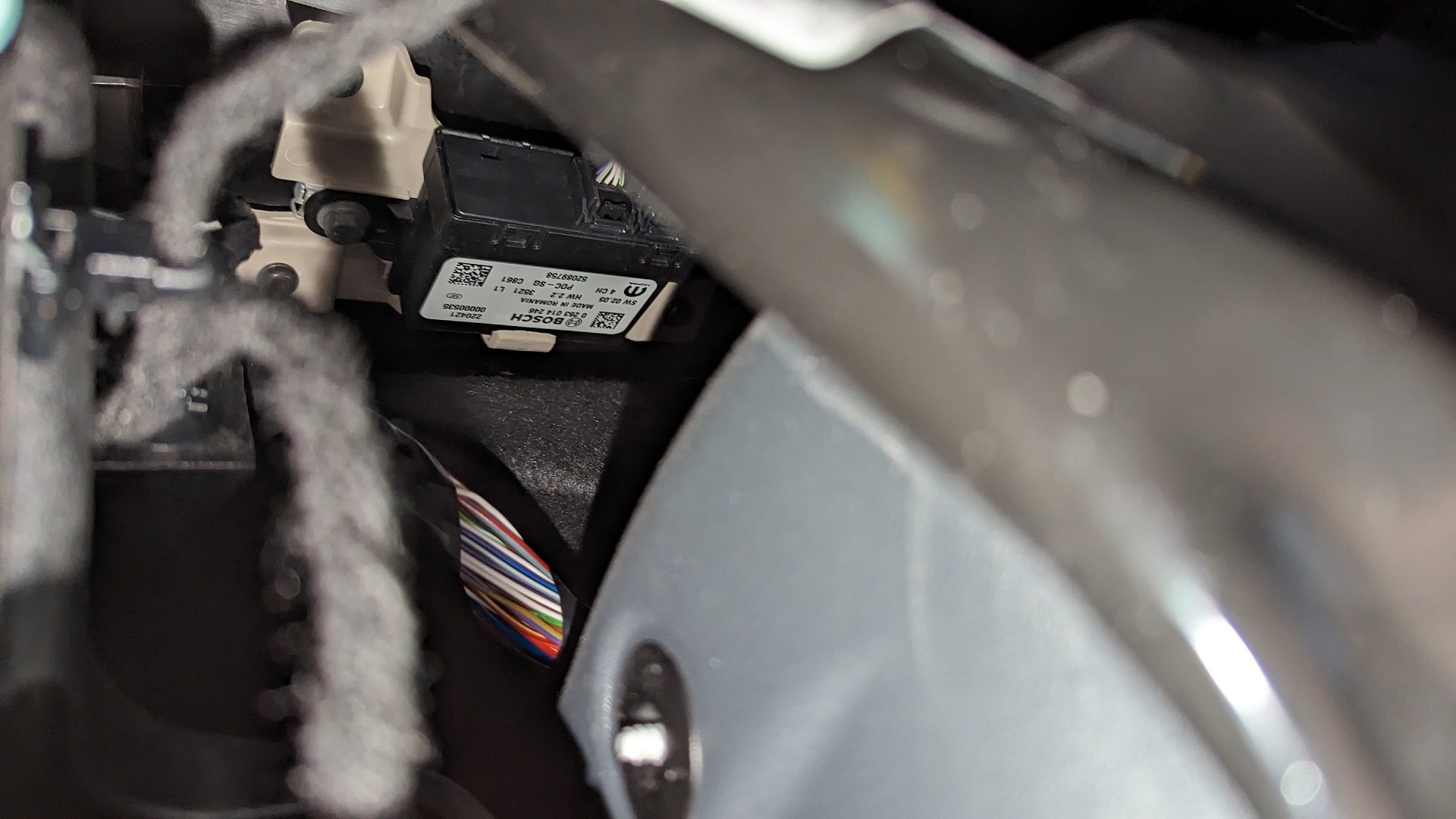

Ok here we go a bit rubbish but I think you have the right thing and I am told the codes and numbers are to make you think you are looking at the wrong thing if I can get more pics I will but it’s a pain to strip down I have pointed to exactly where it is on mine I dropped the glove box down and found it took the two plugs off
On my 2022 Automatic Ducato in the location you have indicated I have this module but looking up the code it is either an automatic gearbox controller or a parking sensor module. Have you tried to bypass this?
