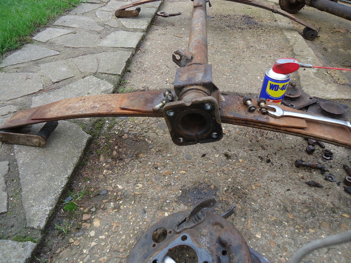

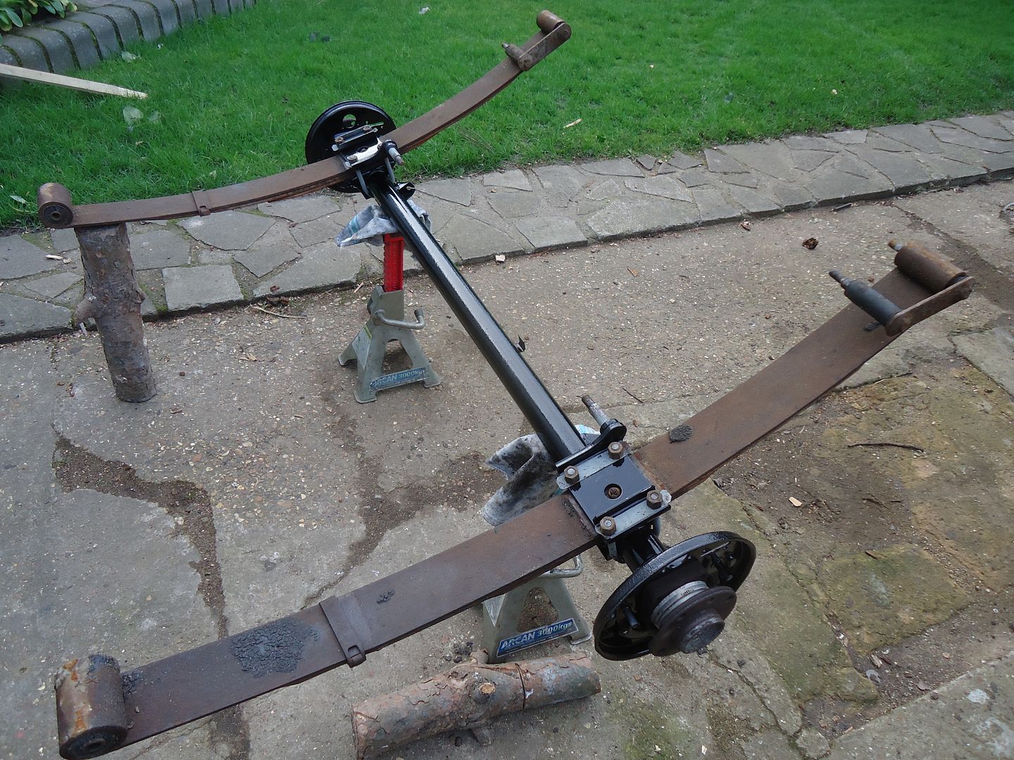

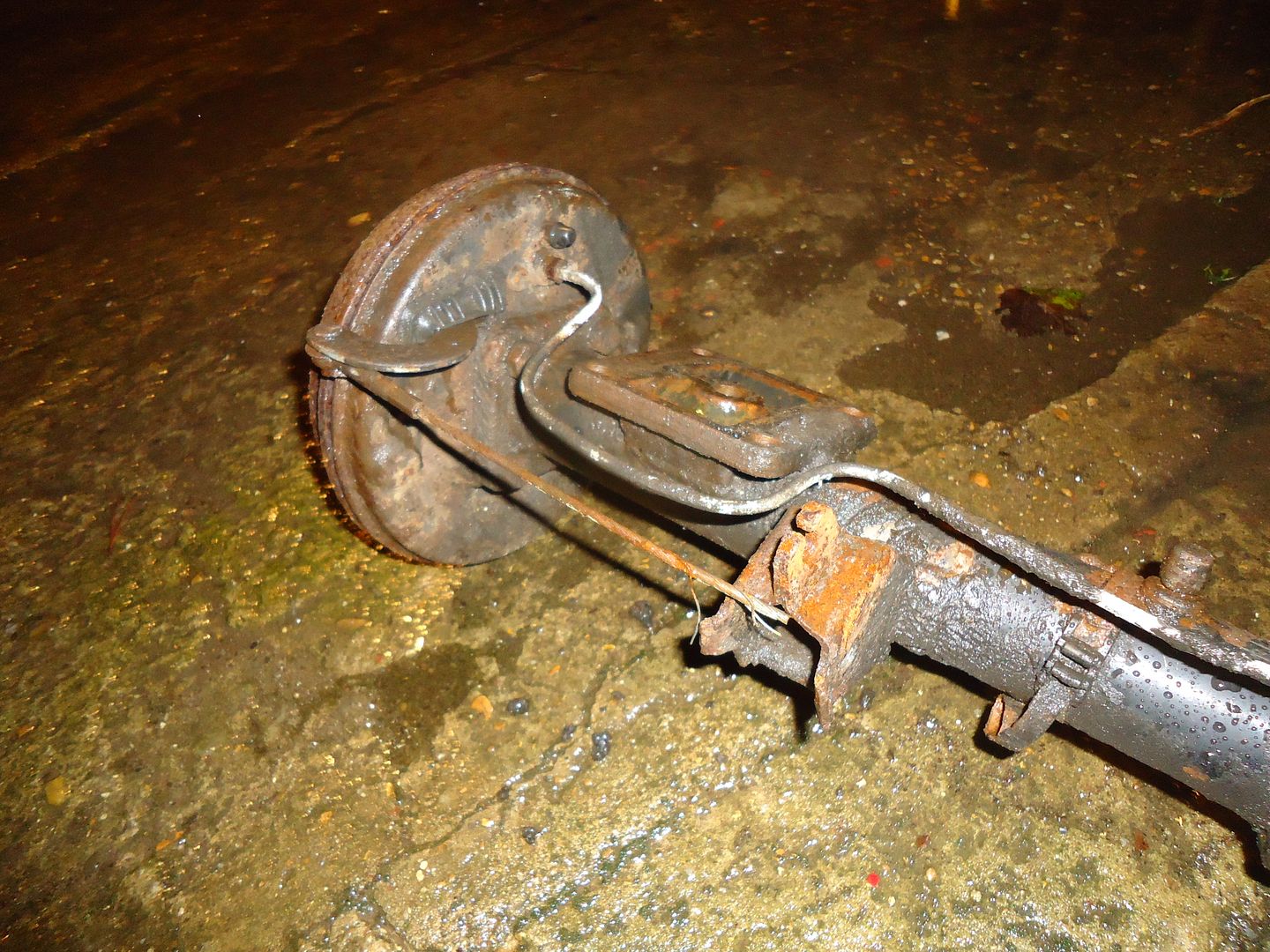

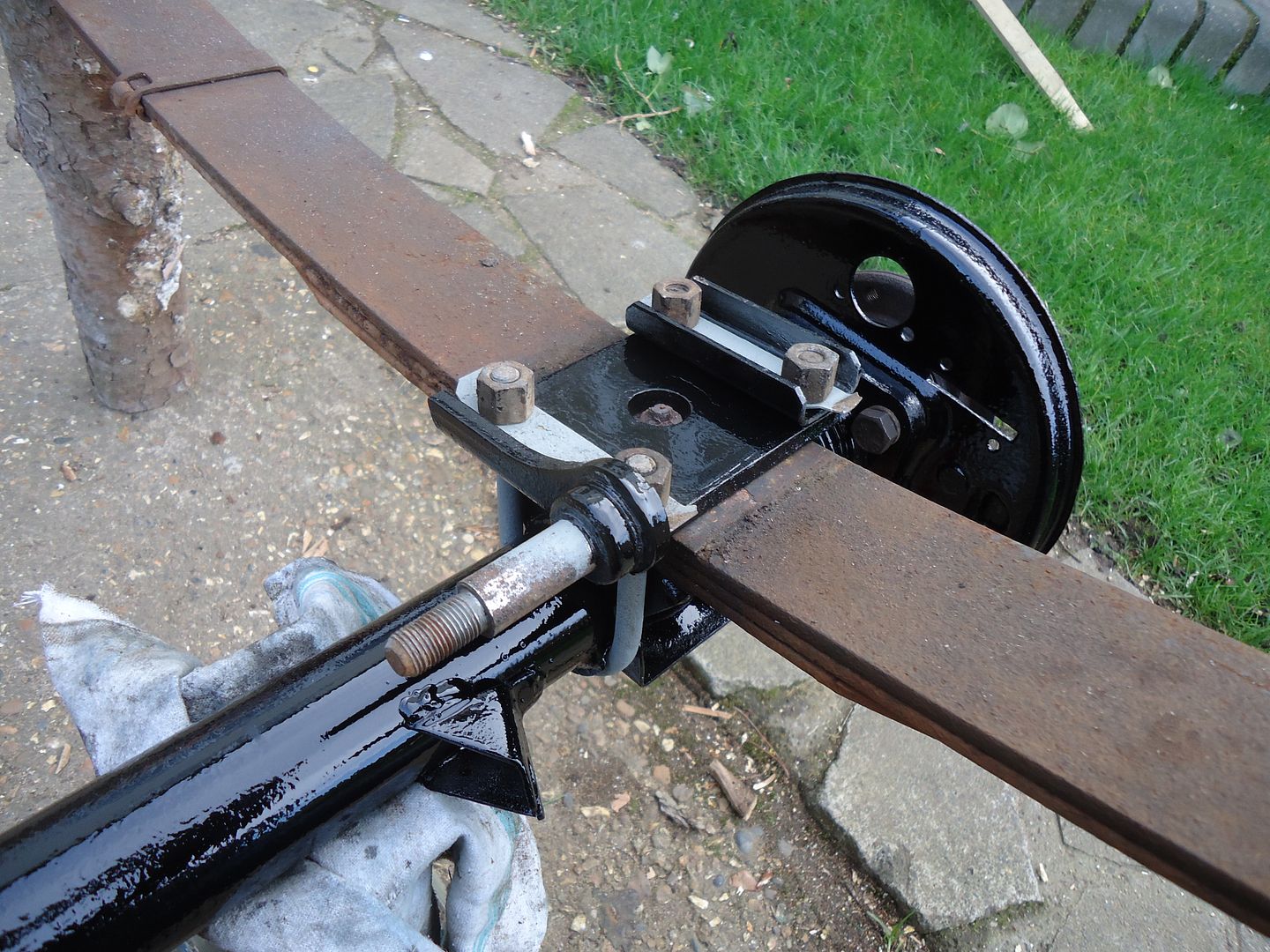

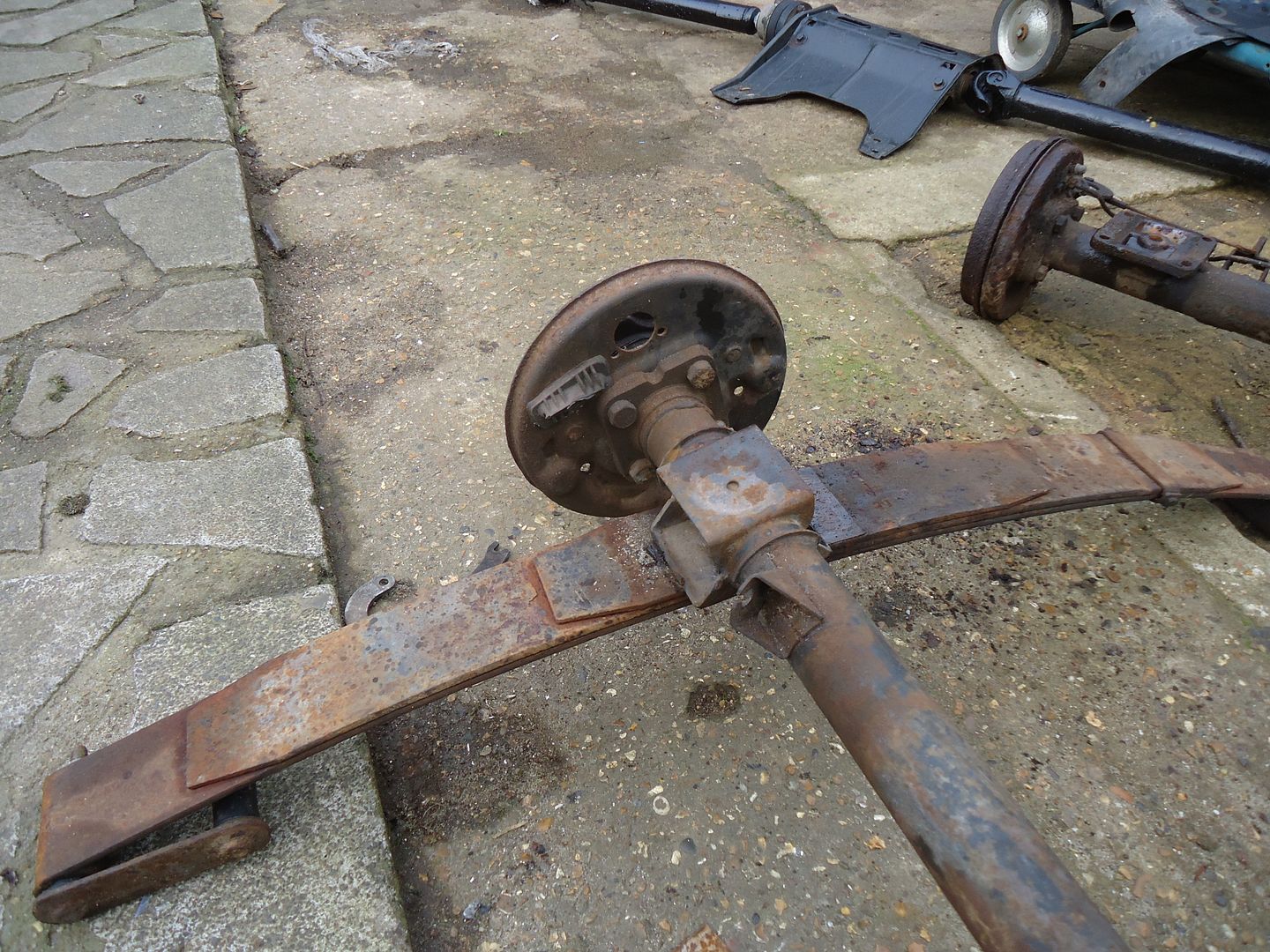

The main difference on the rear springs is that 4x2 Pandas have the axle on top of the spring and (as well as the 4x4 springs having extra leafs) 4x4's sit under. Thus it raises the back end by the thickness of the rear axle tube.
I reckoned that if I just fitted the new rear springs then I could refit the original axle...... But the I'd have to have it upside down so that it fitted to the 'other' side of the springs.and then the wheel cylinders and handbrake would be at the bottom not the top of the brakeplate and not be so efficient.
"Of course" Why didn't I think of it sooner. Just swop the brakeplate from one side to the other and all is restored to normal.. Ha...!
"Oh hang on" then the handbrake cable retainer would be on the wrong side. "Hmm"
"I'll cut then off and re weld them" Simples.. Well no actually...
If I had just mounted the retainer exactly opposite the original the parking brake cable wanted to pass through the leaf spring.
"Why not just do what Fiat did on the 4x4 axle"?
Because of this; the damper mount is quite different and too complex for me to be arsed to make in a hurry.
So a little experimental alignment was called for
Fortunately I had a spare 4x2 axle tube to play with.
What I thought would take a day, including the weather and other distractions, has been about two weeks.
This is where we are now..

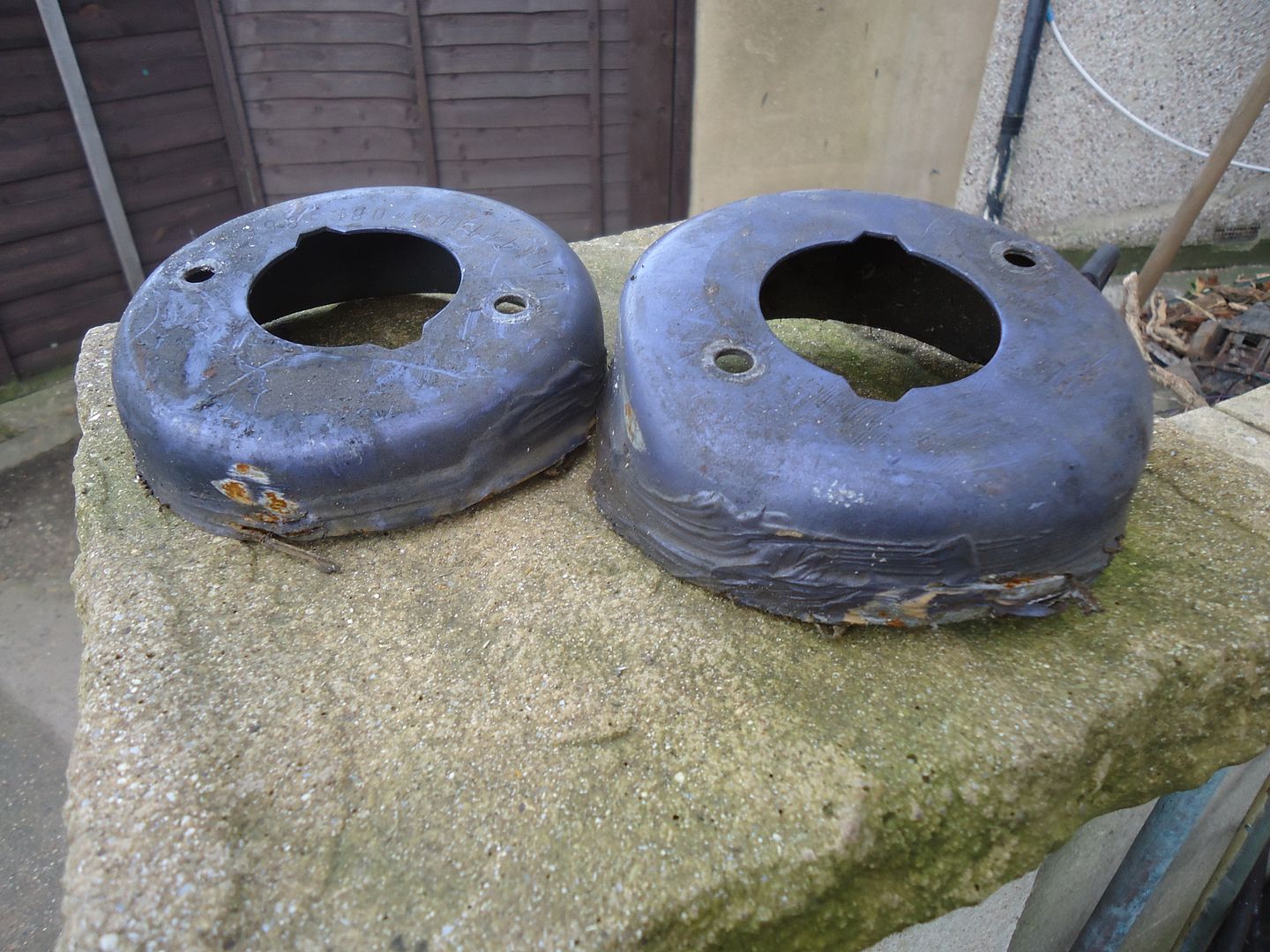

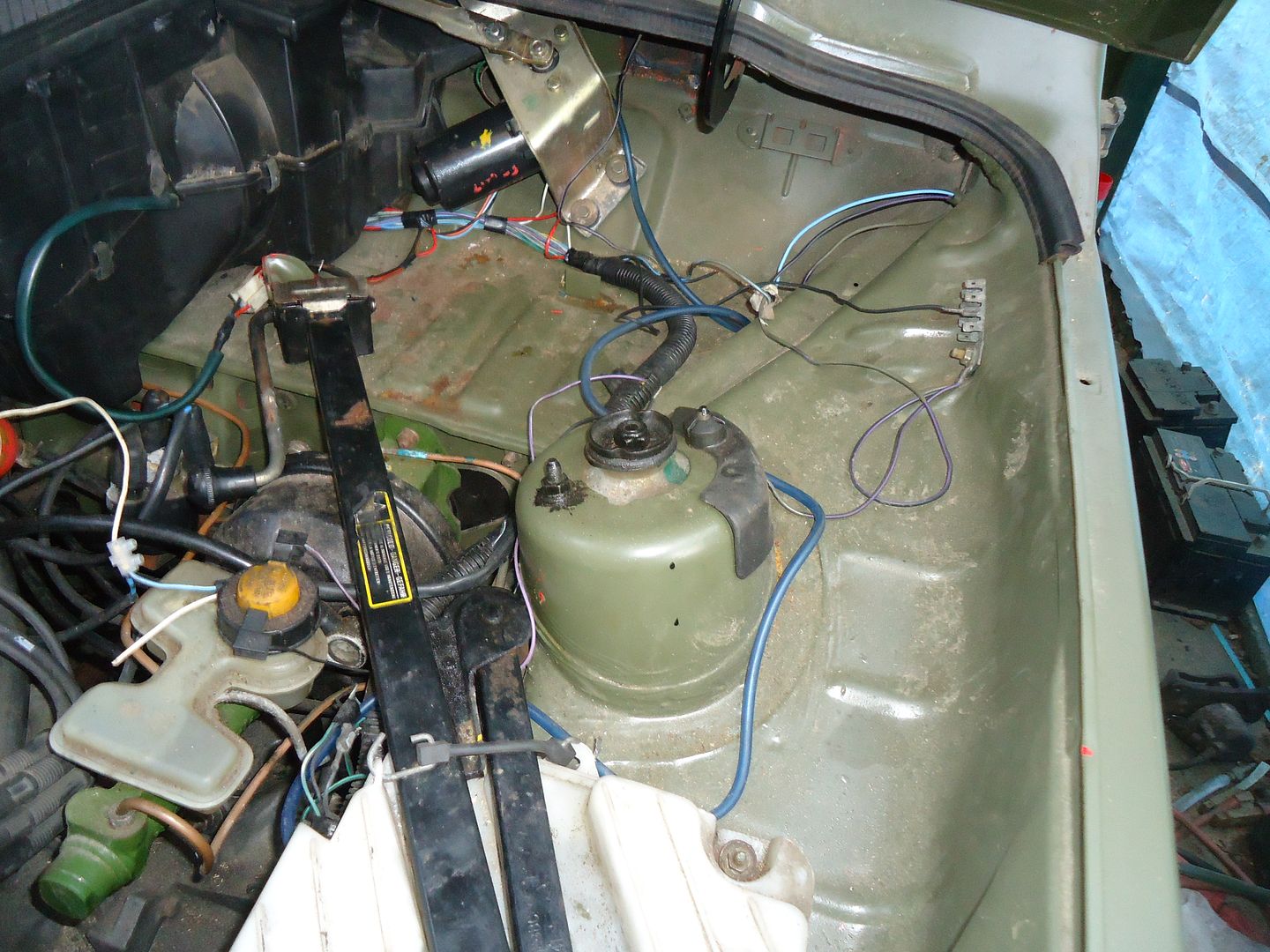

Ok;this is a pic of a std panda front suspension top mount.

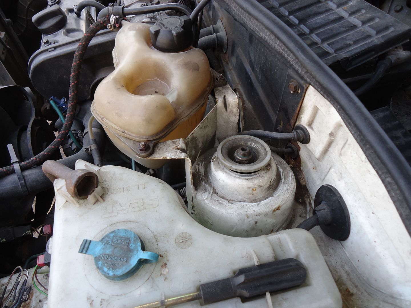

And this is a SEAT Terra diesel turret.
Spot the difference..?
I have 3 options. When I find out how the SEAT legs come off.
1: I may be able to bastardise the front legs, (using SEAT top bearings) to make them fit
2: I may be able to drill two holes for the Fiat tops. The wider section which would take this option is much lower than Panda turrets; so I would either get massive lift using 4x4 legs or normal lift by fitting standard Panda legs.
3: Purple Ronnie donated these:-(y)
they come off easy.. hex key in the centre and undo the nut.
as i said in my previous post a page back, they are the same as marbella struts. check the last few posts a page back.. bartpanda has a very nice picture :D
out of all your suggestions.. hmm i guess 3 would be the more easy to mod. should not be to hard to cut the old tops out and weld the new ones in.. and your welding is quite neat. shame about the paint though :/

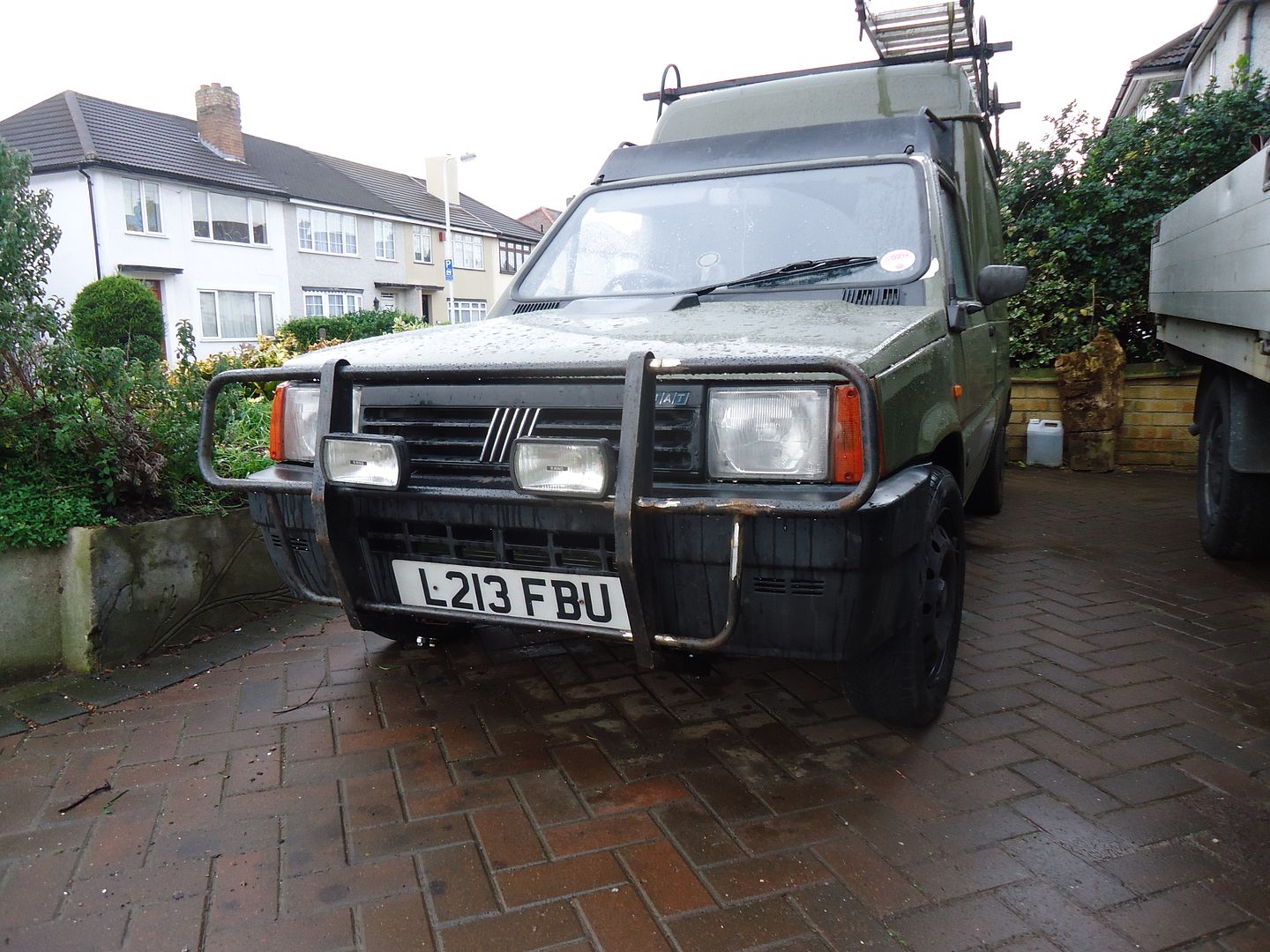

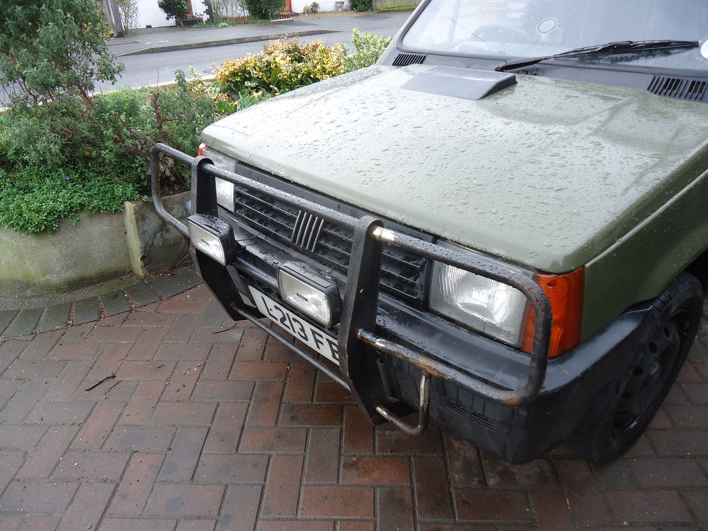

If you've noticed on my other Terra thread I've made up a few pairs of front tie rod to body mounts with the 4x4 sump plate and Roo bar mountings.
I got a chance last night while it was still daylight and dry to fit the mounts. That was about 5 O'clock.
I knew there must be some reason that I got the Bullbar so cheap.
By 9 O'clock I had cut shut and rewelded the bar so that it not only bolted on but didn't touch the bodywork.
It came from a car that had been hit quite hard in one front corner. Very strong those Bullbars. You can't just bend them straight as I had foolishly assumed.
I had also managed to made both 'tie rod mounts' right handed, so there will follow a "How to get out of jail free" to sort that out.

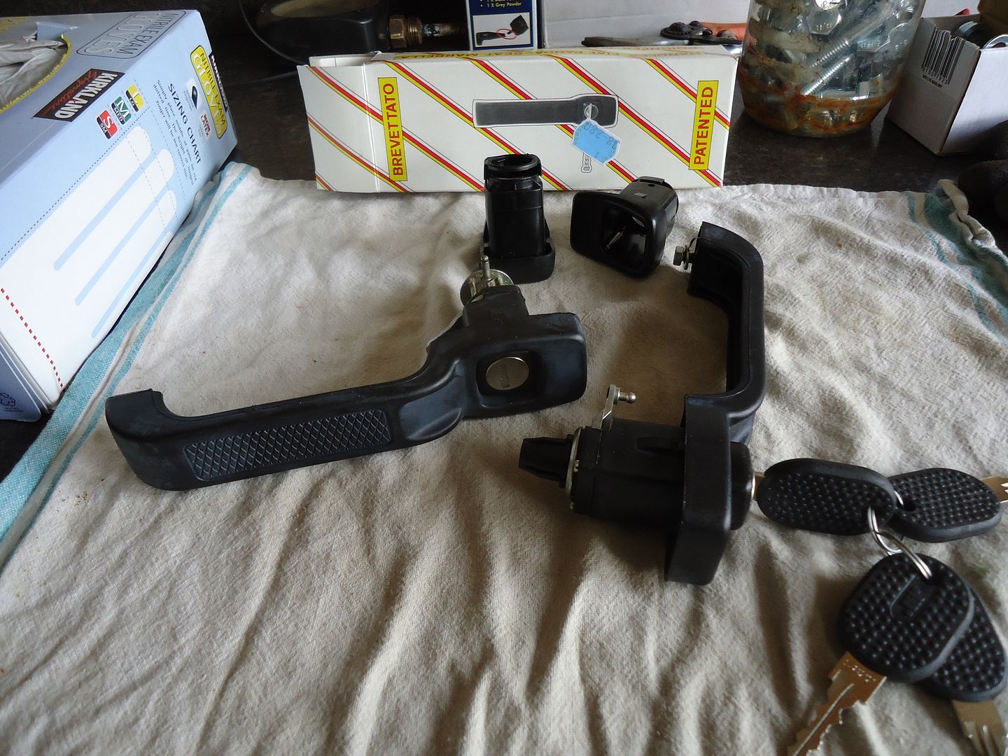

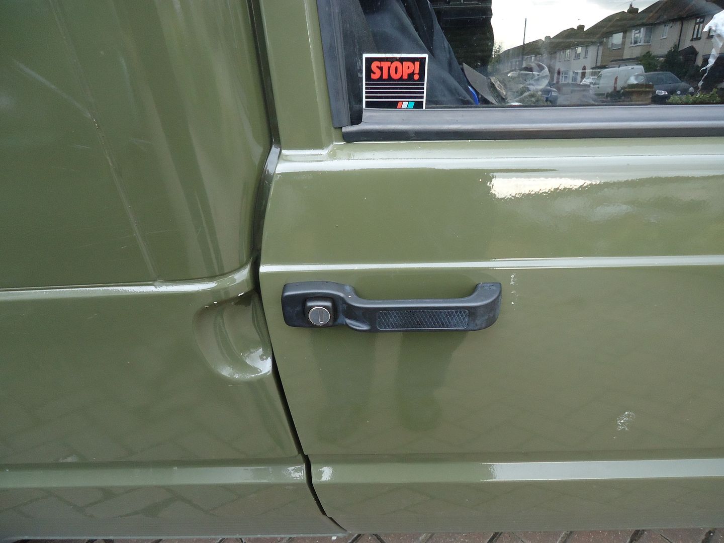

It may not be obvious until I mention my lurverly door handles. Yep another pair off Italian Ebay bought and delivered for the princely sum of 23 Euros which to you and me is 19 quid in real money. Thank heaven for Google translate and honest Ebayers. Oh yep and our chum Aquamarine for finding me a brand new pair of front door locks.#

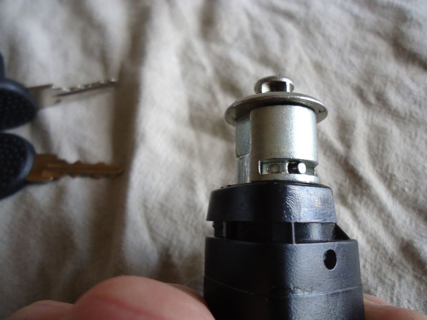

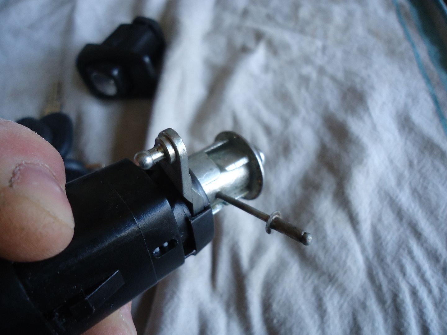

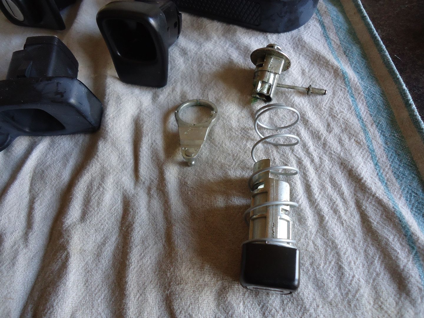

Which I imediately took apart and lost the (vital) pin into 10 years of crap on my shed floor. Yes I did try a magnet but as my favorite tools are grinders, the floor is an inch deep in filings. So I had to sacrifice another (ex-decent) lock for it's pin.
You can see where it fits here in the slot
And you knock/push it out through the little hole opposite
Sometimes the pin comes out a lot easier than you might expect.!!!!!!!!!!!!
It would seem that the later the model then the bigger the hole to punch the pin out. For early ones you have to use a small drill bit.
If (as in this case) you want to fit these handle to a MK1 or a SEAT the you will need Fiat MK2 locks cos they are different.

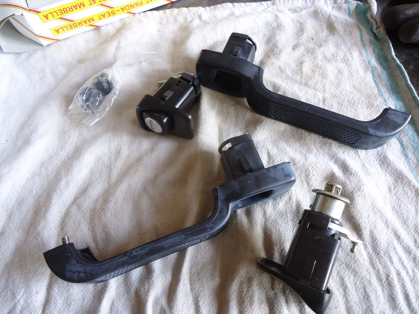

Yes this is my kitchen worktop
Because the handle mounts a little further out than originally there are these plastic extention bits which clip onto the actuating pin.
Of course you can only fit these extensions after the handles are fitted to the door and you naturally drop them (Turning a five minute job into a 30 minute one)and then have to take the door off and shake them out, cut your hand, bleed all over the door, chip the paint and misalign the door on remounting. (You get the picture)
On the side of the box that the handles arrive in, there is a perforated pop out section which becomes a template to drill the 8mm hole which the front of the handle bolts through. Job done.

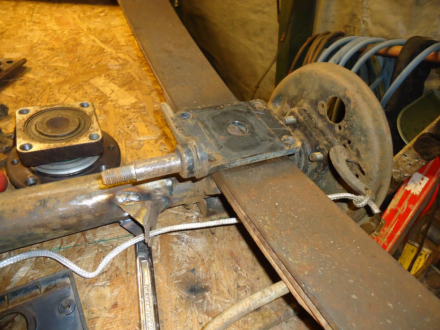

OK so the 'WAS' the plan. 4x4 rear springs; rear axle turned upside down and fitted under the spring rather than over it.
As you may recall this did involve changing the position of the handbrake anchor points but hey; how hard can that be.
To save time I had a MK1 axle knocking about from the 'Neglected Green One' so I converted that. Makes sense Huh.? (wrong wrong wrong)

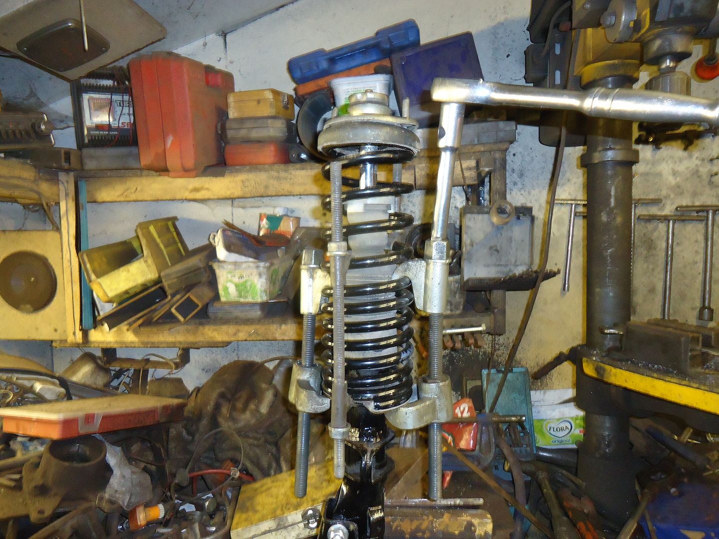

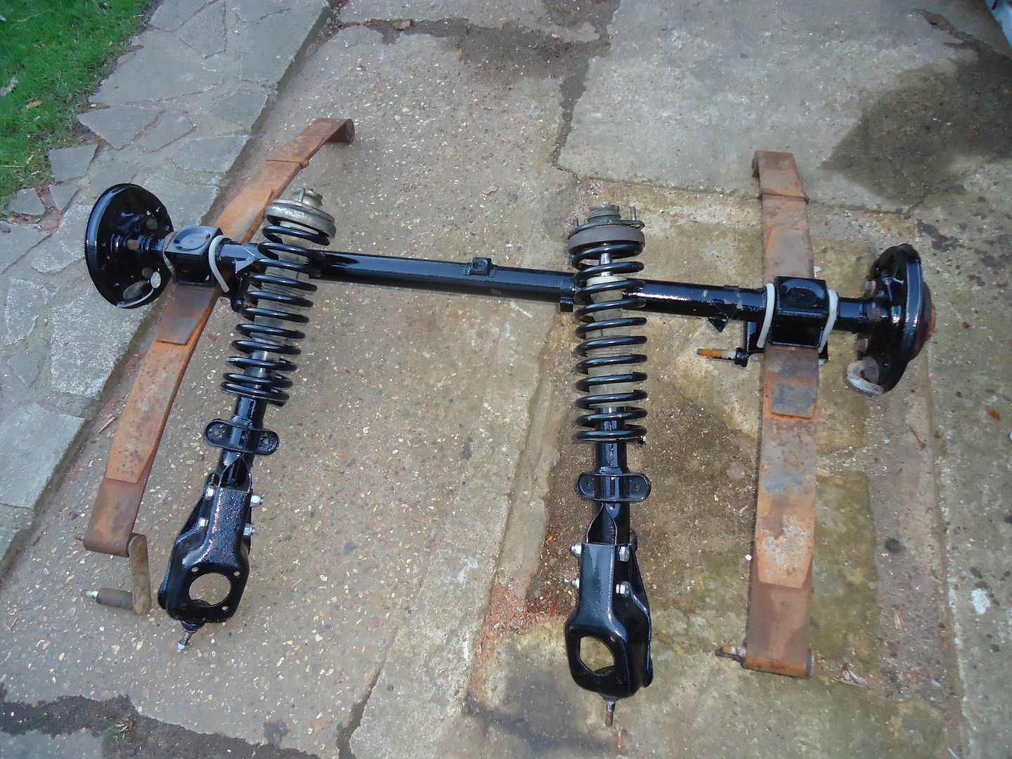

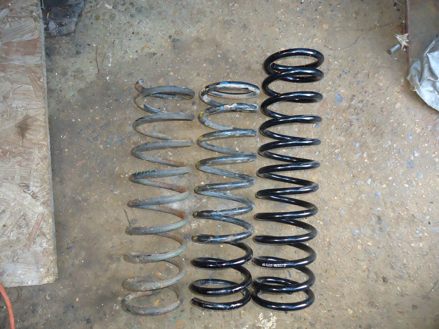

All bolted together and took the plunge and bought brand new Skoda Felicia springs for the front struts (£60 delivered) and endured the heartstopping event of fitting them. I can't explain why changing coil springs always scares me but winding springs down by five or six inches is a great way of creating a weapon of mass destruction if anything slips.
These bug*ers were so long that I actually used two sets of compressors to keep everything straight and vertical. (Long springs have a habit of bulging and trying to slip their restraint.) But they went on OK.
This is a Skoda spring next to a std 2wd pPanda item
And this is the same, wound up to fit, next to a standard 2wd one.
Notice I put the strut in a bench vice....... The theory is that if anything goes wrong then it will just take out the shed roof and miss me.
Scared...? Not me mister..... Eek pass the cheese.....:eek:
