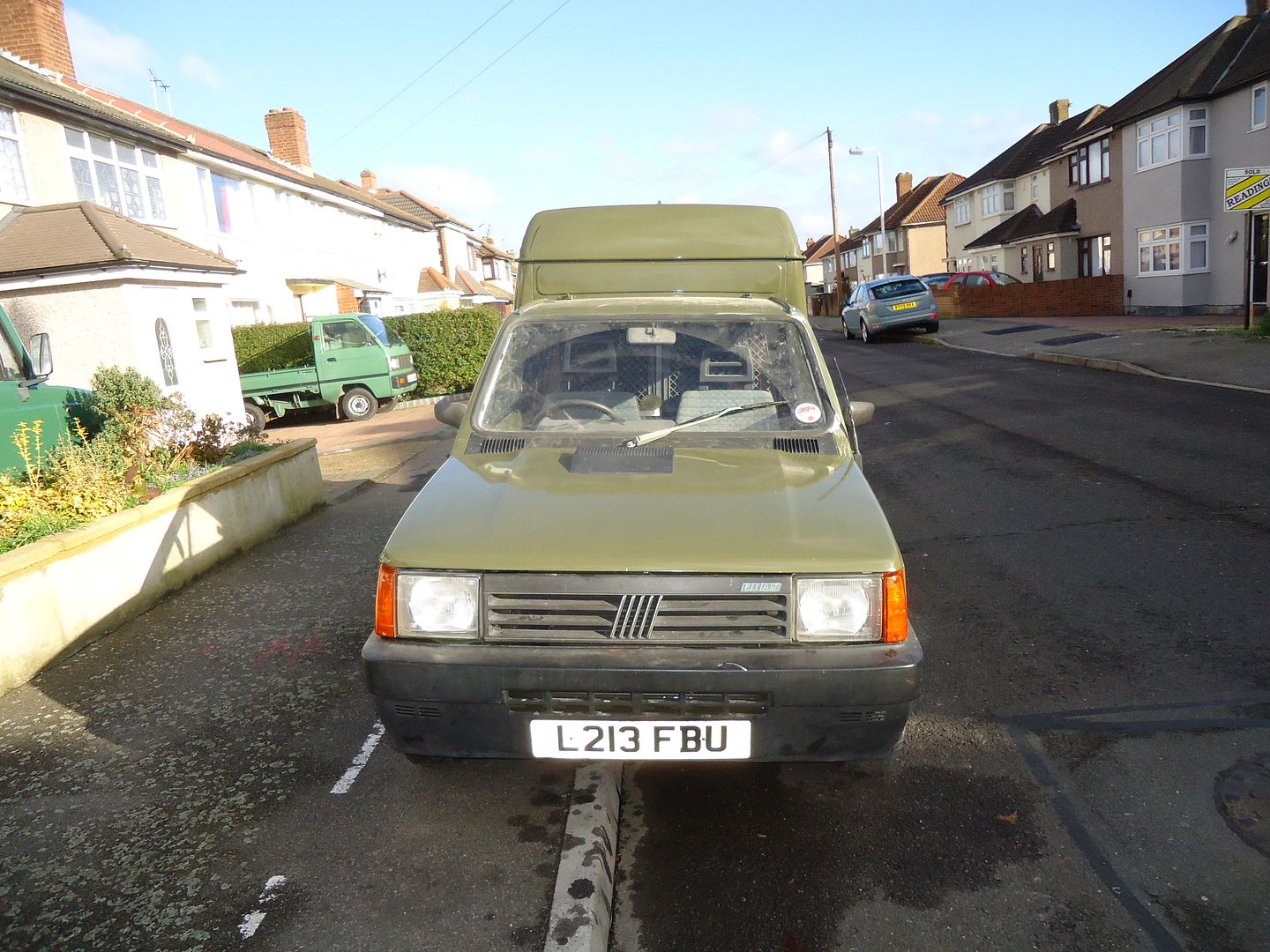

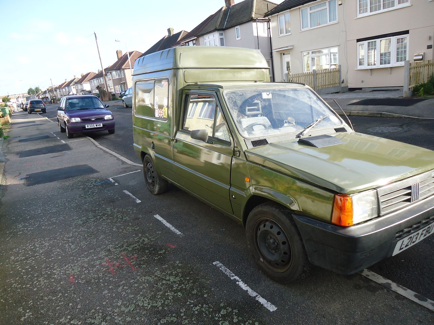

I've been have a few issues rebuilding the van. Nothing insurmountable but irritating none-the-less.
I'm fitting Fiat MK1 doors as the originals required repair, stripping down etc etc. I mentioned before that SEAT weld the top hinge on the door. That wasn't a problem. I have an unwilling donor.!

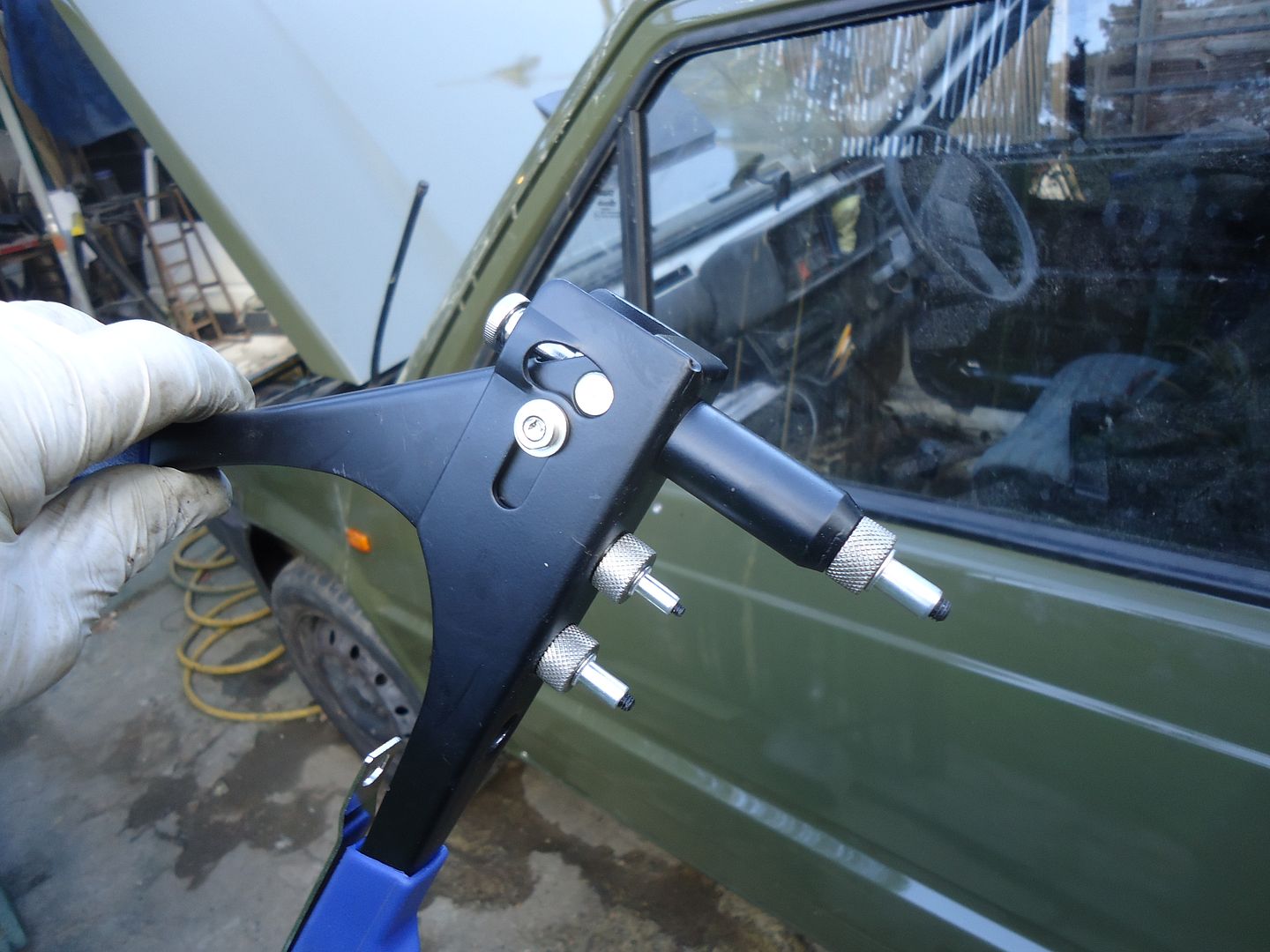

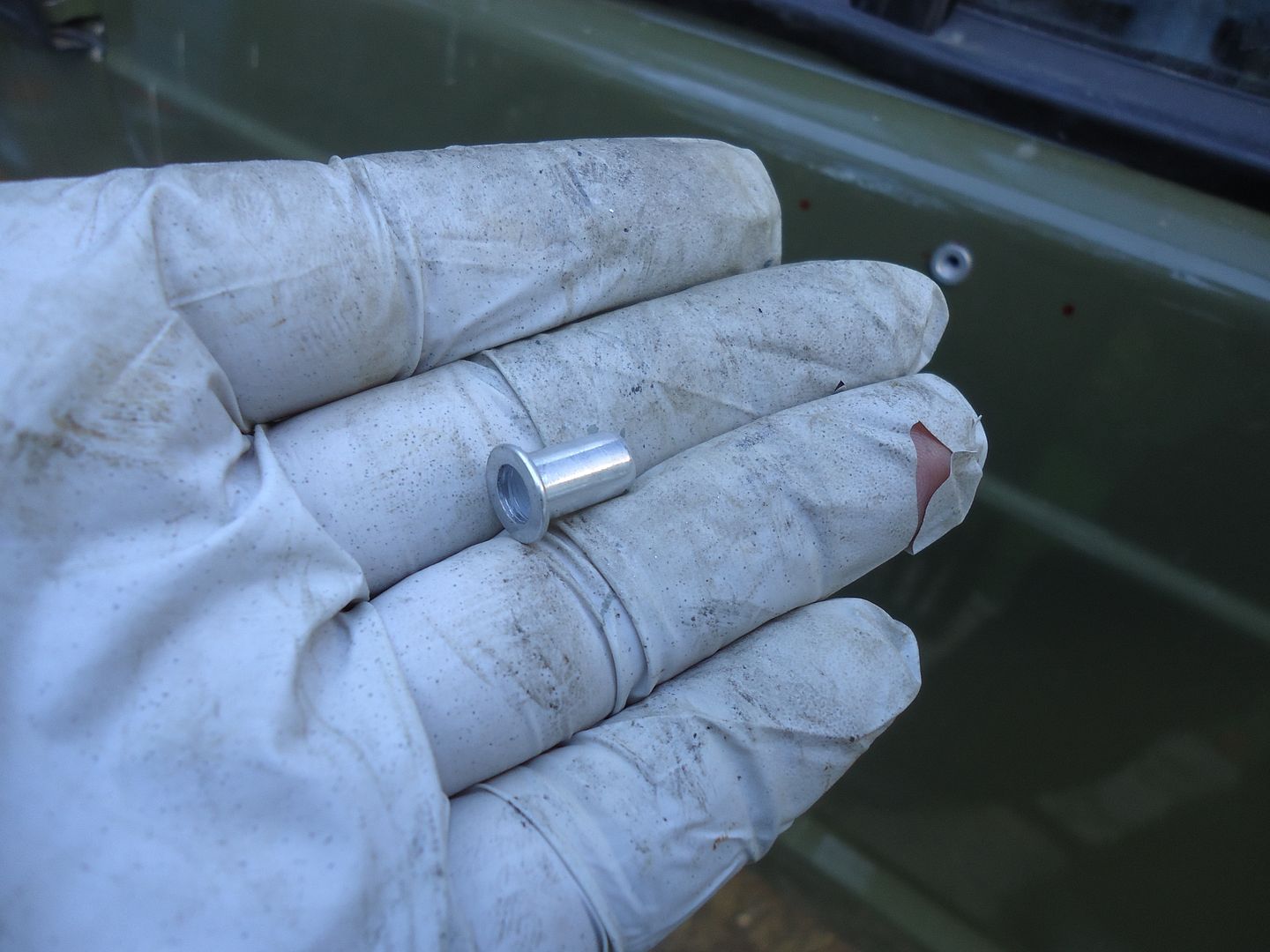

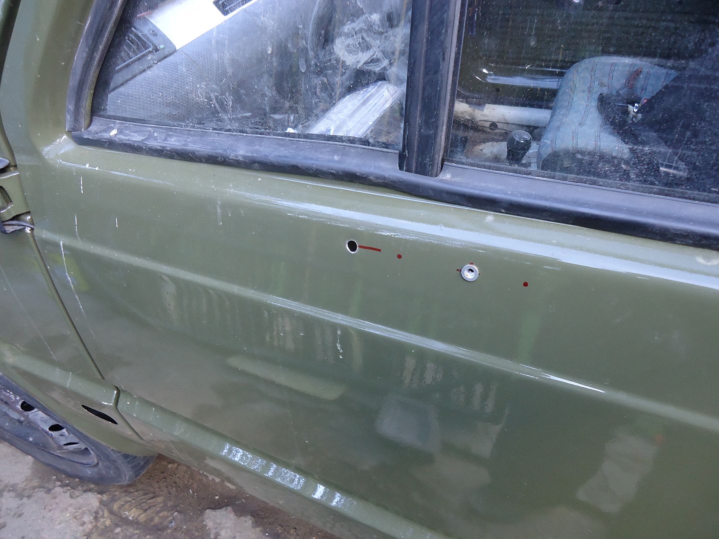

If you have never come across 'Rivnuts' then you are missing out.
My NOS MK1 doors came without mirror mounts so I had to drill new holes.
Rivnuts fit the same way as pop rivits yet insert a thread and all from one side.
Then you can bolt/screw and get a good solid fix.
Just be careful not to 'over squeze) the pliers and rip the threads out of the insert(y)

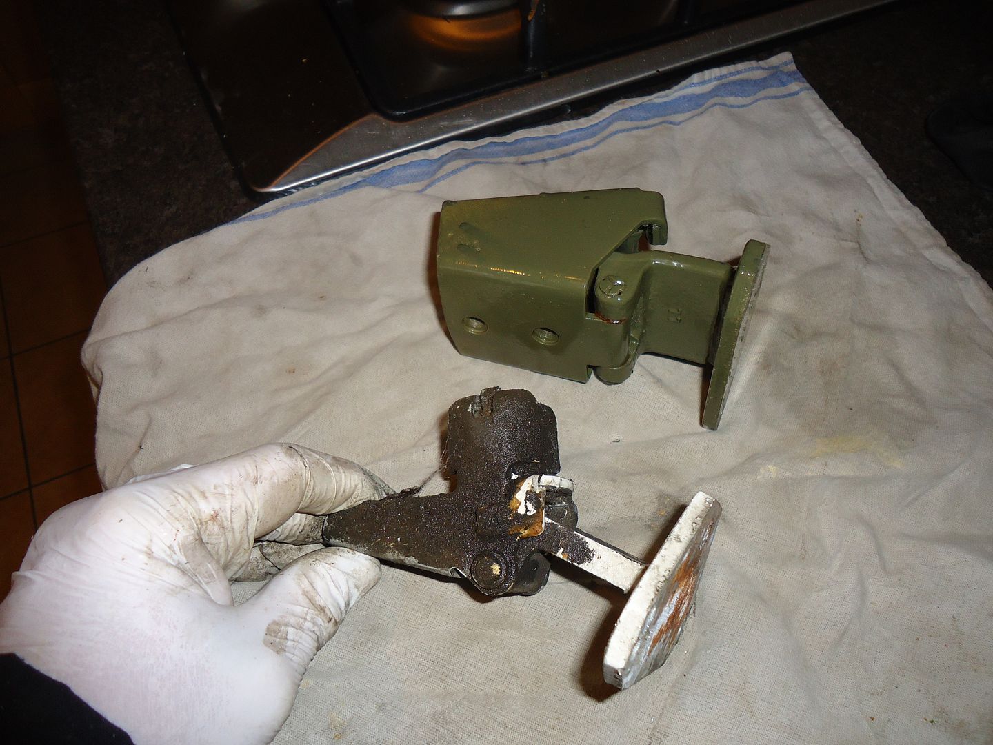

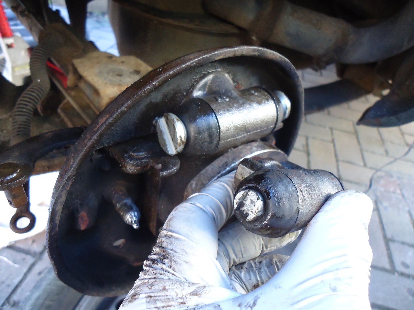

I've been collecting a few Ebay bits. All comes to those who are patient. I got two rear wheel cylinders for about £12. And a handbrake cable for about £8 or something daft, it might have been less.
I had already fitted a pair of new 'Panda' cylinders but as you can seat the SEAT Terra items have a bigger bore and larger faces. And they were designed for the job of course.
I had some brand new rear shoes in stock so the brakes had something of a birthday.
It isn't worth poncing about with old handbrake cables these days when new ones are so cheap. This old one was sticking badly. Now it's beautiful.

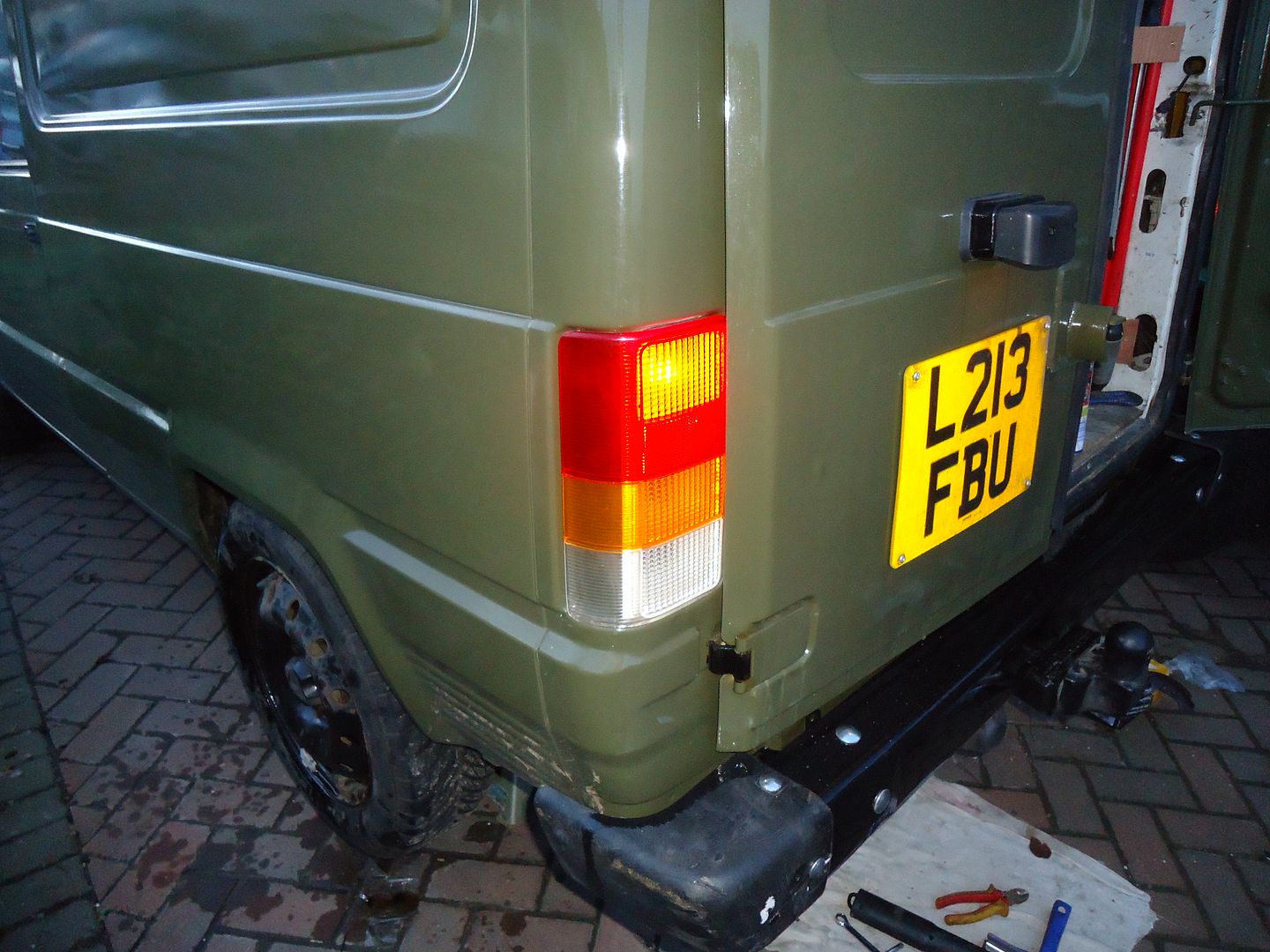

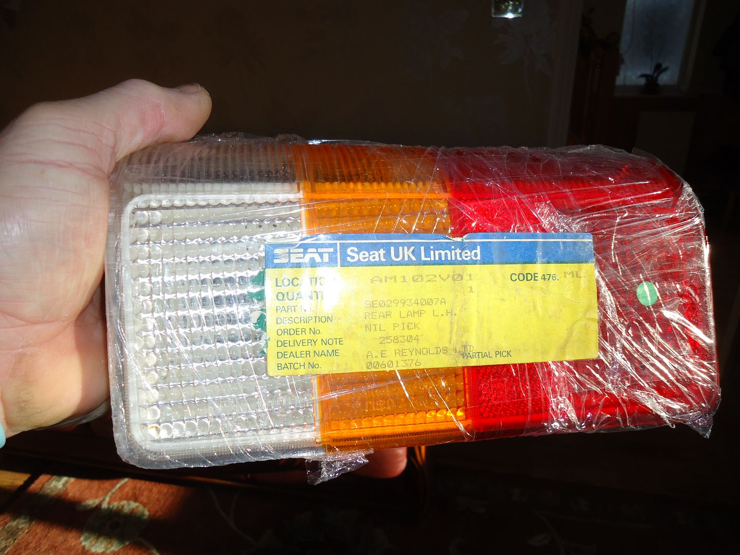

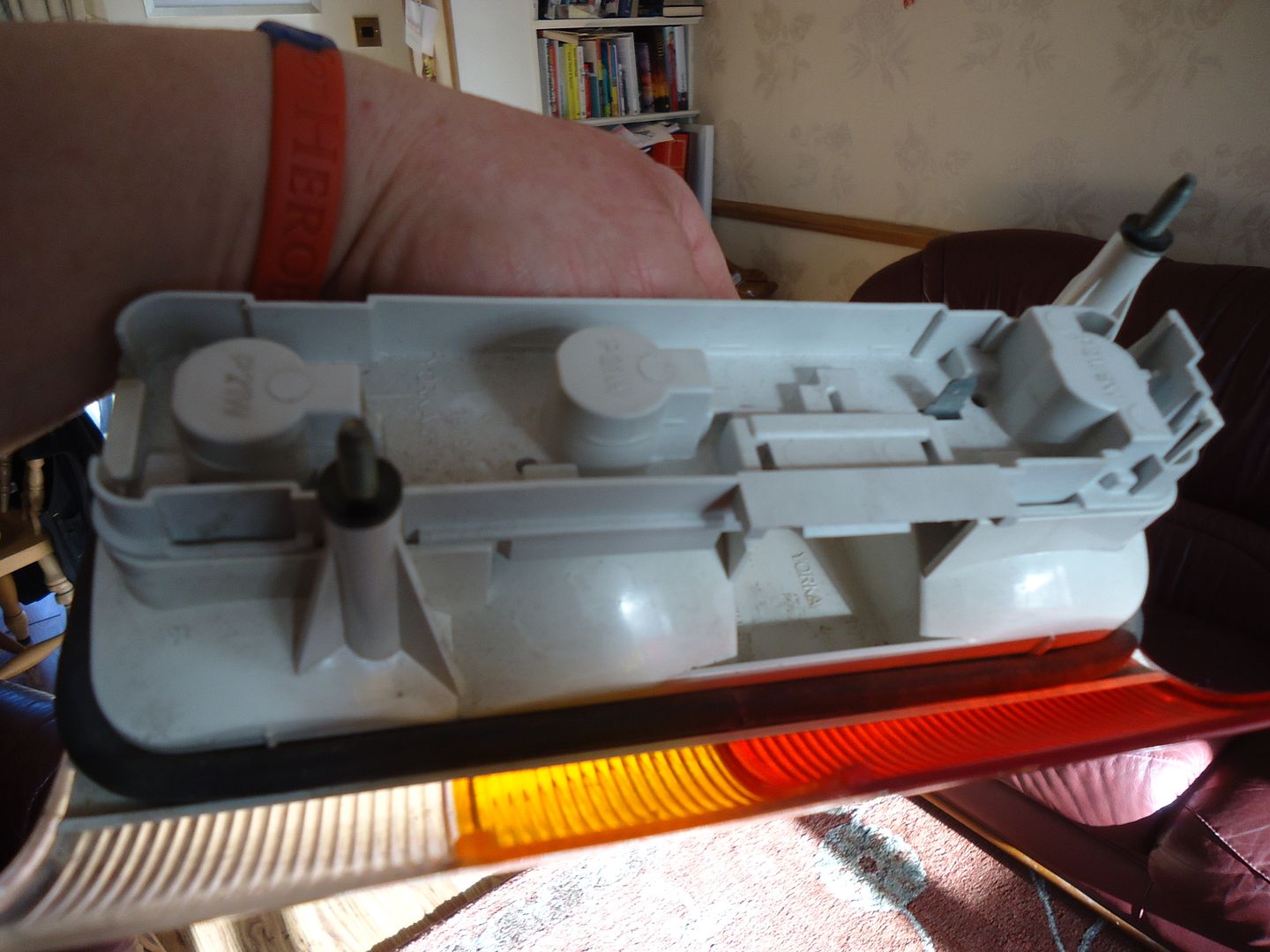

My current favorite find was a brand new old stock rear light lens. It was quite expensive but I really never thought I'd find one so easily; and it was the side I really needed.
I think that I have mentioned before that these items mount quite differently to the car variants with two pins coming straight out of the back of the unit.
I also took the opportunity to refit the repainted rear bumper before I managed to knock it down from where it has been hanging for a month.
So new light, repaired and painted bumper, new hanbrake cable, wheel cyls and shoes. Haven't I been a good boy.
