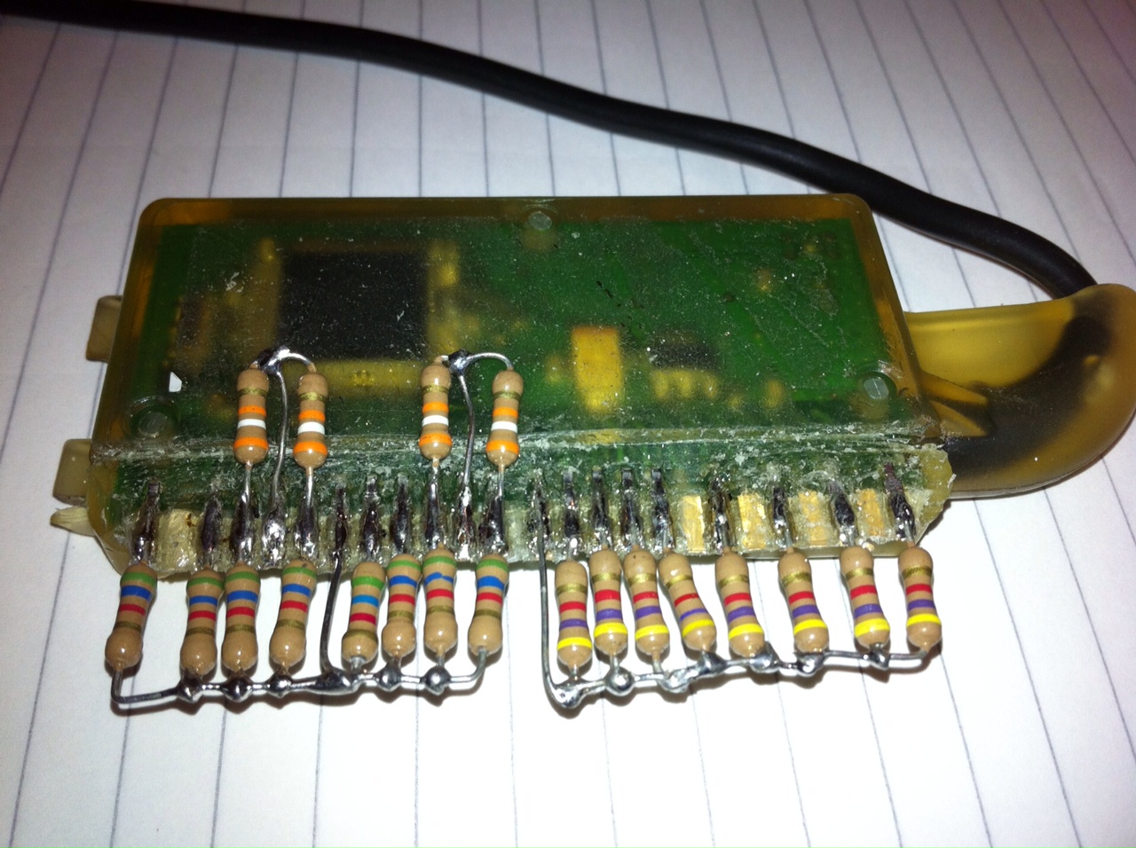

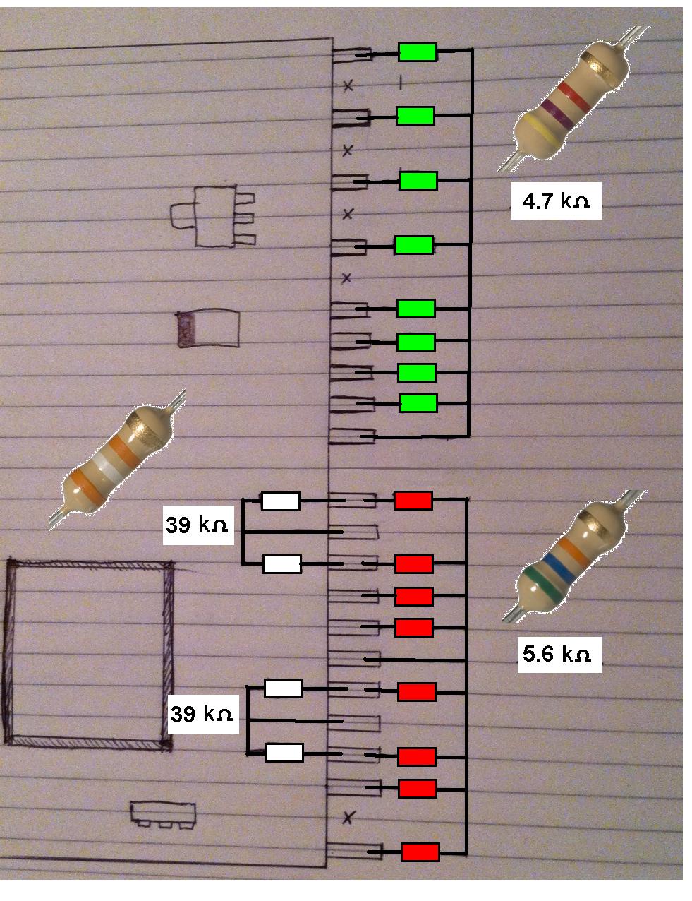

If you (or someone you know) are prepared to spend some time removing the sensor from the seat in question, and have the skill (believe me, it IS a skill) and ability to solder 20 resistors onto it, then you might have a chance to clear that issue.
Stilo Abarth 2.4 Selespeed owner for over 6 years, I have had this issue on and off since I bought it. Finally took some advise from this forum (after trying all the easier suggestions first of course) and had the sensor modded to simulate the seat always occupied (better than not occupied). Issue has gone!!!!!! :D
I have attached the details of components used. Hope this helps you and others.
