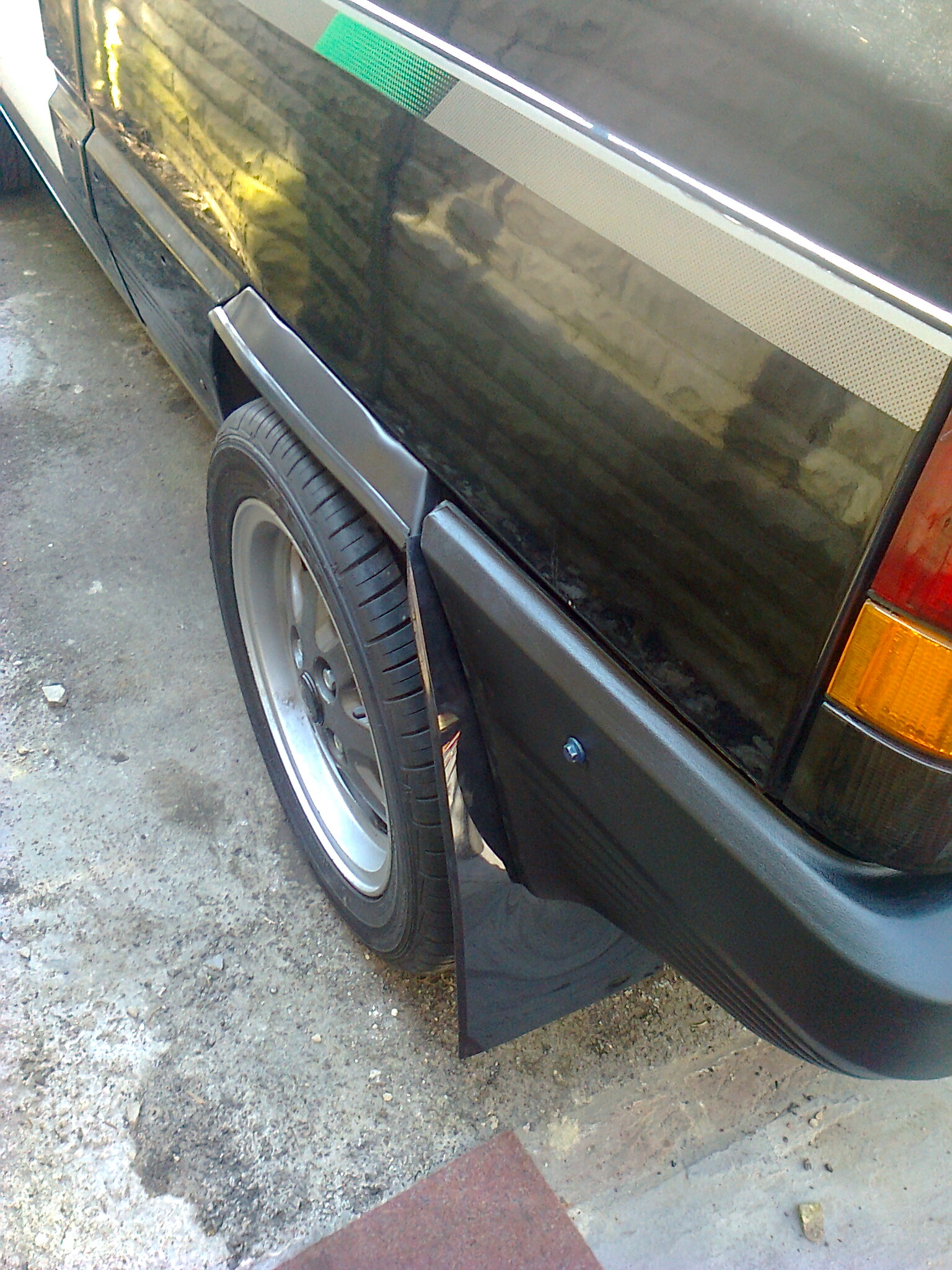

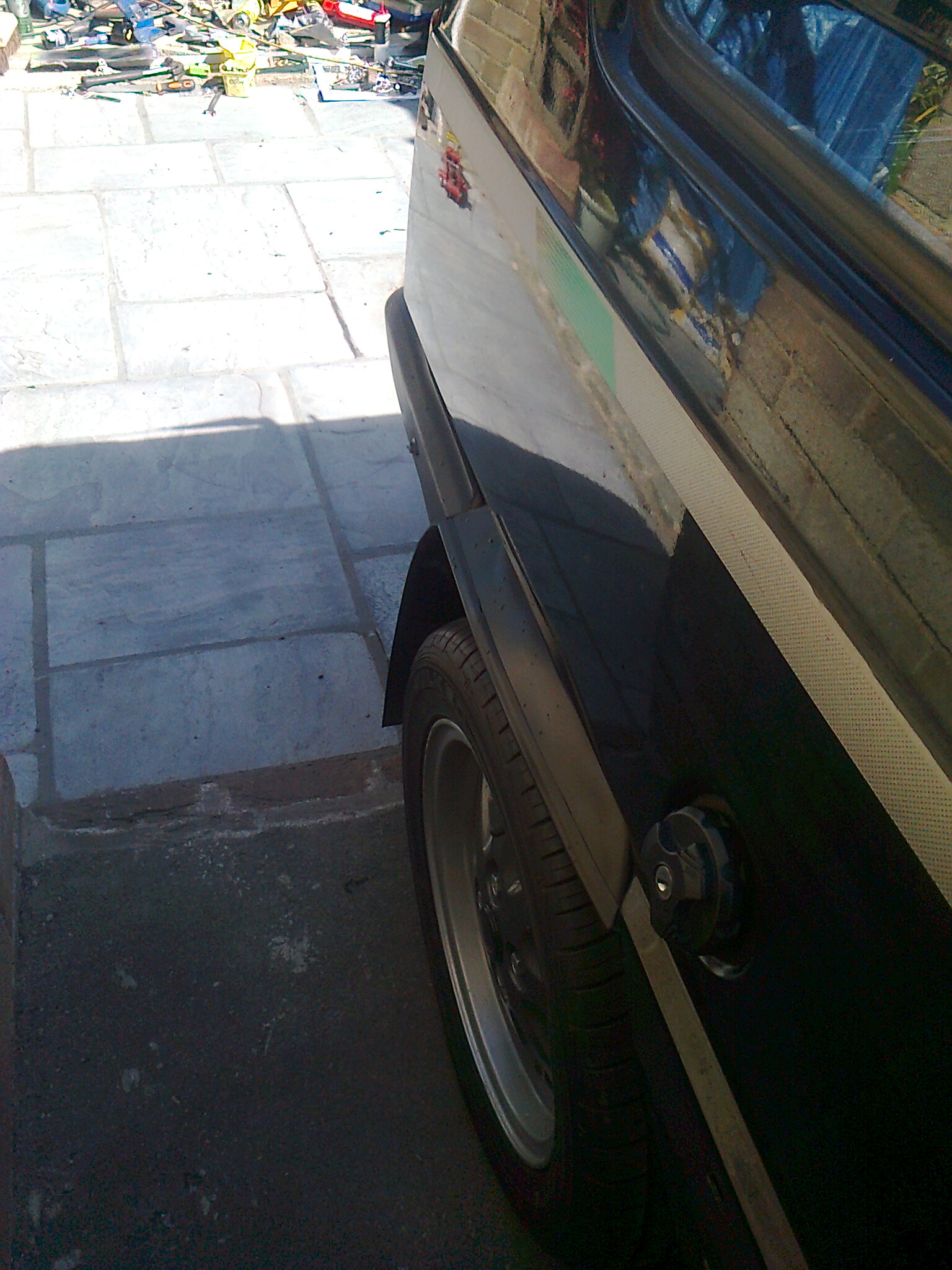

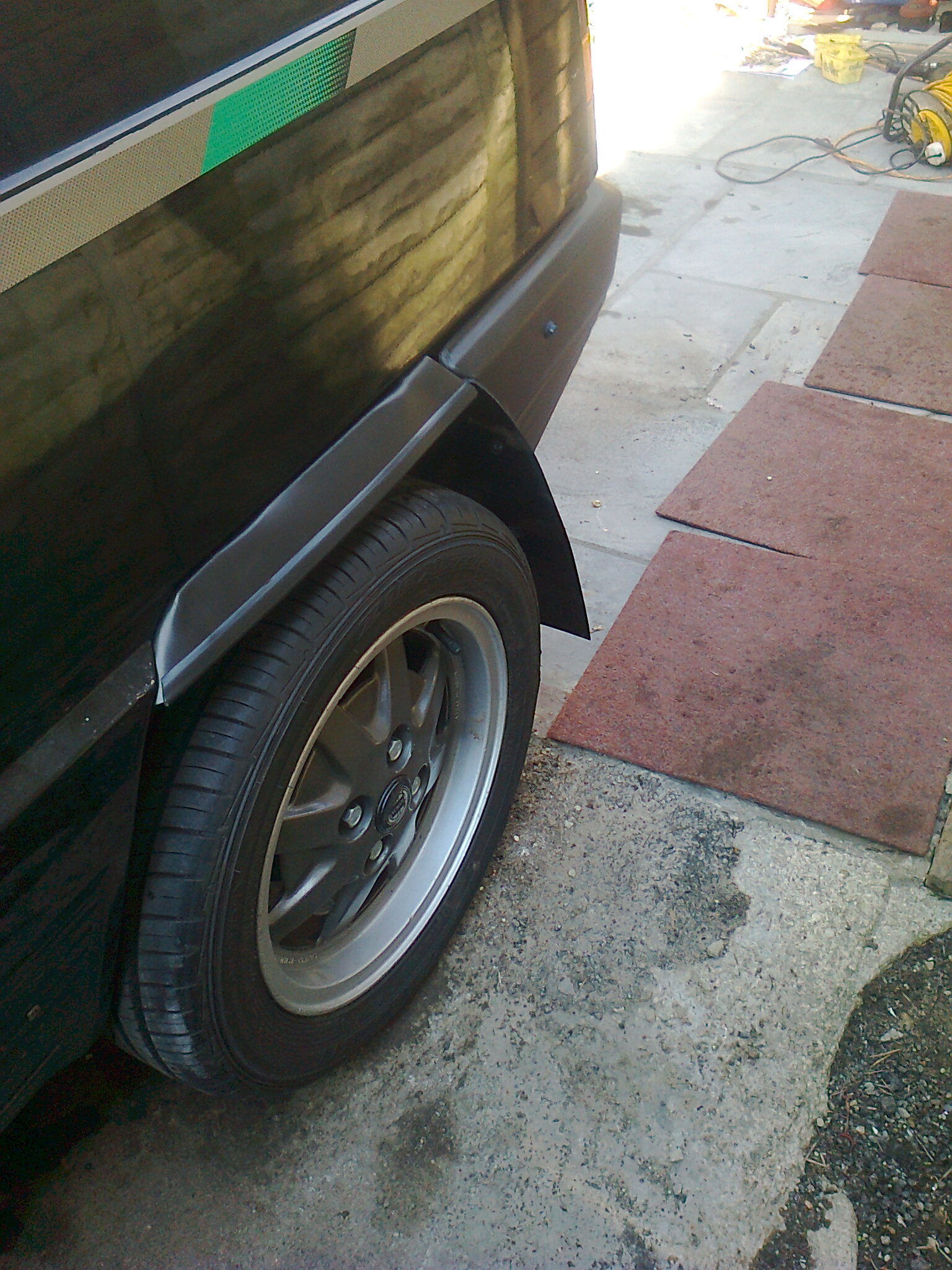

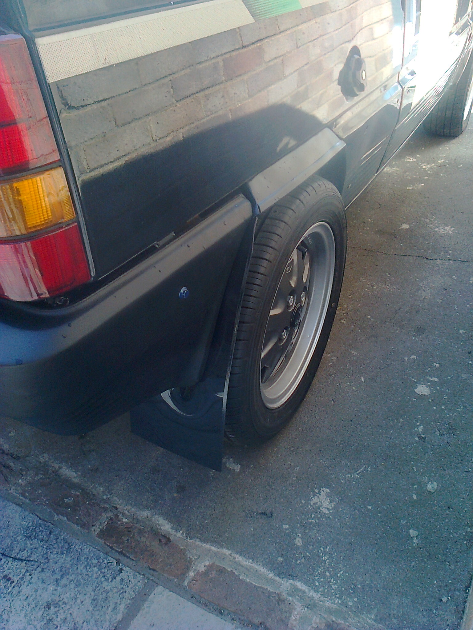

The arches were not acceptable so I've made my own which I will trial for a bit to see if they are up to the job!
I made a cardboard pattern for the top arch which I then cut out of some plastic sheet. I used a hot air gun soften the plastic and bent it onto shape using metal plates to keep straight lines. It fits on exactly how the original Marbella trim does so no extra drilling / rust seeds to sow :eek:
The Mudflaps were just a case of ordering some Rally style DIY mudflap sheets which I cut to size and screwed onto the bumper. Et Voila:
looking wide boi now "innit":cool:

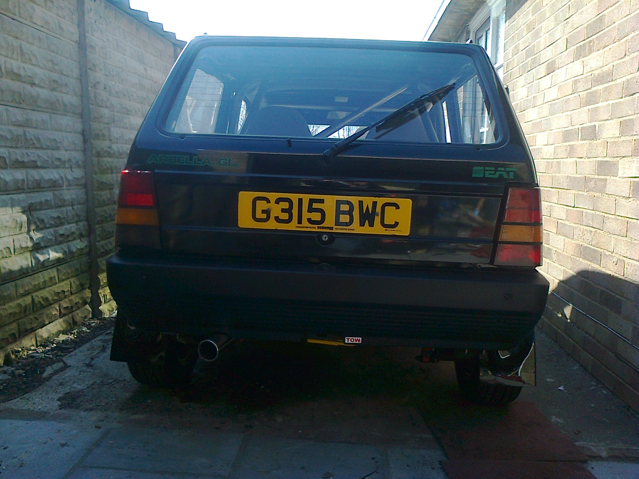

Oh and one more step closer to the Mk1 panda look if you haven't noticed already she's gotten a mk1 rear bumper now :slayer:
Looking nice and racey now :devil:
That Mk1 bumper is way better than the original, the ribbing carrying on into the bumpers makes it look better balanced. Would the front ones fit?
Yeah, the mk1 has a better overall shape too. It flares out at the wheel arches; also because the marbella has a deeper boot panel and tail lights, the bumper sticks out slightly less.
Can't really fit the front bumper though as the intercooler would not fit (unless I cut a massive hole in it :eek:). I like the front bumper though anyway, and with the golf front splitter I think it works quite well.

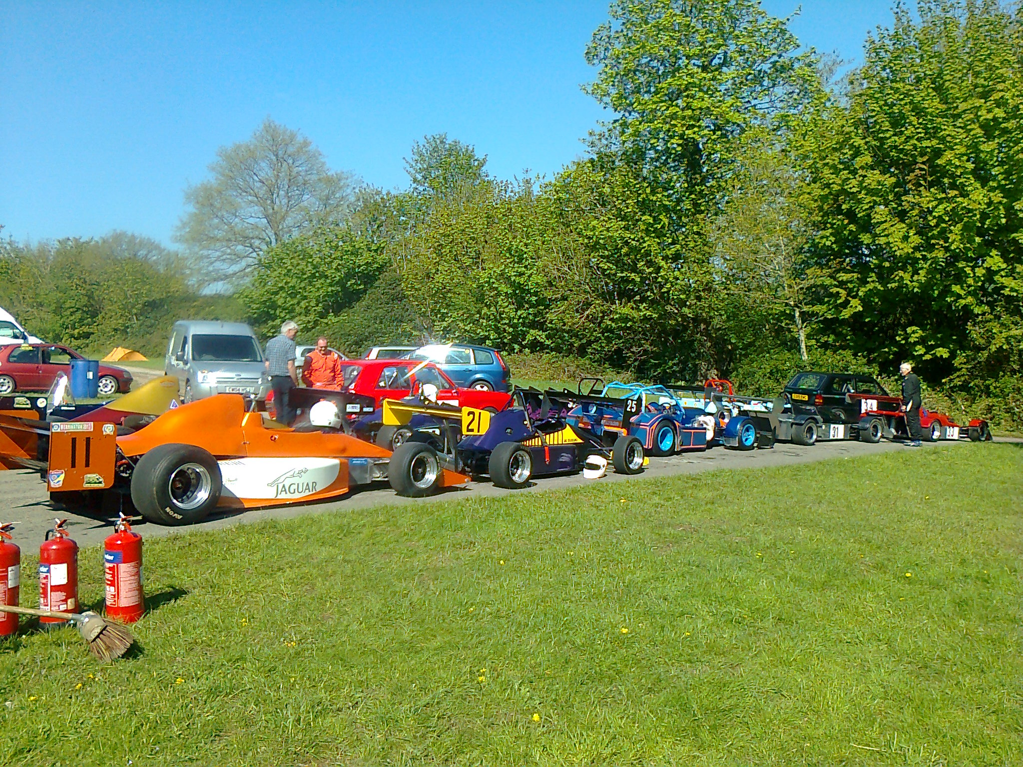

This is what I was up against in the Sports Libre Class up to 1,8litre (notice wee little Marbella sitting at the front :eek::
Amazingly I was just under 2 seconds slower than a car called a "Mallock 17B" which is the one that looks like this:
