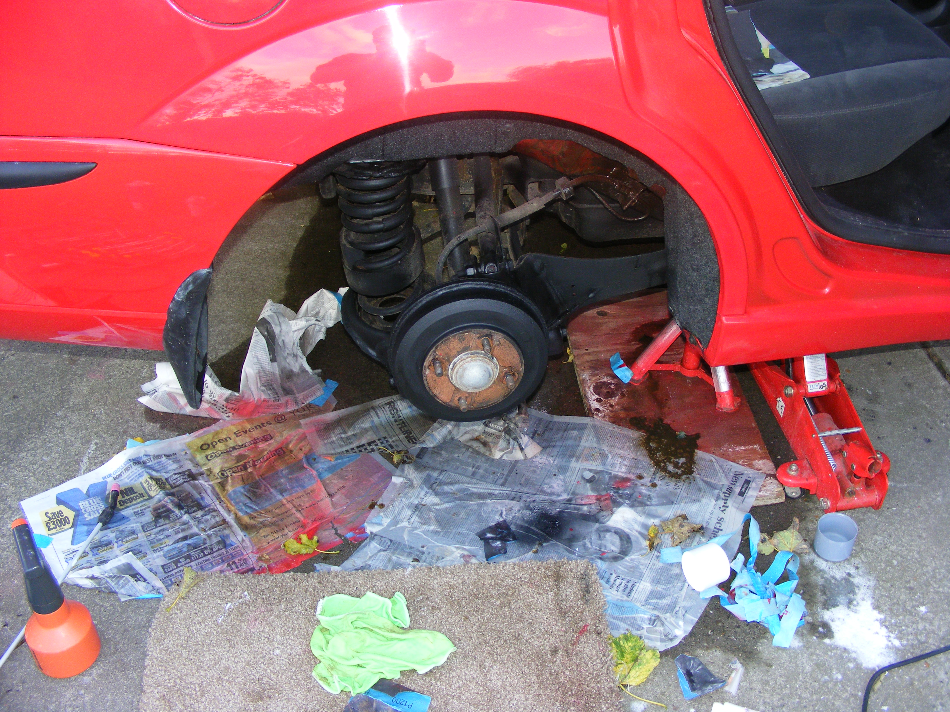

What i did with mine on the last GP
was clean the loose stuff off with a wire brush
then degrease and rinse well with water and dry......
and applied this stuff
http://www.bilthamber.com/hydrate-80
it goes on with a blue colour which goes black with a slight blue hue...
then once dry i misted it with some cheap black rattle can stove paint
http://www.toolbox.co.uk/everbuild-...n=GoogleBase&gclid=CJKix7S9zrsCFQMYwwodnRAA8Q
