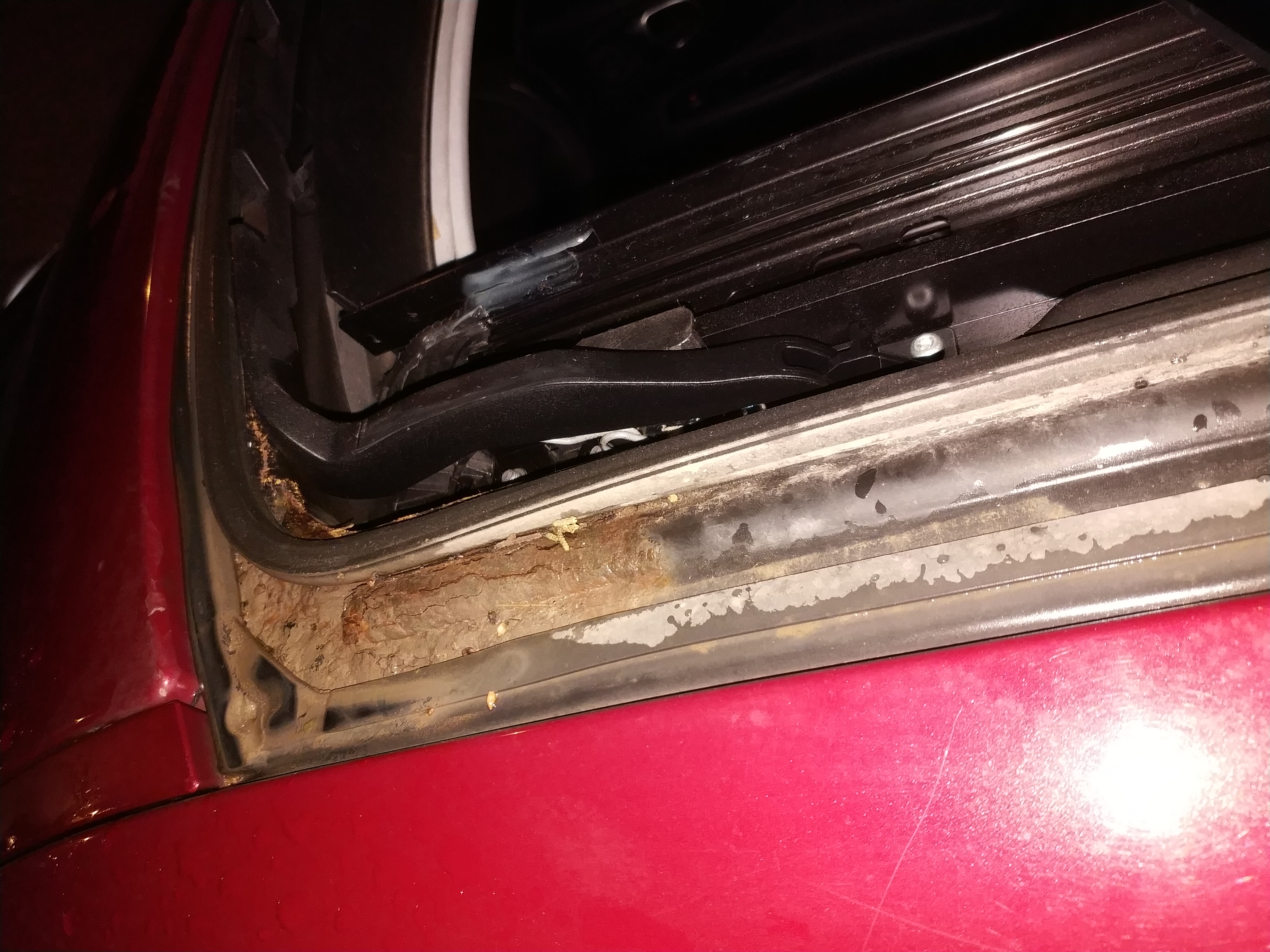

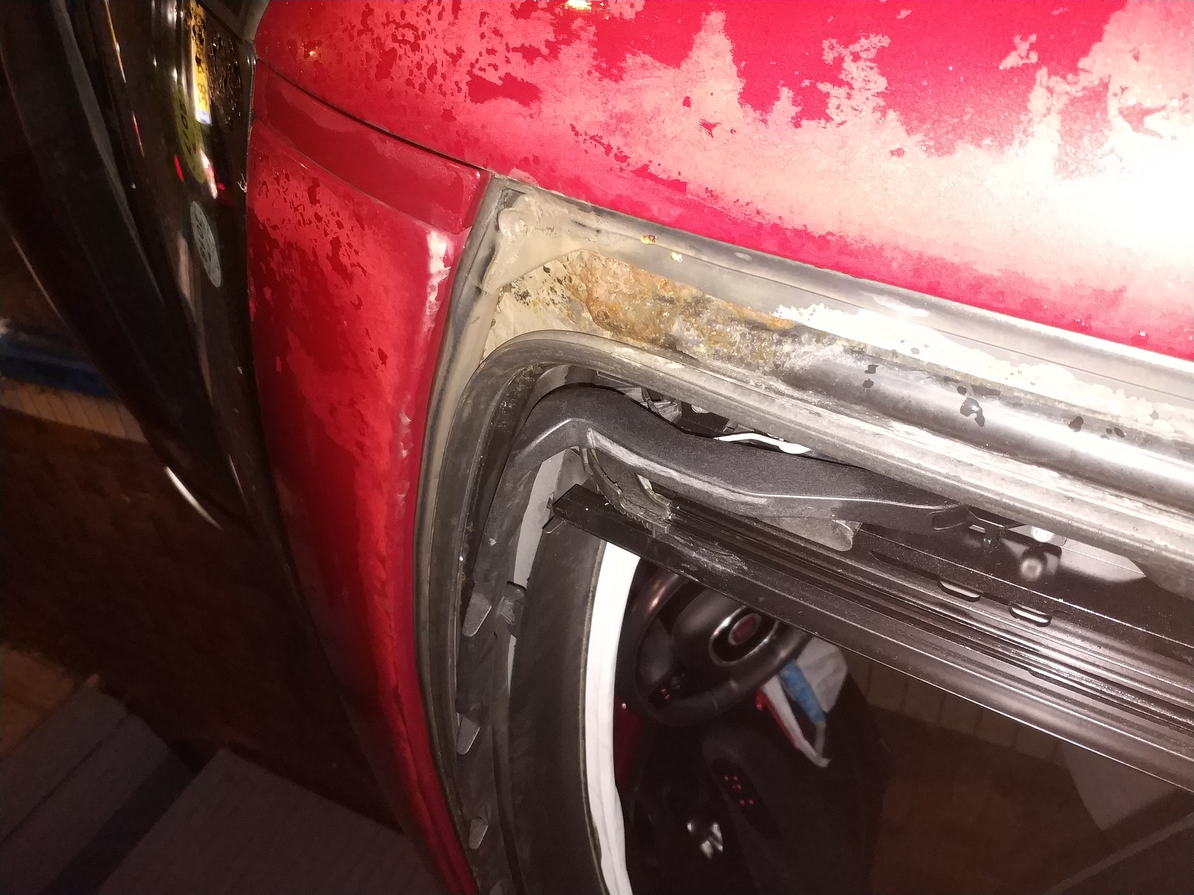

We have our 500L for 4 years now, and recently I have discovered 2 big rust holes (!) under the retracting glass roof - one each side of the roof.
The holes are so dip now that water is coming into the car when it rains...
The holes located in the front end of the glass, where water should be evacuated...

It sounds like the roof channel drains have corroded. There's probably meant to be a hole there with a plastic pipe inside it, to take water down into the wheel arch, behind the plastic wheel arch liner.
If the hole got blocked then the water will have pooled there and rusted the metal.
But I dunno how it's "user damage" unless they're saying it's your fault for not noticing the channels weren't draining properly. I can kind of see that point of view.. but I'm not sure it's completely reasonable. Even if it's flooded, the car shouldn't have rusted already (at least, not in Israel). See if Fiat will make a contribution to the repair.. it sounds less than great at the moment.
If Fiat isn't interested, it should be fairly simple to repair it.. a car body shop might be able to patch it somehow without dismantling half the interior.

Please see the attached photos.
I urge all the Fiat owners with retracting sun roof to check this area for rust.
If you have any initial corrosion or rust damage please take photos of it and post it here - this would help me showing the manufacturer that it is not the first case.

Is there a hole (I mean an "official" hole, not a rust hole :D ) in there to act as a drain? It looks like there isn't.. and the water collecting there has simply rusted the channel.
You should try to claim under Fiat's bodywork/corrosion guarantee... although you might get no change if you didn't have the car bodywork "inspected" every year... I dunno how Fiat can argue that it's not their problem.
But... having said that.. a bodyshop would be able to repair that... although the sun-roof and the liner will have to come out. Not a huge job... but not trivial either.
Ralf S.

The photos look very odd to me. It looks like there is a build up of something in the channel like sand or dust that's gone hard and blocked the drain holes. The paint also looks badly weathered is there a lot of sand blowing around where you are ?
Hi,
The material in the channel is the rust...
