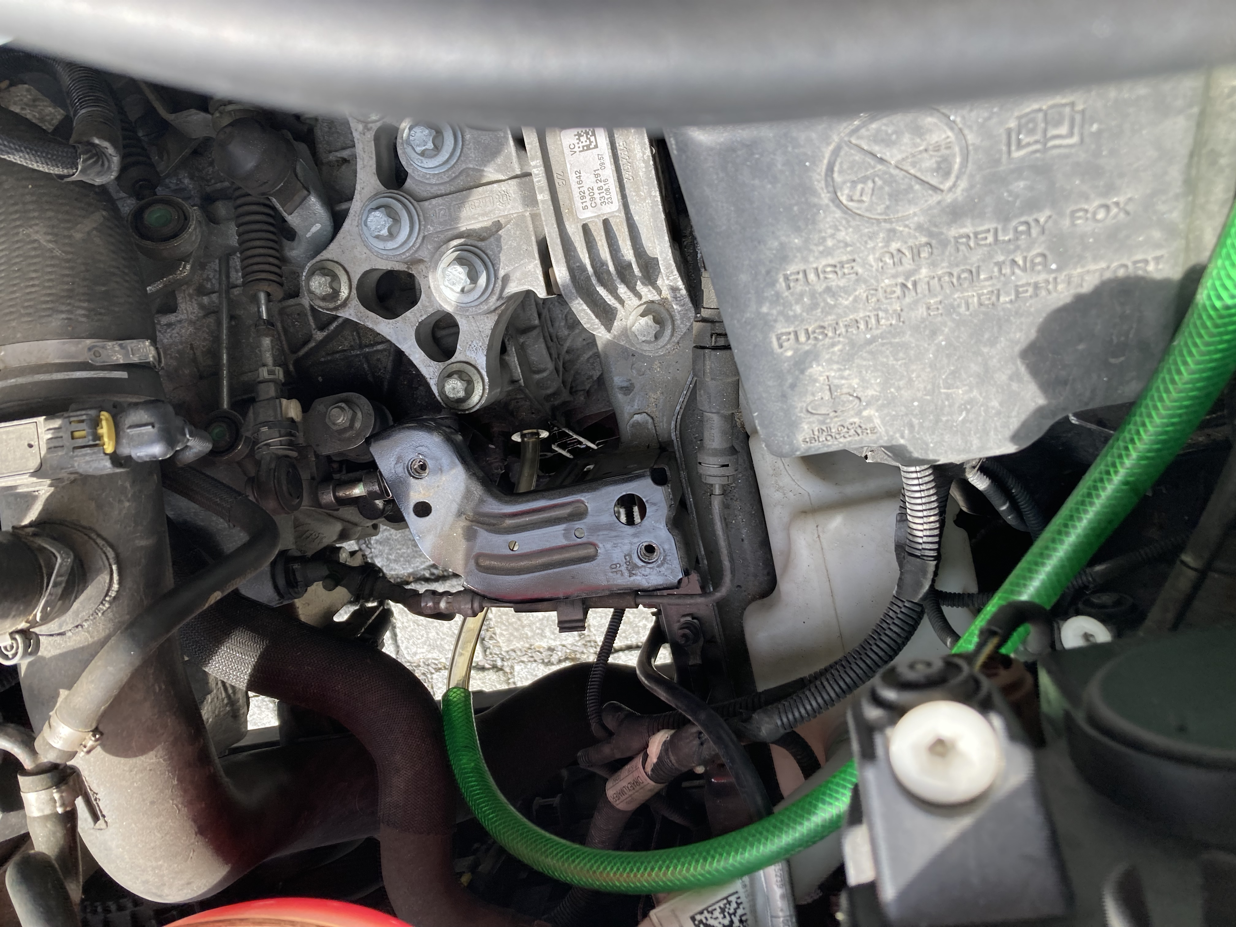

I have successfully changed gearbox oil today on my 500L!
It`s a trap! :)
I was confused similar as you. I`ve studied many YT videos showing procedure on some Alfas with manual 6-speed C635 gearbox. Checked Eper showing filler 12 HEX plug on top of gearbox body. I was not able to find it, but there was one suspicious bolt on the side looking like a part of gearbox mouting. But it was not connected to any mechanical part. Just bolt with a E18 head (same as other bolts used nearby for mountig gearbox to the chassis) screwed into gearbox.
Long story short. Probably Fiat used one threaded hole in gearbox body used in other models for mounting the gearbox to chassis as a filler hole. Then the original bolt is used as a plug. Definitely it is a better solution than the plug on top. It is even accessible from bottom. For best access I recommend to unmount the battery and the battery rack.
It`s a trap! :)

Hello, thank you for your message, the detailed information and the clear pictures of the location of the plug. I also saw the video of the Alfa but did not see the filler plug on my car either. I am going to remove the battery and the rack, loosen the filler plug, drain the old gearbox oil and change it with the new one. They say that the gearbox oil is for life but I will play it safe and replace it.
Thank you very much for your help! Otherwise I would have been looking for the filler plug for years and years :)
I have changed my oil in 130 kkm together with engine oil and filter. When the lower engine cover is already off, why not to try… Magnetic catcher on the drain plug was covered with some metal shavings and also oil contained few ā€œglittersā€. I think it’s worth it at least one time per car lifetime. Mine 500L is nearly 7 years old.
