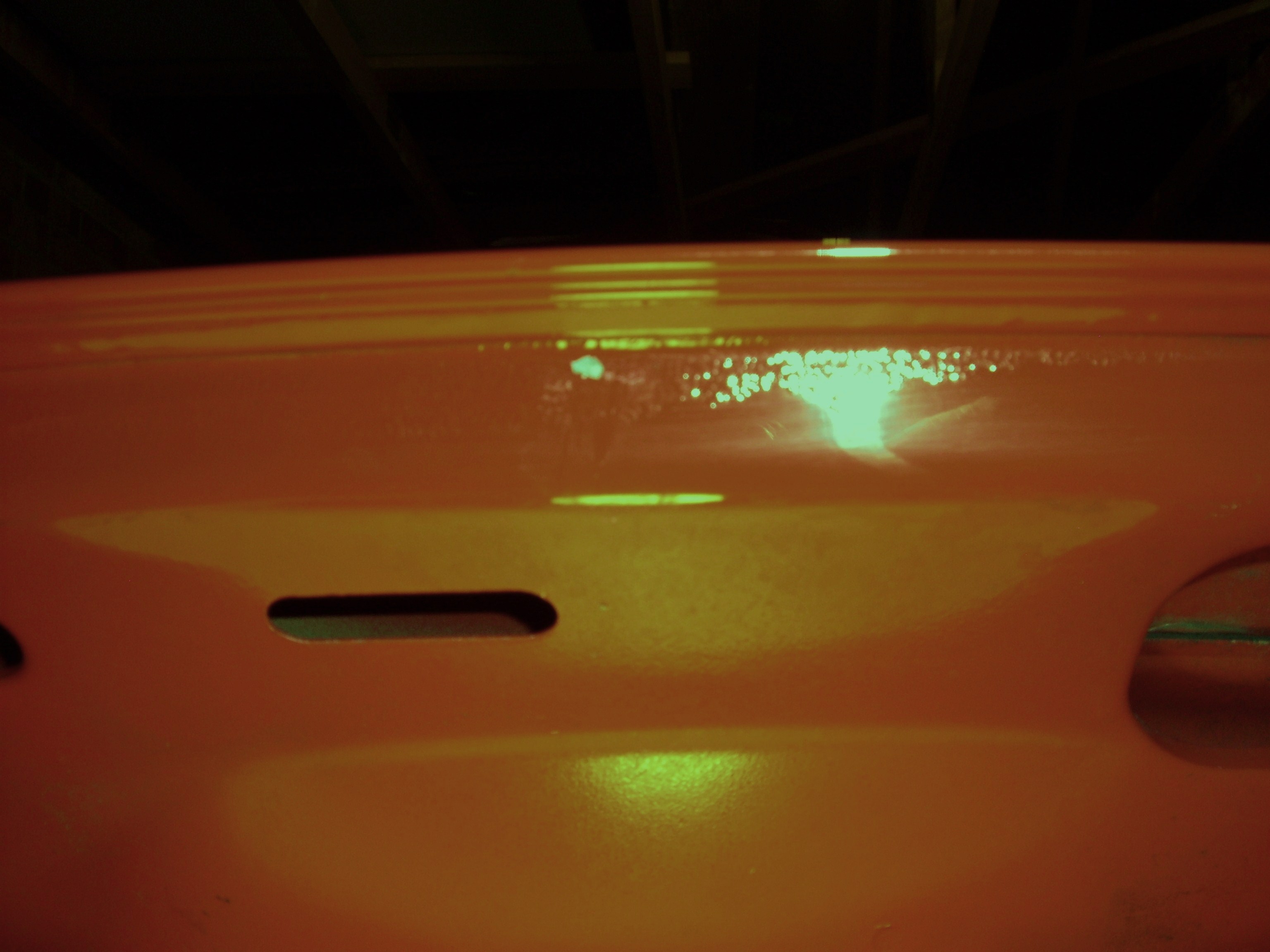

Hi I'm James and a new member to the Fiat Forum.
I have owned a 08 Grande Punto 1.9Mjet since new and have been very pleased with it.
Resonantly I too have noticed what seams to be rust appearing with paint now flaking on the inside lip of the Bonnet and on the inside lip of the Boot lid.
I am quite surprised as I think I have looked after it well with regular washing, polishing and it's stored in a garage.
Thanks to the Forum,s advice a few years ago, I too sealed the leak into Boot lid which was filling with water but maybe the damage had been done.
I have tried to included a photo (although not very clear)
I will visit my local dearler this week to see it is covered by the 8 year warranty mentioned in Hand Book.
If not I will try and repair myself.(At leased it's not in a to visible location).
It is covered 100% , mine rusted exact same place, took to dealer outside of 3rd year warranty, they booked me in to approved body shop and it was sand blasted back to bear metal, galvanised and resprayed, think the bill was £200 to dealer
