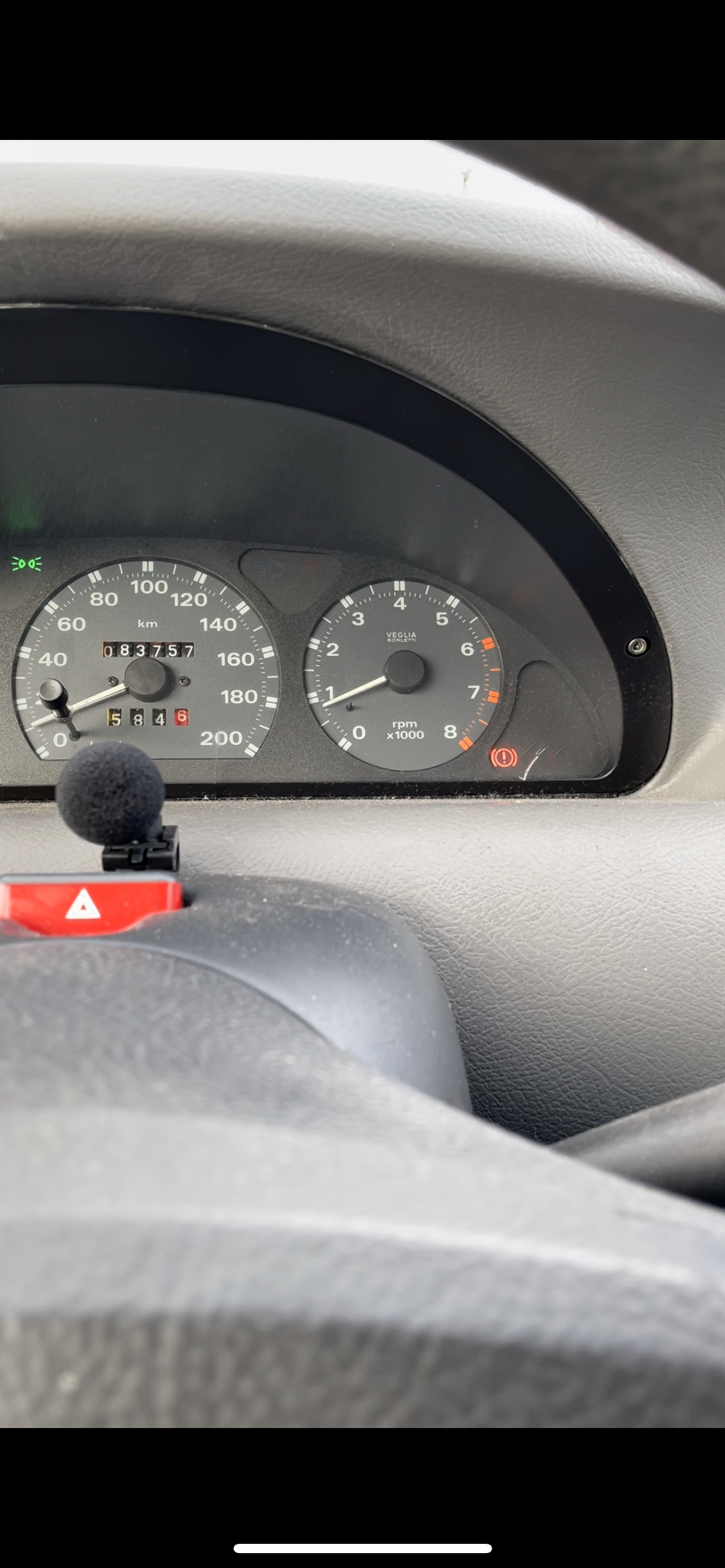

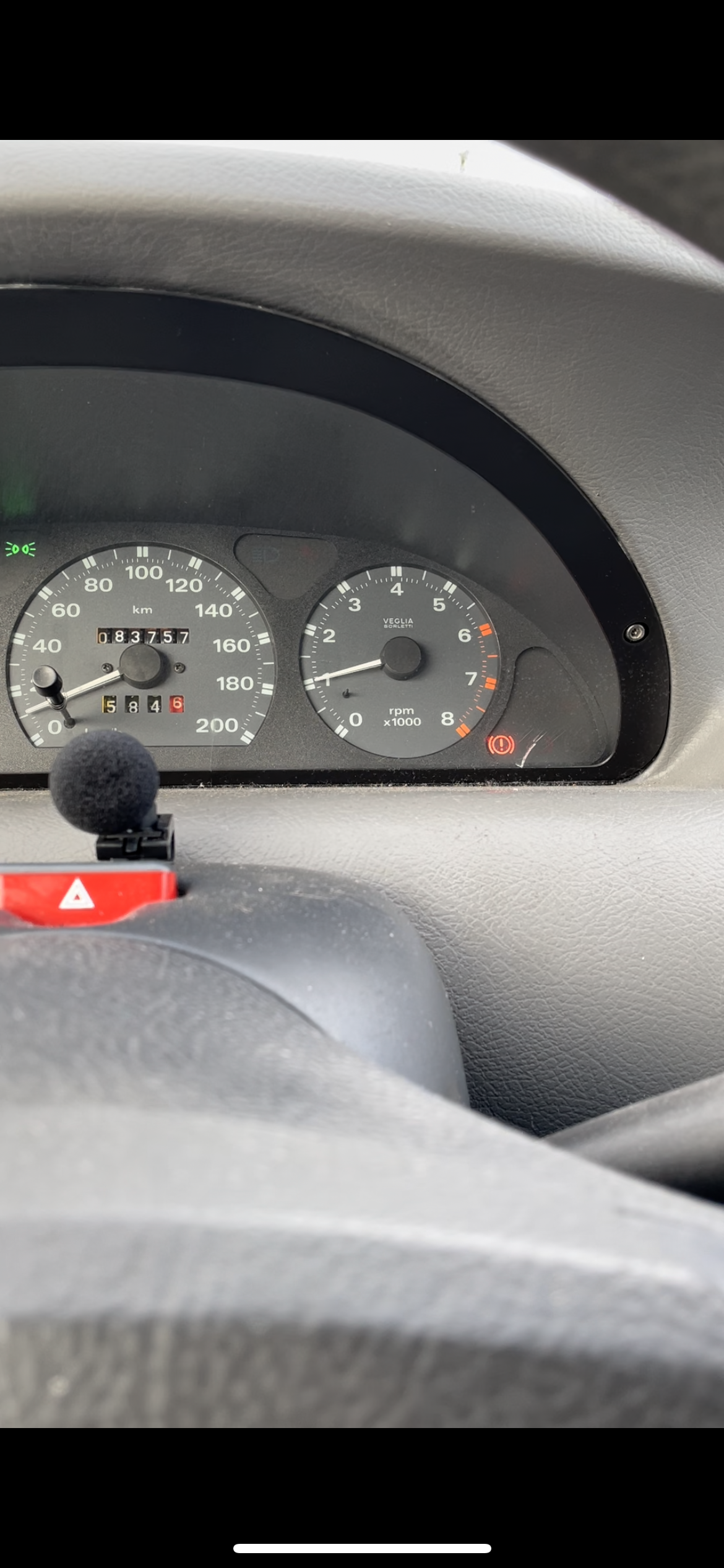

I have this weird problem where my rpm drops under idle and bout to stall when the engine is warm
It's supposed to idle at 1k rpm
Few years ago i noticed the gas pedal could move further up and stall the engine, so I adjusted it to not happen again and the engine stays at 1k rpm on idle.
I would send a video but don't know how

I got it down to 900 and it runs much better now. But I can't take it below that or else the engine will stall.
