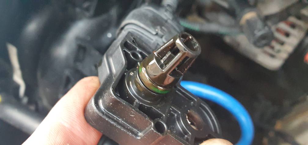

Next time you feel up to it remove the map sensor , see if it's covered in oil , post a photo, try and clean the oil off it spray as best you can.

Hi i don't know if i mentioned this before but the rough idle is worse when the engine is cold like it is extremely shaky obviously still there when warm but thought I'd mention that. With check the MAP sensor tonight and give it a clean. Other then that looks like ill be taking a trip to the garage.
