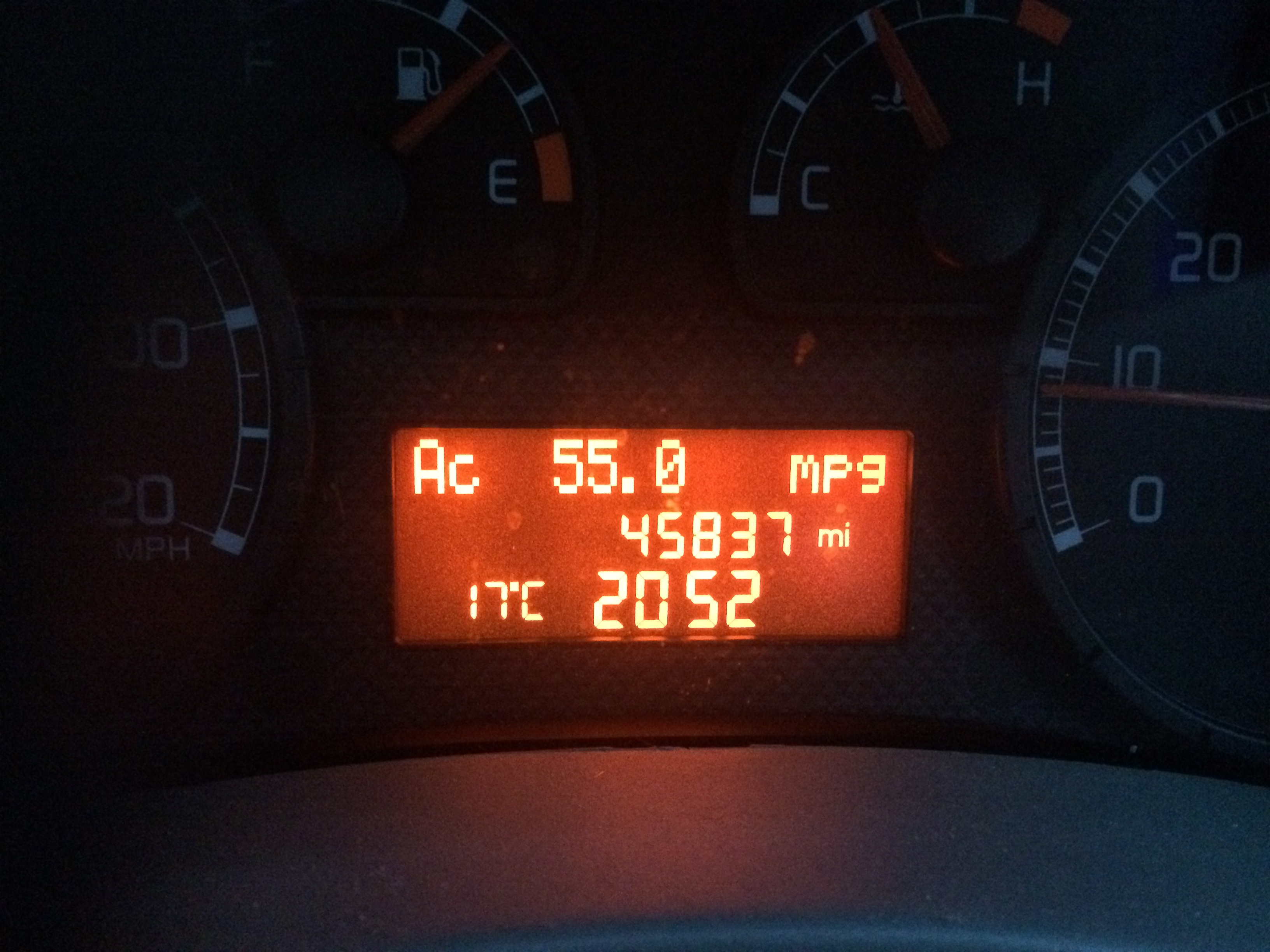

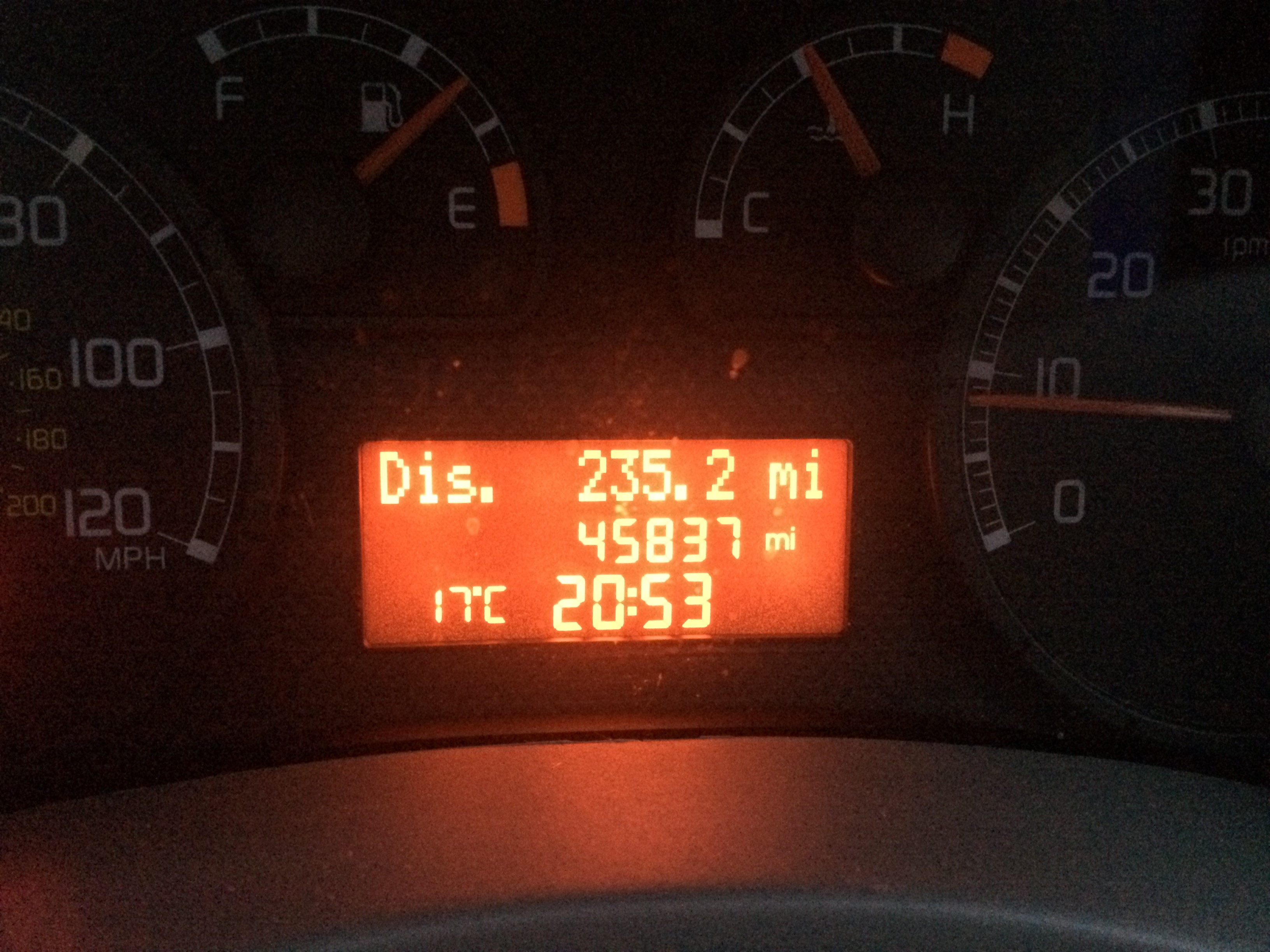

As for performance, She runs very well and giving me 55MPG average on modestly short runs of around 8-10 miles, pics attached.
