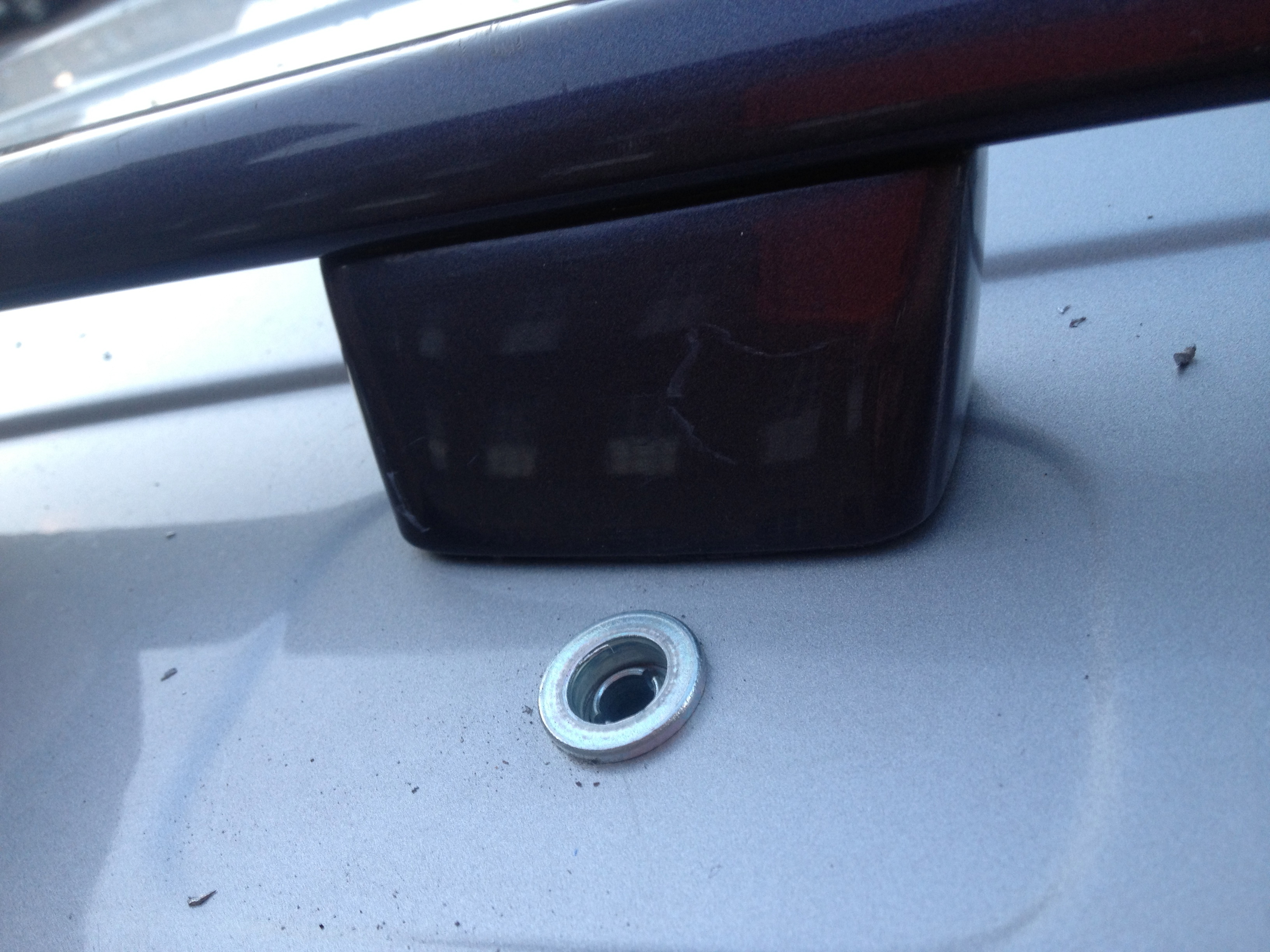

Fixing to the roof is mostly the same as the fixing method on the Volvo.
Each of the 3 mounting feet is bolted to the roof cross member (these run across the roof underneath the recesses in the Doblò roof) with an M5 socket headed bolt which passes through an M10 threaded tube (5.5mm bore) which is screwed into an M10 Rivnut in the roof.
The mounting method seems a bit involved but it’s designed to transmit the load from the roof rail foot onto the roof cross members (not solely onto the roof!) without deforming the roof itself. The threaded tubes are screwed out just enough to fill the gap between the rivnut and the cross member.
The joint between the roof rail and roof is sealed with some 5mm thick closed cell foam; the correct gap is maintained by the 2mm thick flange of the Rivnut.

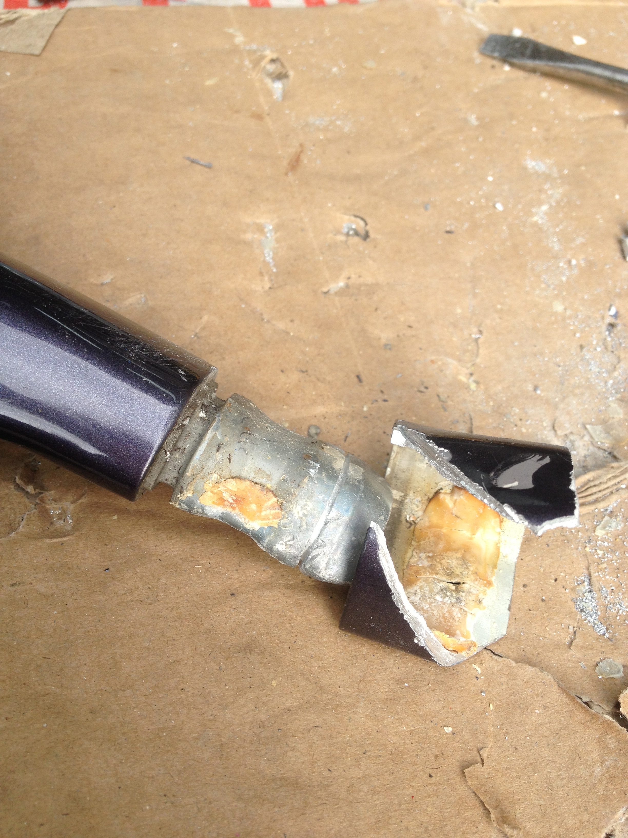

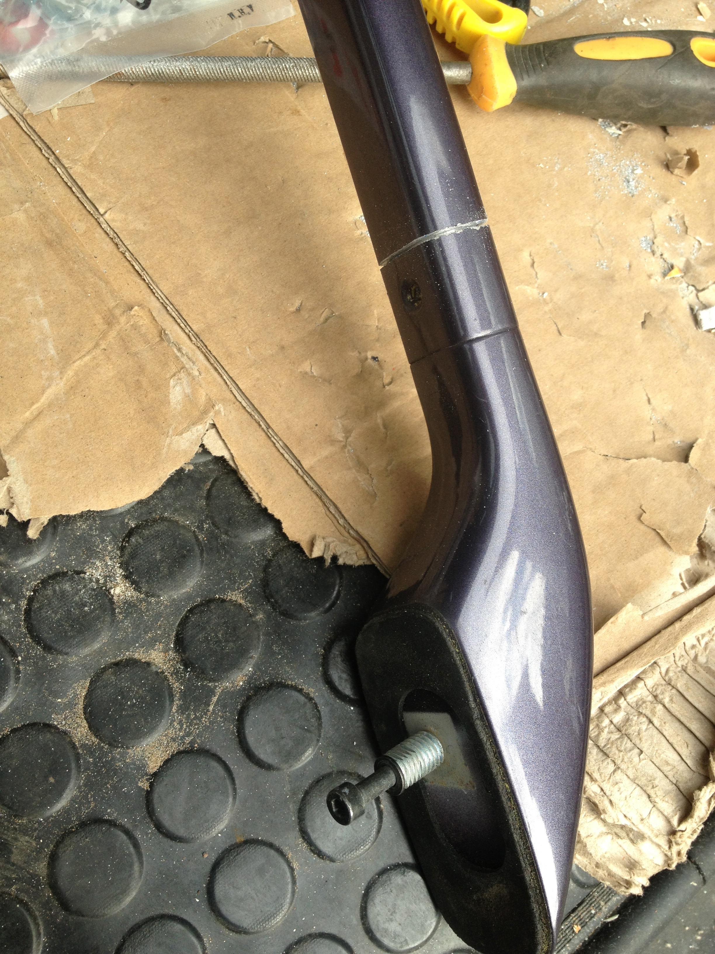

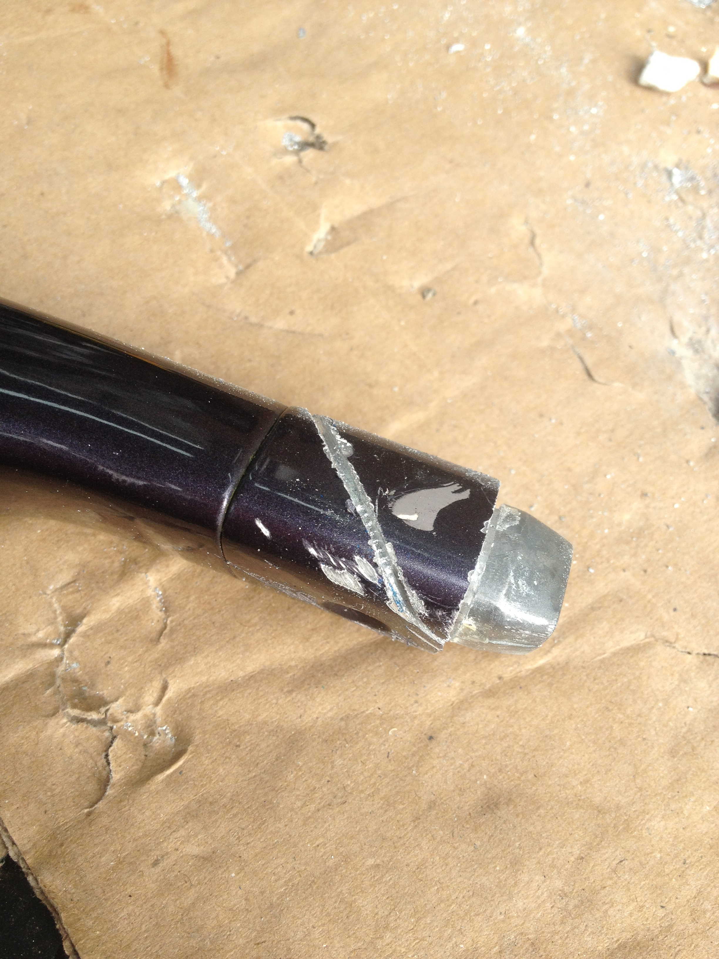

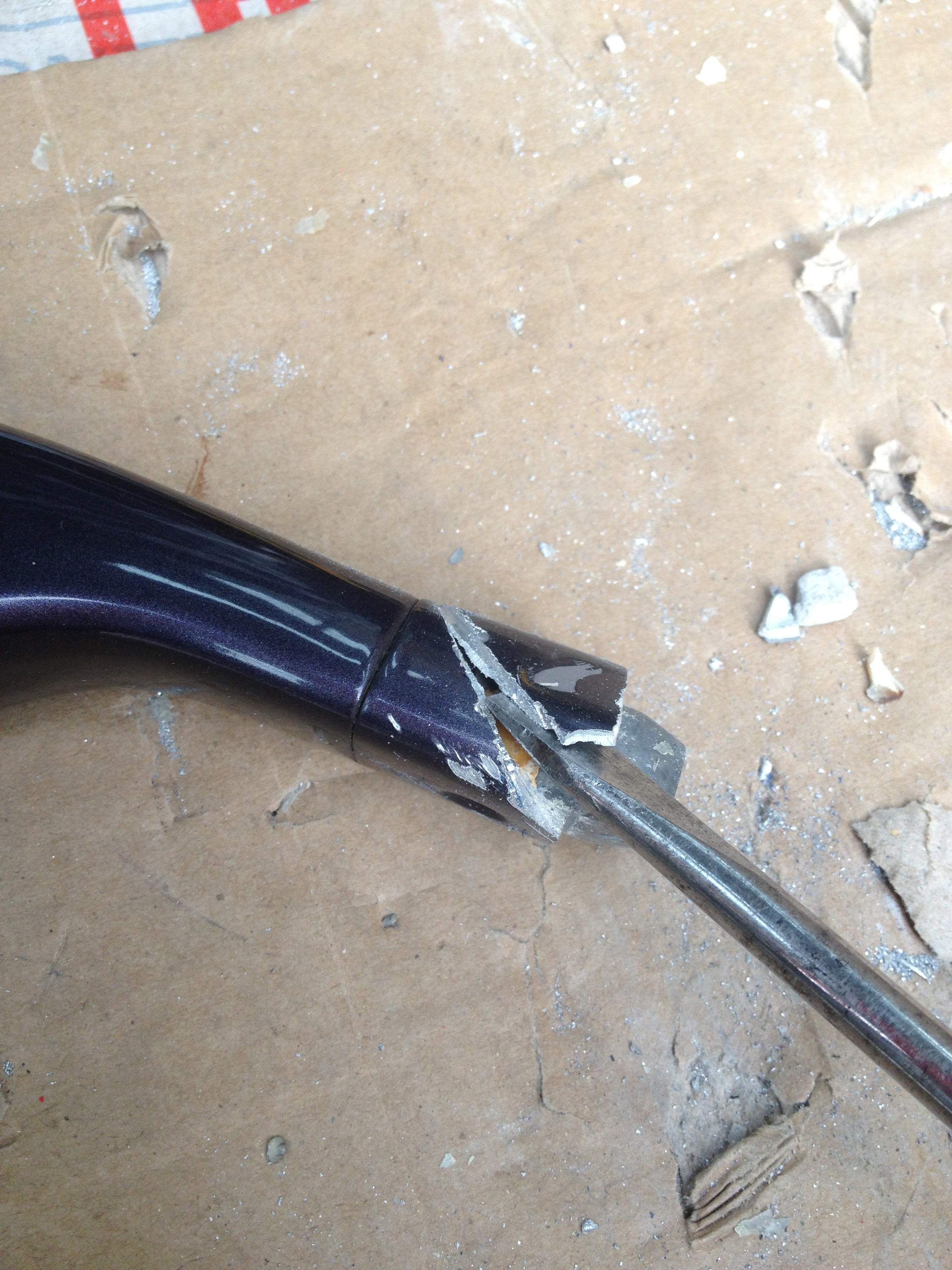

Hi Bidello,
If you do find a pair of roof rails on a scrap Volvo and you take them off yourself then the fixing method will become clear.
To get them to fit on your Doblo the end feet need to removed from the rails and then the rails need to be shortened off and with a bit of gentle bending the feet sit snugly in the recesses in roof.
The feet are connected to the rail by a spigot (part of the foot casing) which fits into the ends of the rail, it’s bonded in place with a gap filling adhesive.
I found the best way to remove it was to cross cut the rail just clear of the spigot end (about 40mm in if I remember). Check you aren’t cutting too much off leaving the rail short! Carefully cut along the scrap length of rail left on the foot spigot (without cutting too much into the spigot) and peel/lever it away from the spigot assisted by something like a largish slotted screwdriver.
Once off the old glue will chip off the spigot and the job of gradually curving the rail (soft jaws in a vice to hold it without damage to the paintwork) and incrementally cutting the rail to length can commence.
Next job is to drill the holes in the roof, fix rivnut etc.(Scary bit)
Dry run the modded rail on the roof and if all fits well take apart and smear suitable adhesive over each spigot and in the ends of the rails, reassemble in place and allow adhesive to set.

Hi all,
It took me a while to find the right rails for the mod and even more time to fit them...but it's done at last!
I started taking picture to aid others in the process, but then it started to snow so hard that I had to stop:mad: Fortunately I had put only one rivnut on so I sealed the hole and waited for next day - more snow....
Anyway I then finished the whole thing last weekend, but never took any other picture:eek:
I will take one last pic of the finished work, although it is not needed as you can see the nice picture of Poperon's Doblò above.
Also, please note that my pictures are only intended to be a visual aid to the excellent step-by-step Poperon guide, stick to it and you'll end up with a nice railed high-roof Doblò:D
