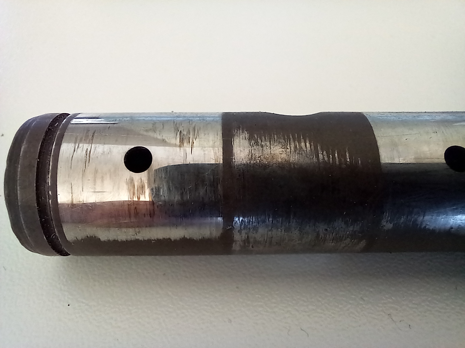

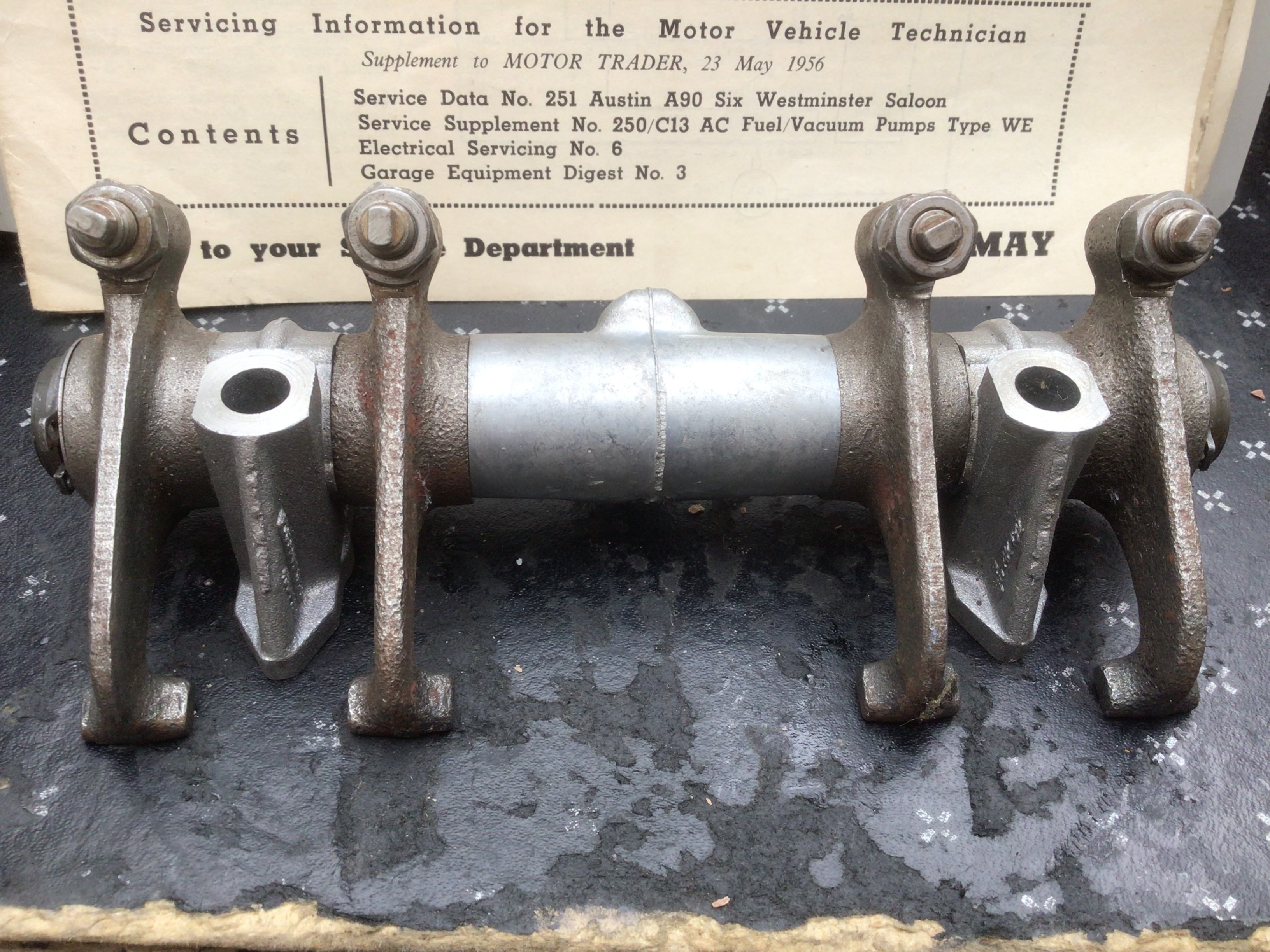

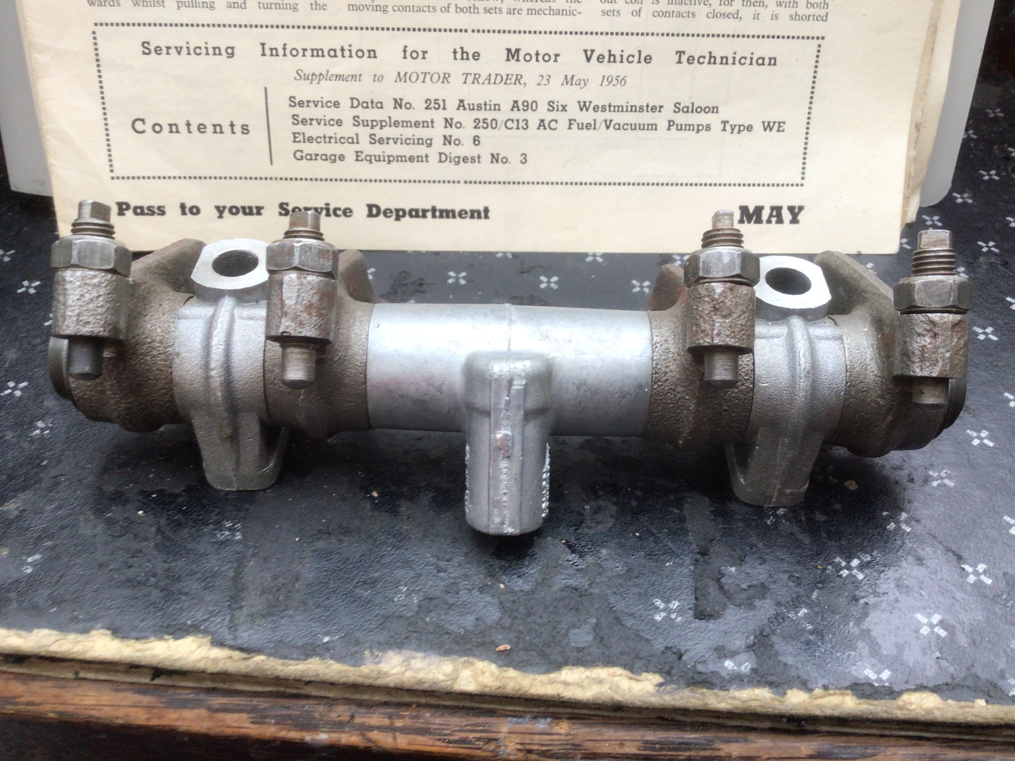

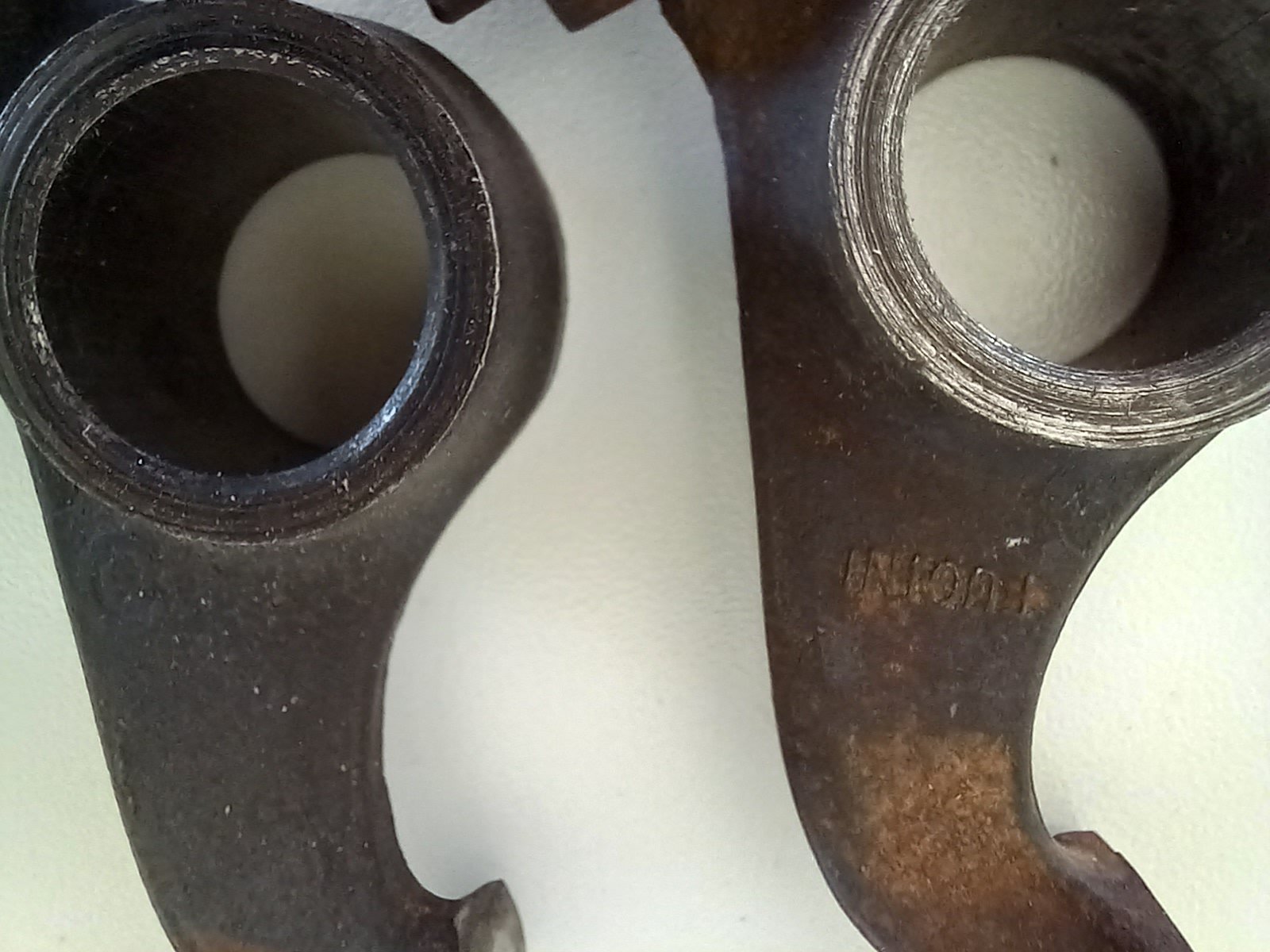

Bear with me on this...there may be mistakes; we are all prey to them when we rely on memory or the wisdom of others. ;)
I have attached a main image of the dismantled rocker-shaft of a 110F engine. You will find this marked on the aluminium parts that support it. This is an important thing to note (and here is the memory bit), because the design of the shaft on the ones marked 126(A) may be different.
You can see the highly polished surface, which is the underside of the shaft when installed, where the rocker-arms are thrust upwards in the course of their work. Turn the shaft over and the shaft is unworn, but there is an additional oil supply drilling. In theory, this shaft can be rotated 180 degrees in the vertical plane and it may be possible to bodge a bit more life out of it. As far as I remember, I have handled one of the later shafts that had the oil-drilling on one side only. If this shaft was dismantled and reversed there would be no oil feed to the loaded interface between the rocker and arm, which would lead to disastrous wear or seizure. Is this a possibility in this case?
As an aside, I notice that the rocker-arms pictured, which are from separate assemblies, are marked differently and are slightly different visually. The chunkier (rustier) and in detail, less finely finished object is marked, "FUGINI", whilst the other has a symbol that is hard to decipher, but which may be a capital C with an E in the middle.
Yes, the shaft for the 126A is indeed different. The posts are marked "126AB-0CC" and the oil opening only exists on the bottom face. The rocker arms are all marked "FUGINI".

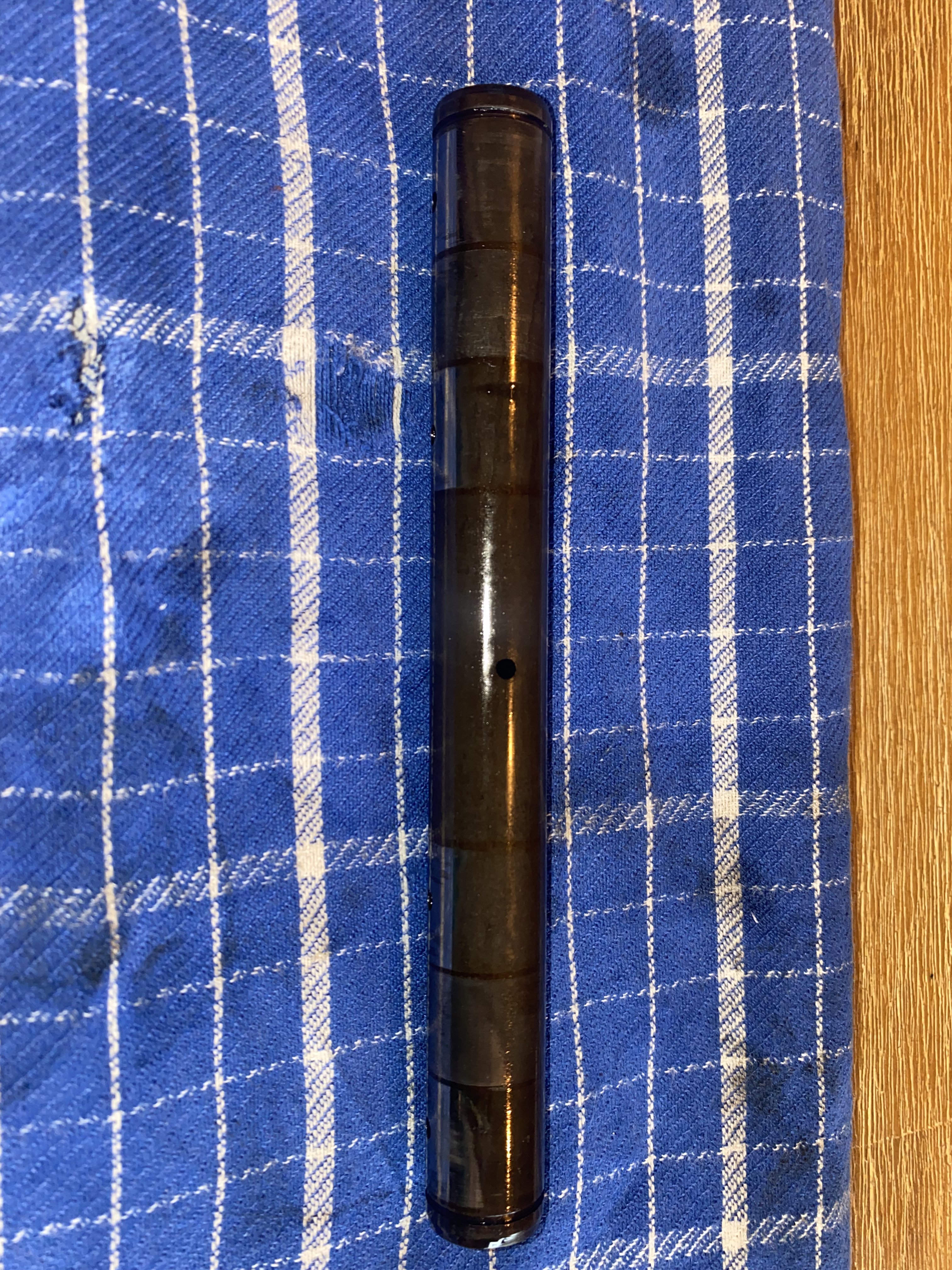

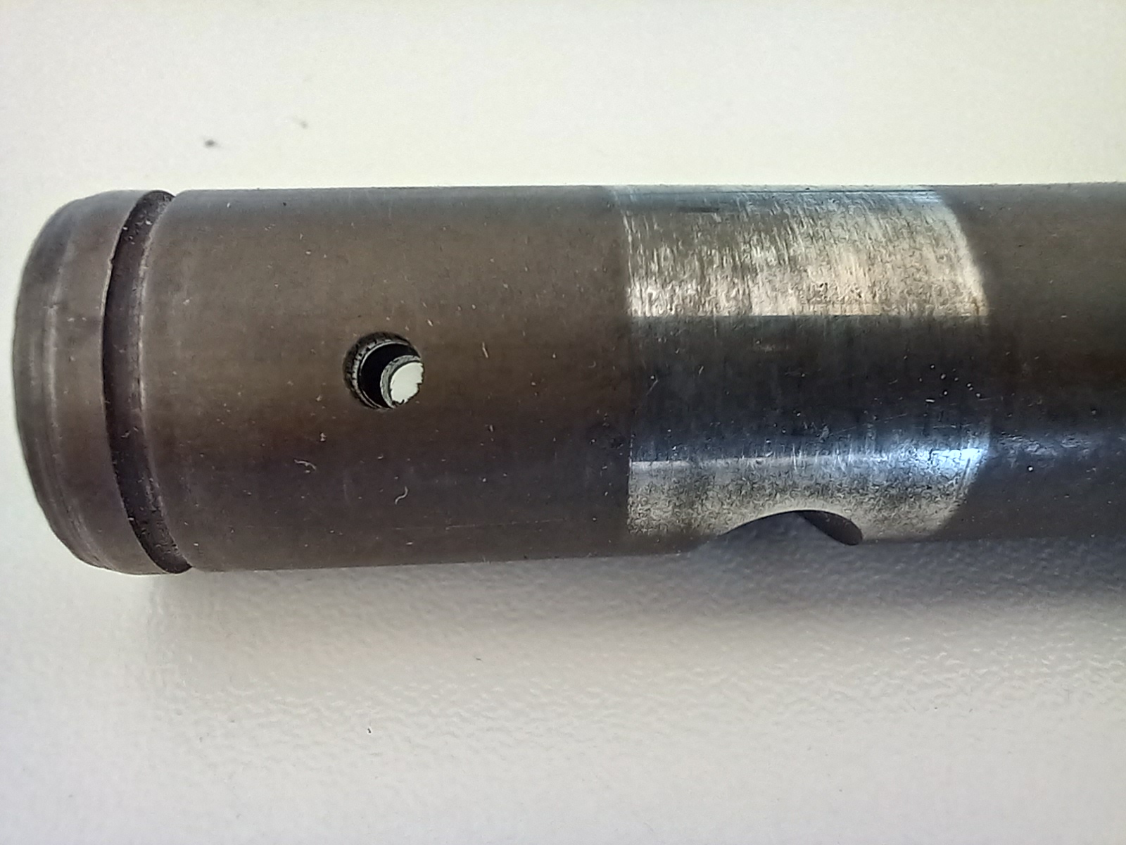

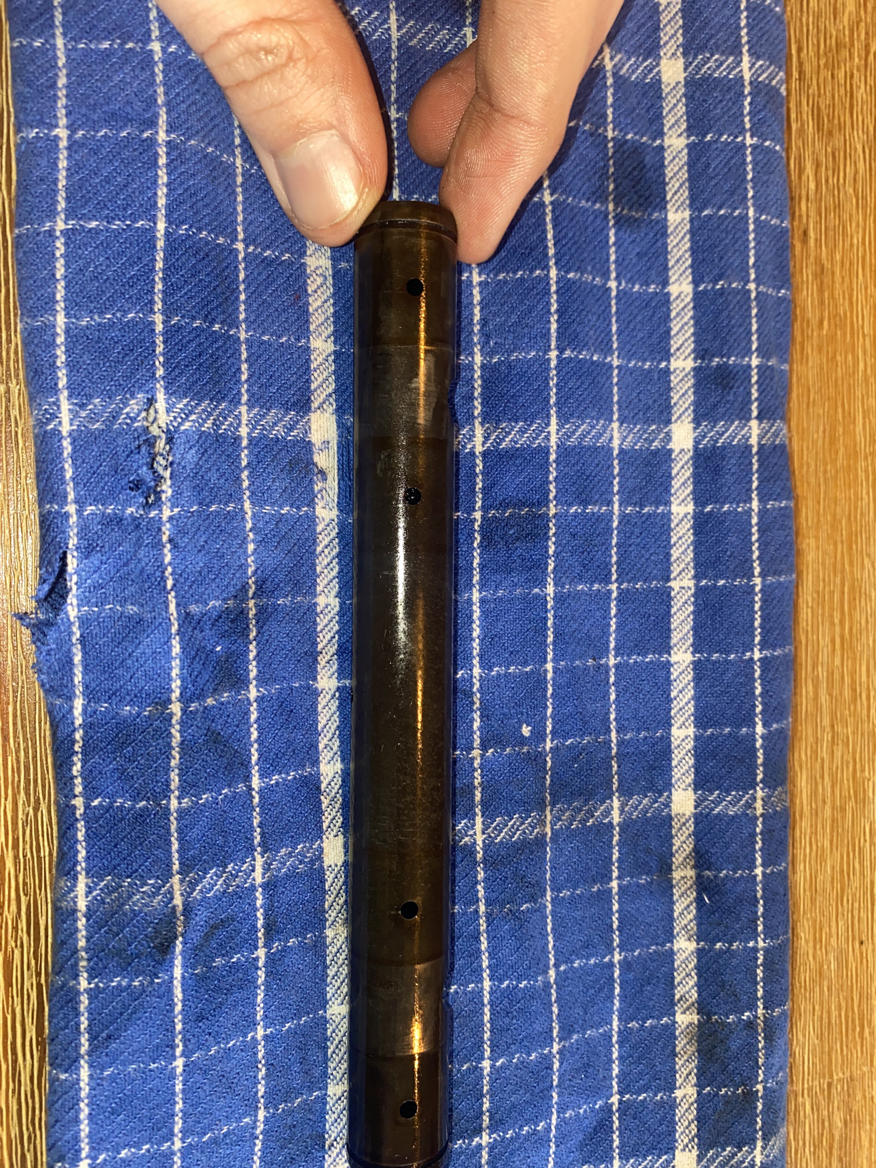

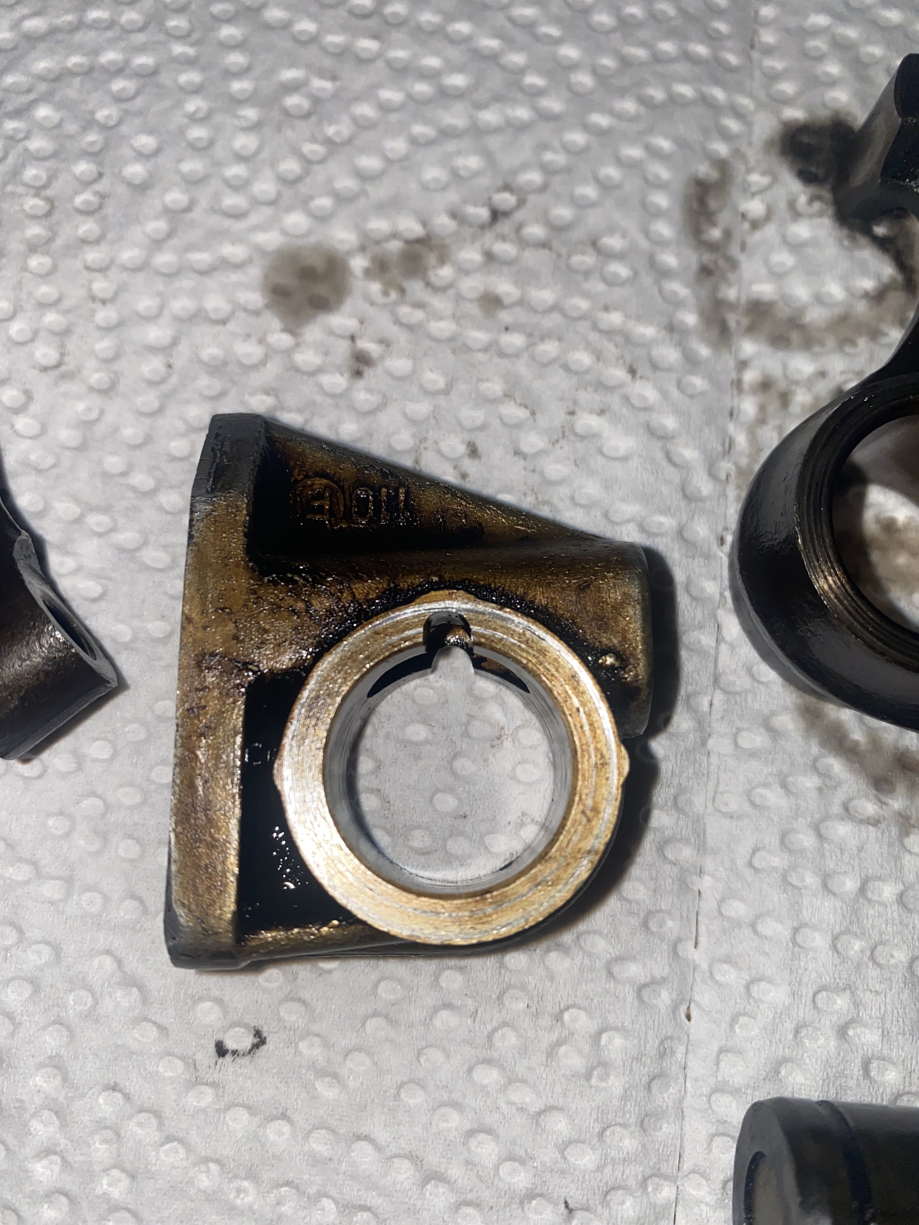

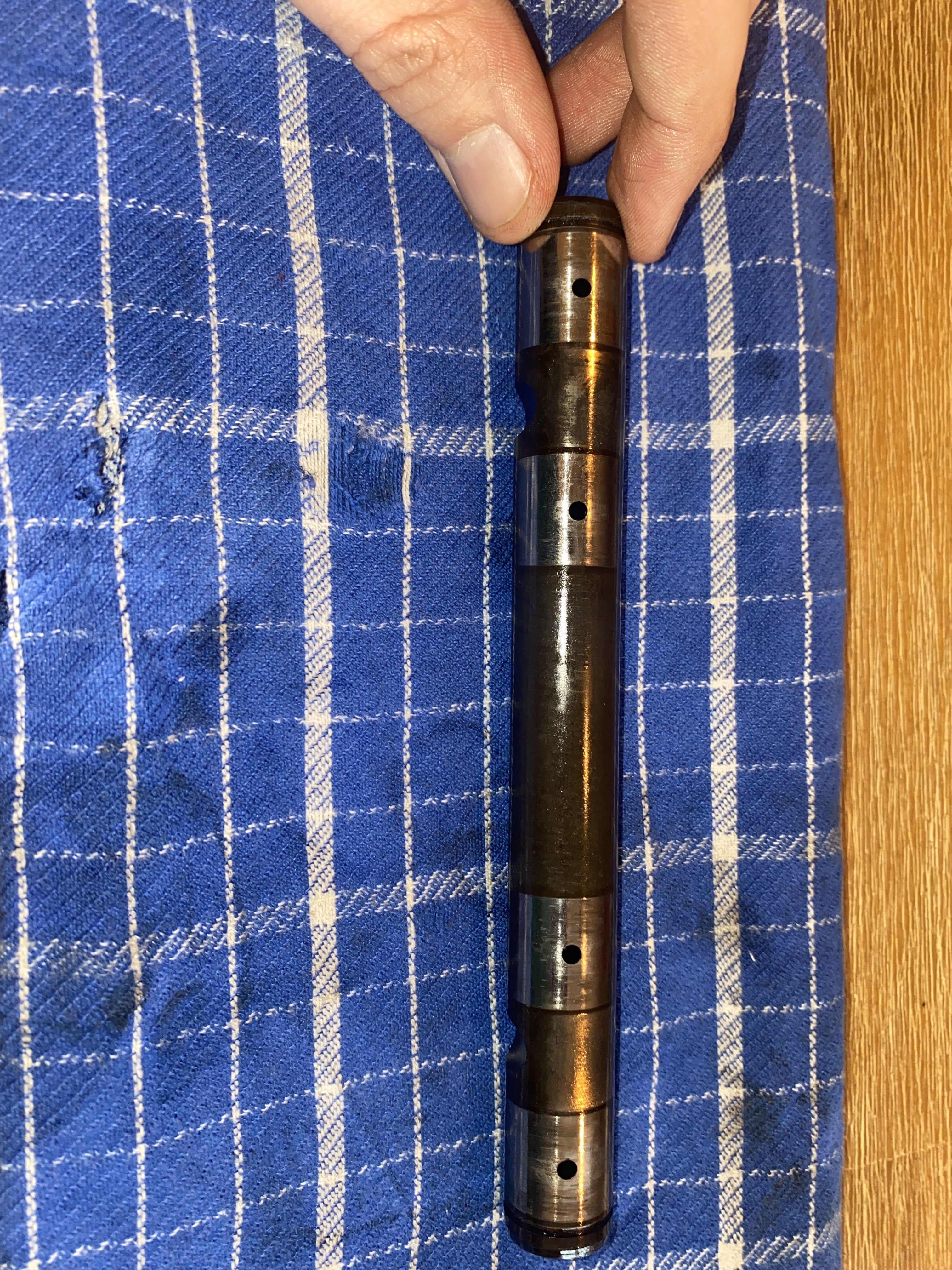

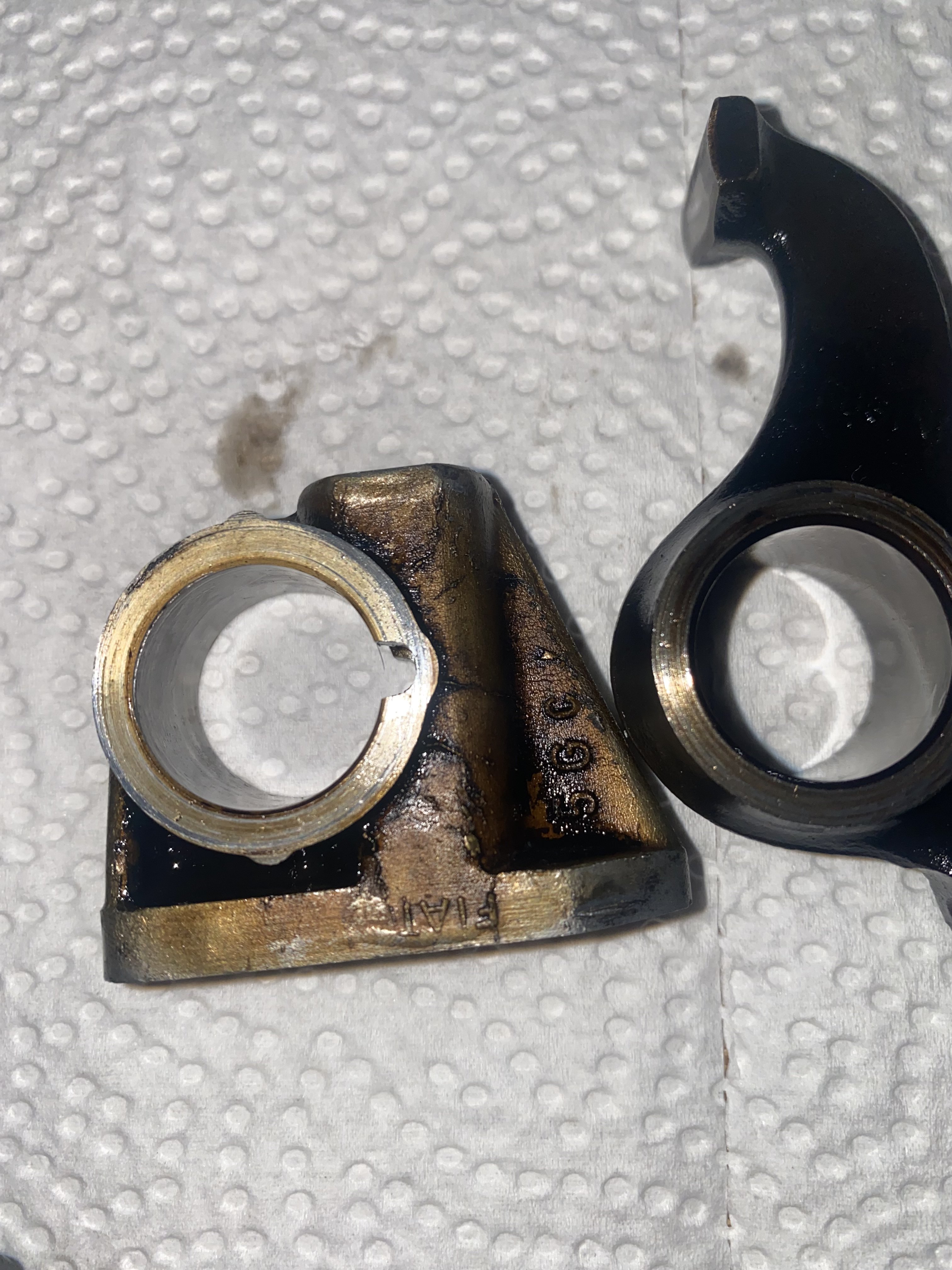

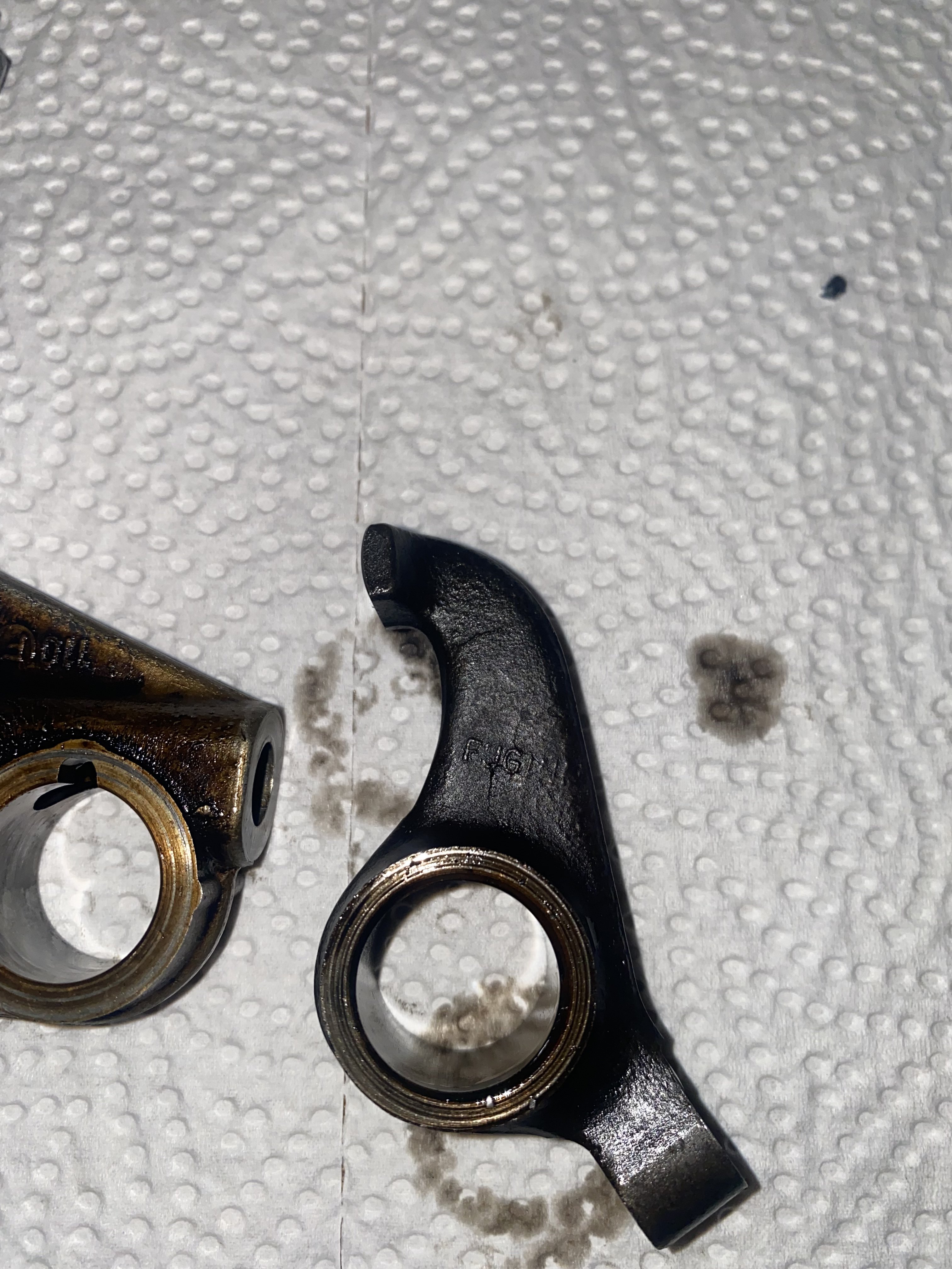

Okay, I have stripped the assembly and if I understand you correctly, I have 110F supports and shaft, but the rockers are 126? Now that I have stripped them I dont really know what to do with them haha, I did not find anything that is very obviously wrong. I think I will order a new assembly and put that on
Also I am extremely grateful for all of your input, it really helps me! Thanks a lot
I think you need a new assembly as the surfaces on that shaft look scuffed. Your next move would be to carefully measure the ovality of the shaft and to check the clearances between it and each rocker, which is quite tricky to achieve. I think you can be pretty certain that the decision to get a new one is the correct one and saves a lot of wasted time. :) When I have measured them, even apparently quite good, used assemblies have been out of tolerance.
I think I am going to order the new assembly then. I have only found an assembly on axel gerstl, is that an okay supplier? Are there other things I should be considering when installing the new assembly? Or just install and see if it works?

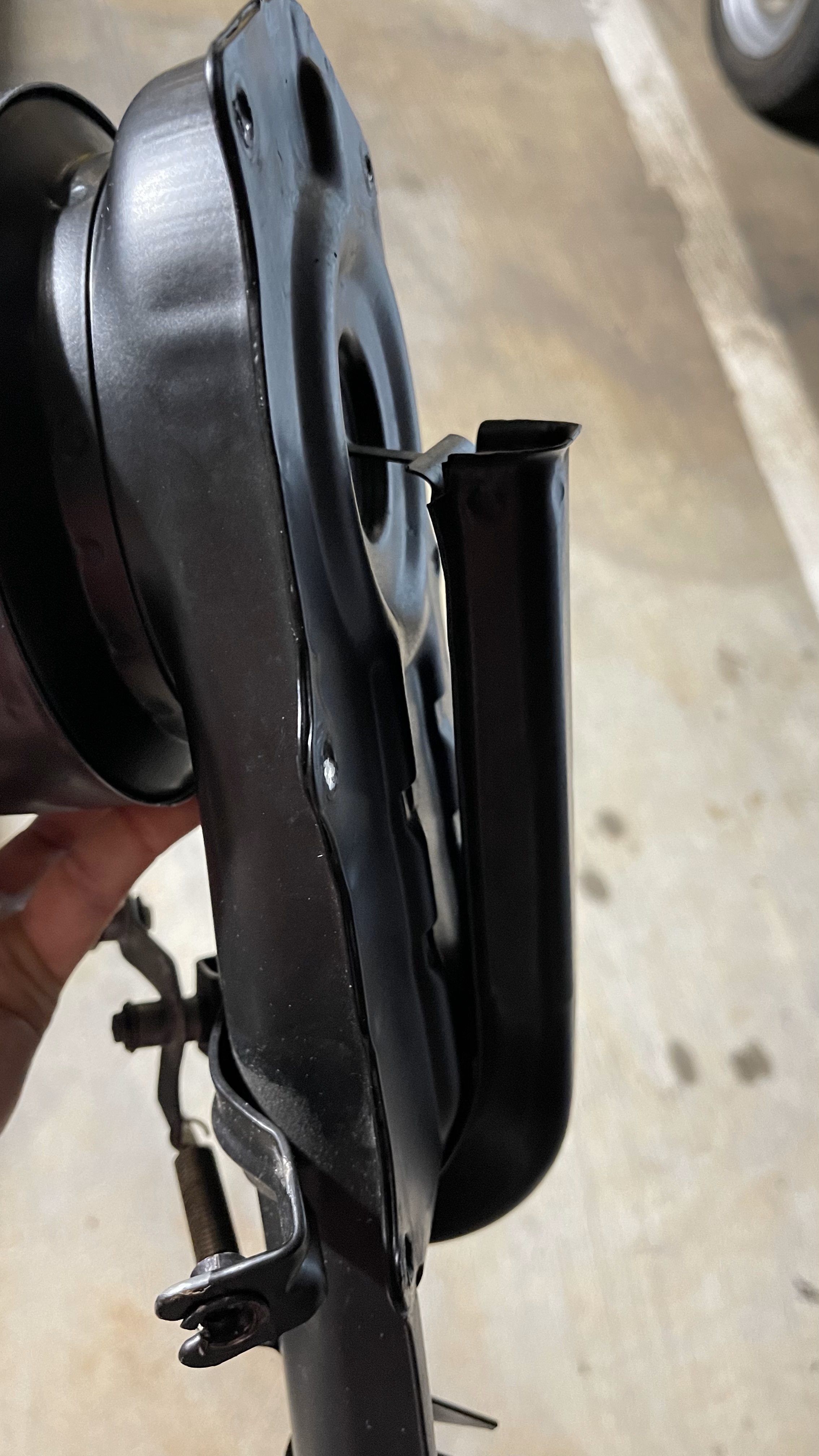

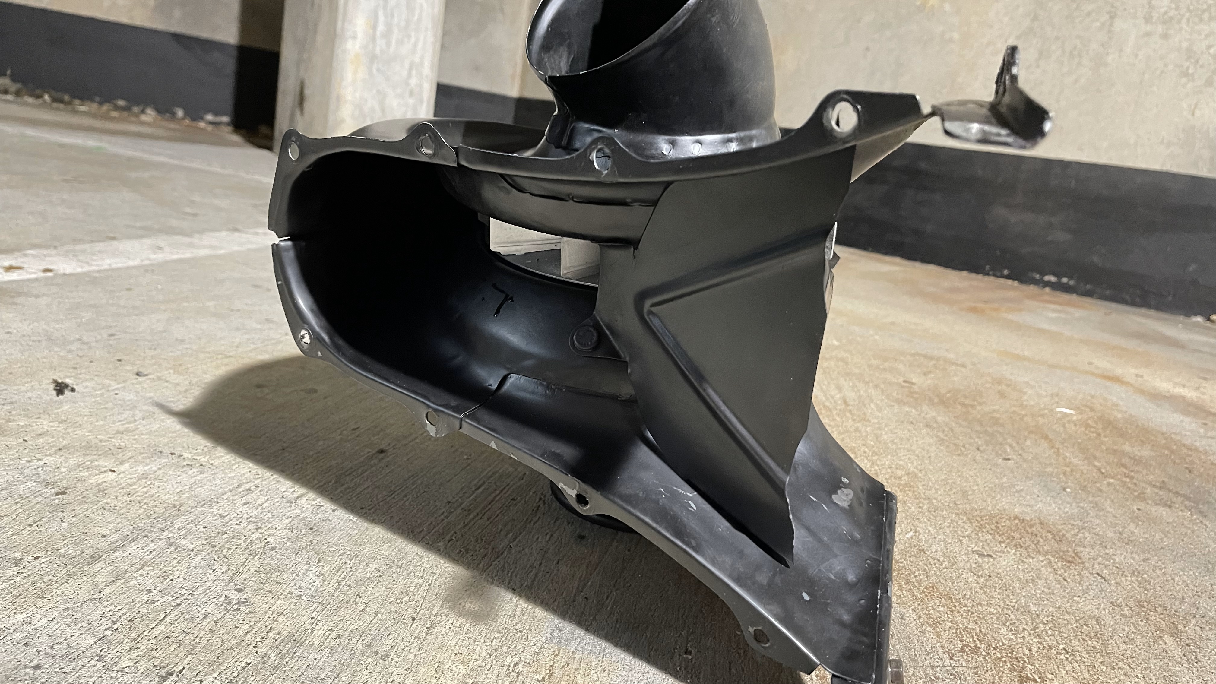

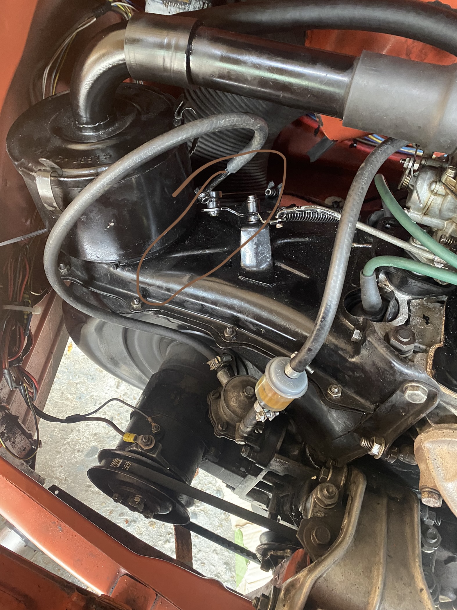

I removed the top cover which was quite a struggle, one of the previous owners loved to really tighten screws down... Sadly there is one badly worn screw that attaches to the head so i hope that thread is not ruined..... sigh...
See the images/videos attached of what i found. There is nothing loose, and to my surprise it is quite clean...
The bottom of the airduct seems to have been hit or dented repeatedly, although the duct itself is still attached to the top cover.
I can not move the deflector plate at all (see the video)
I suppose the noise starts when the engine heats up, indicating the air deflector or top plate gets more room once the engine expands due to heat and therefore the air deflector starts to make more noise and maybe hits the air duct? Could that be what is happening? To me that is a bit of a stretch.
Do you see anything else abnormal? If not, how can I check what is wrong?

Also for the fuel line: i will add the clip, but rerouting it to the correct position will be tricky, considering the hard fuel line points towards the top of the shroud. I will also remove the filter, but all that is for later.
Edit: Could i start it without the top cover installed and let it run for 2-3 of minutes in order to test if the noise starts? Or is that a terrible idea?

When you touched the vane on the fan did I detect a rattle in your video? If so it is on the verge of failure.
also re heat expansion you are looking on the cooling side of the engine so that will not be a factor.
