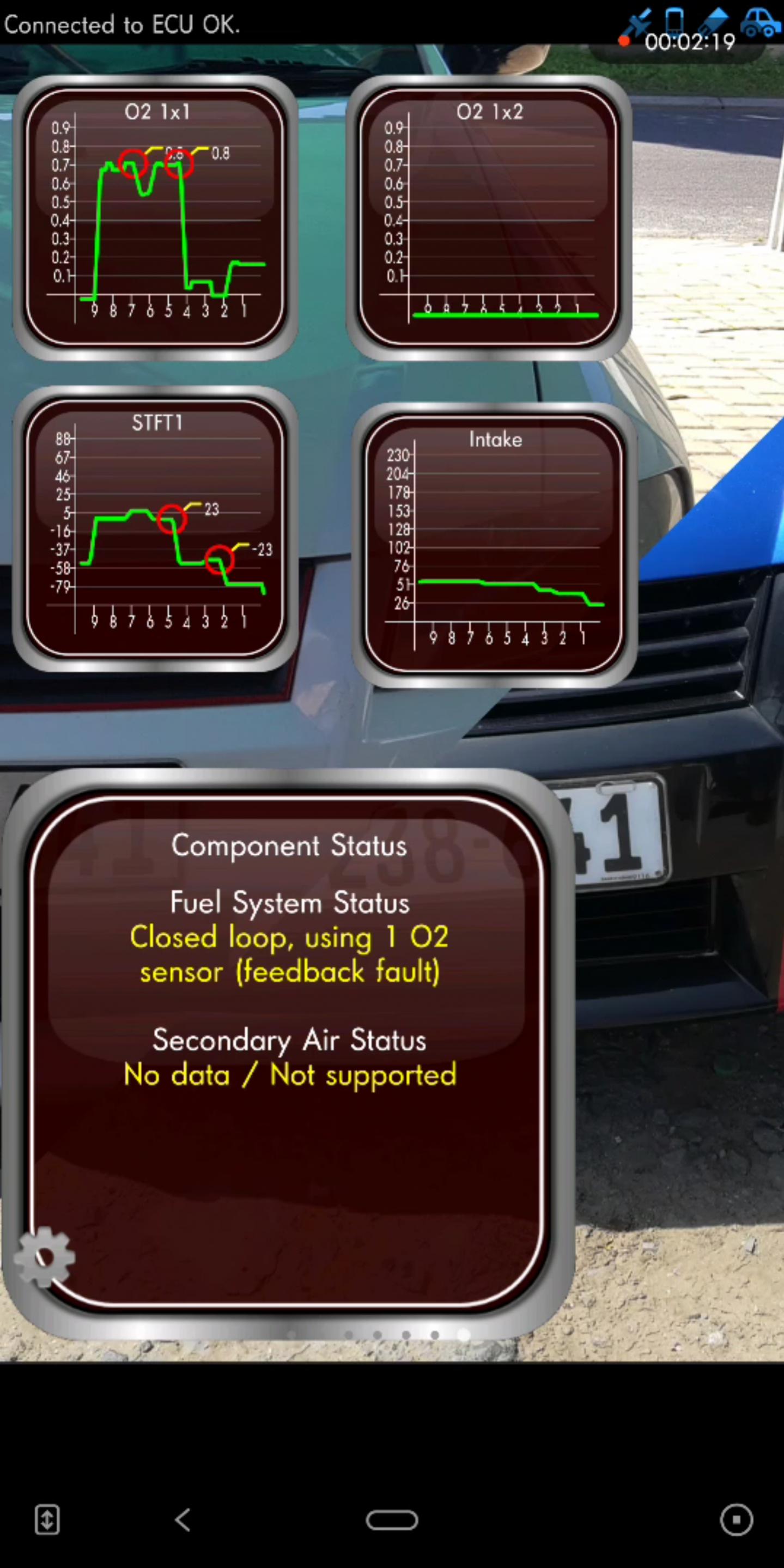

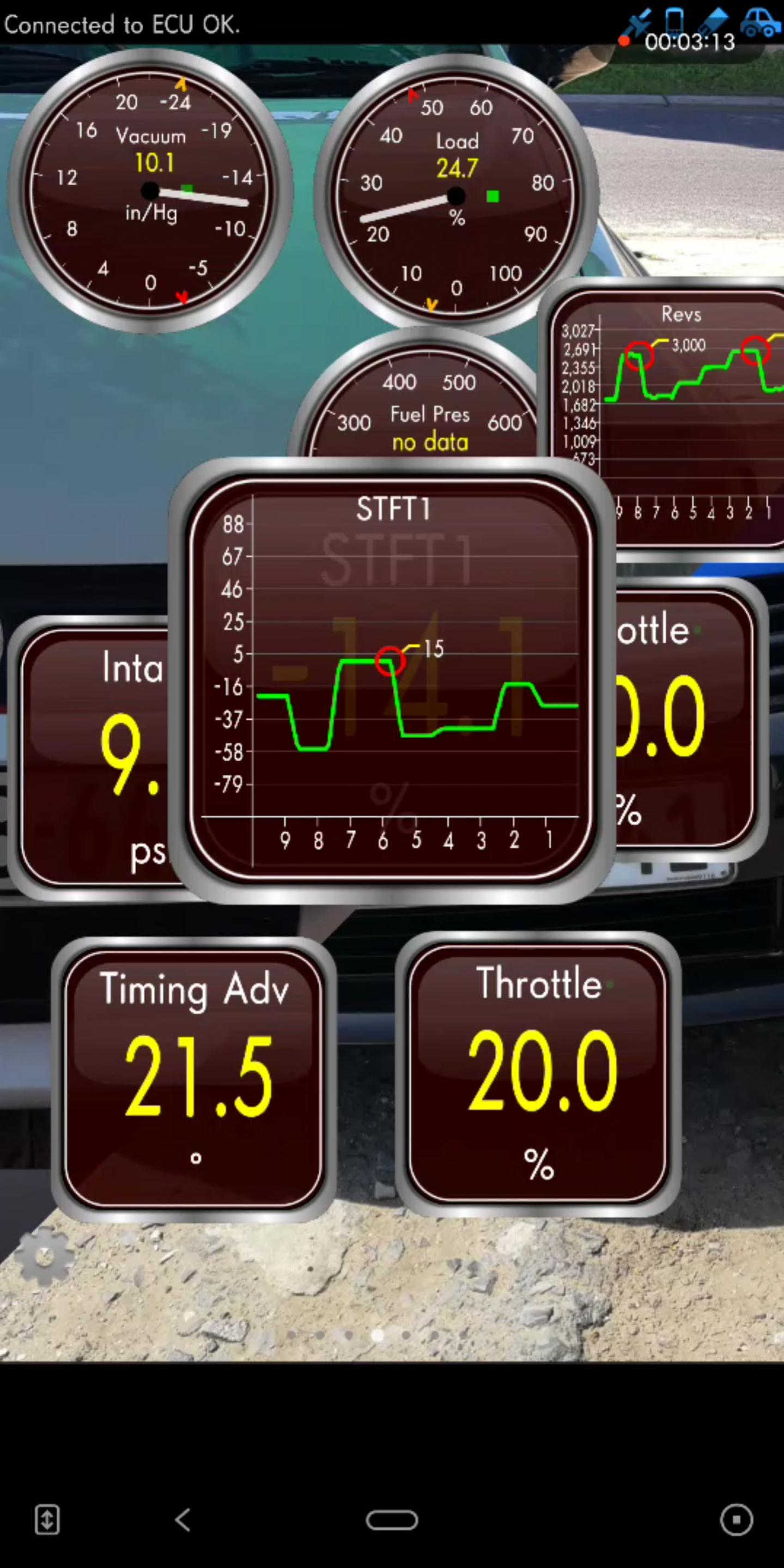

Hi.
So yes it is exactly the same as mine. It will go to 1100 then drop and go back up to 1100 but then have a unsteady rev. Even at a certain rpm it will drop abit and smoothen out then back down and smooth for a while and so on. This manifests in acceleration too.
Yes only on hard acceleration and no smoke on startup or hot startup. And doesn't smell of oil. More fuel. Dry exhaust,no oil in exhaust and carbon soaked oxygen sensors. See my short term fuel trim and O2 readings here.
