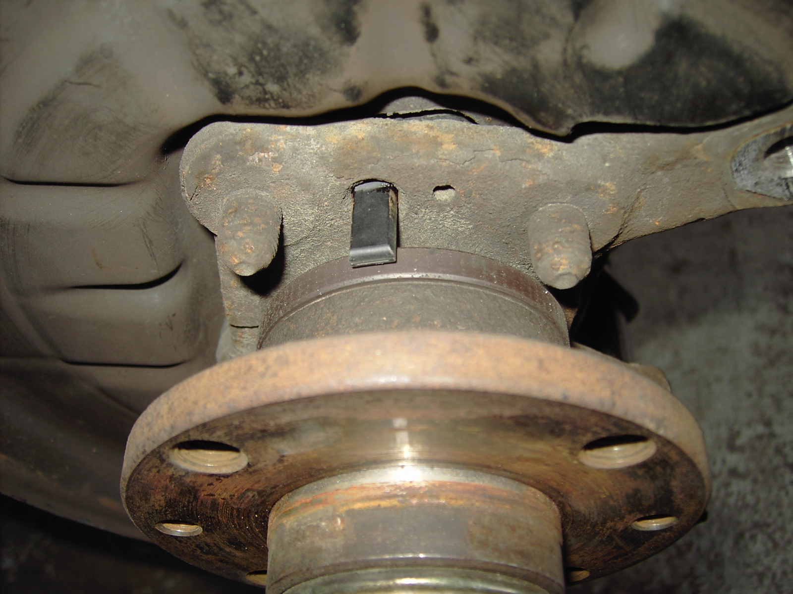

Managed to hit my rear hub ABS reluctor ring (magnetic rubber composite) with the wire rush whilst cleaning the hub stub-axl bolts for removal,
,so I could replace the rear disk backing plate - result is ABS warning light now coming on so looks like a new hub/bearing assy required, pity as these are still almost new having replaced them just last year. Pity I cant just get the reluctor ring itself - or can I? - now wishing I'd kept the old hub/bearing assy's when I replaced them, the ring off one of them would have pulled me out of a hole, an expensive slip of the wire brush...
Anyway I'm hoping the ABS warning light will go out during first drive cycle once hub is replaced.
