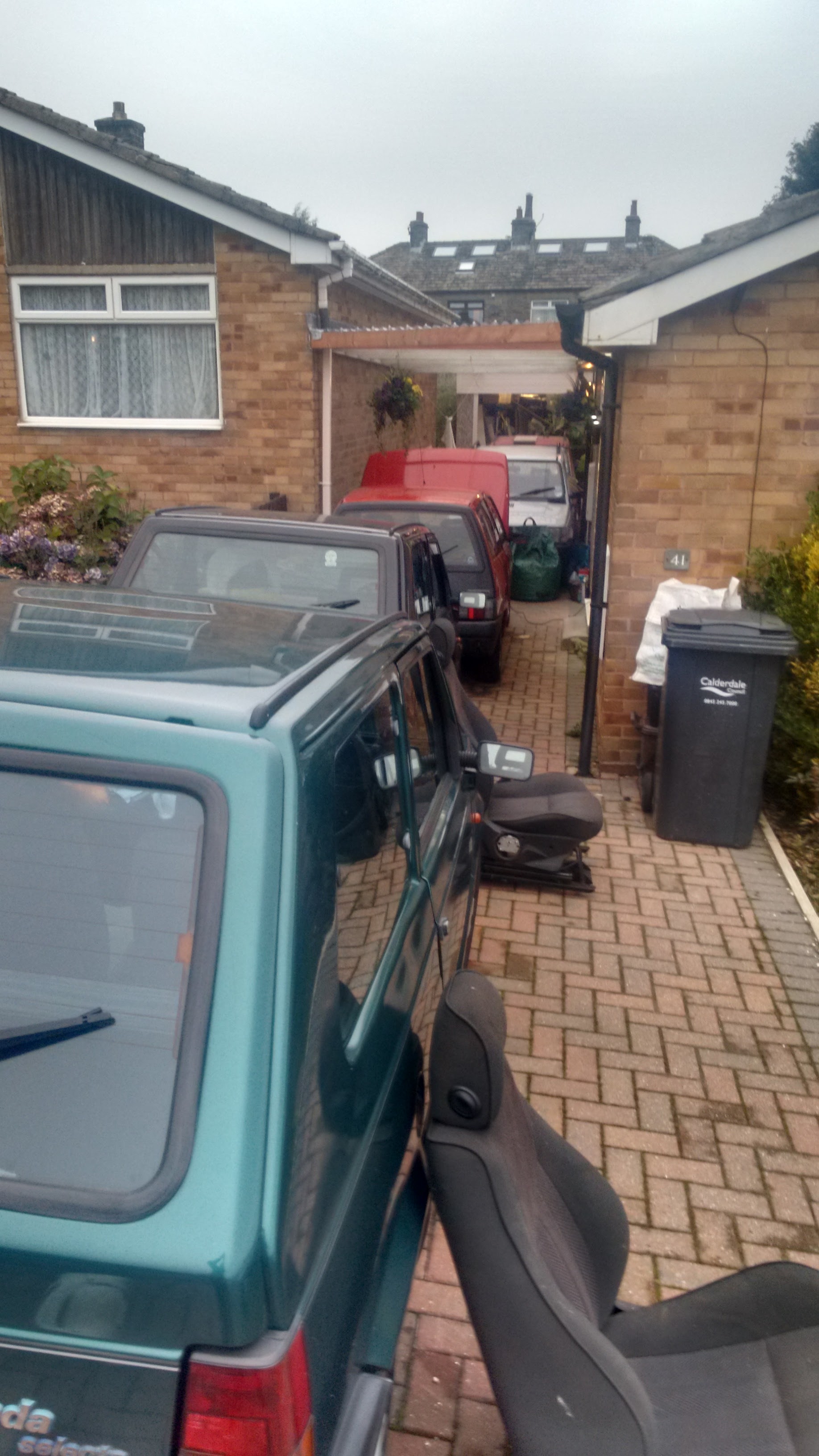

Thanks again all. Got some replacement seats yesterday for the grand ol' sum of £18, along with a new o/s wing mirror for a fiver :)
