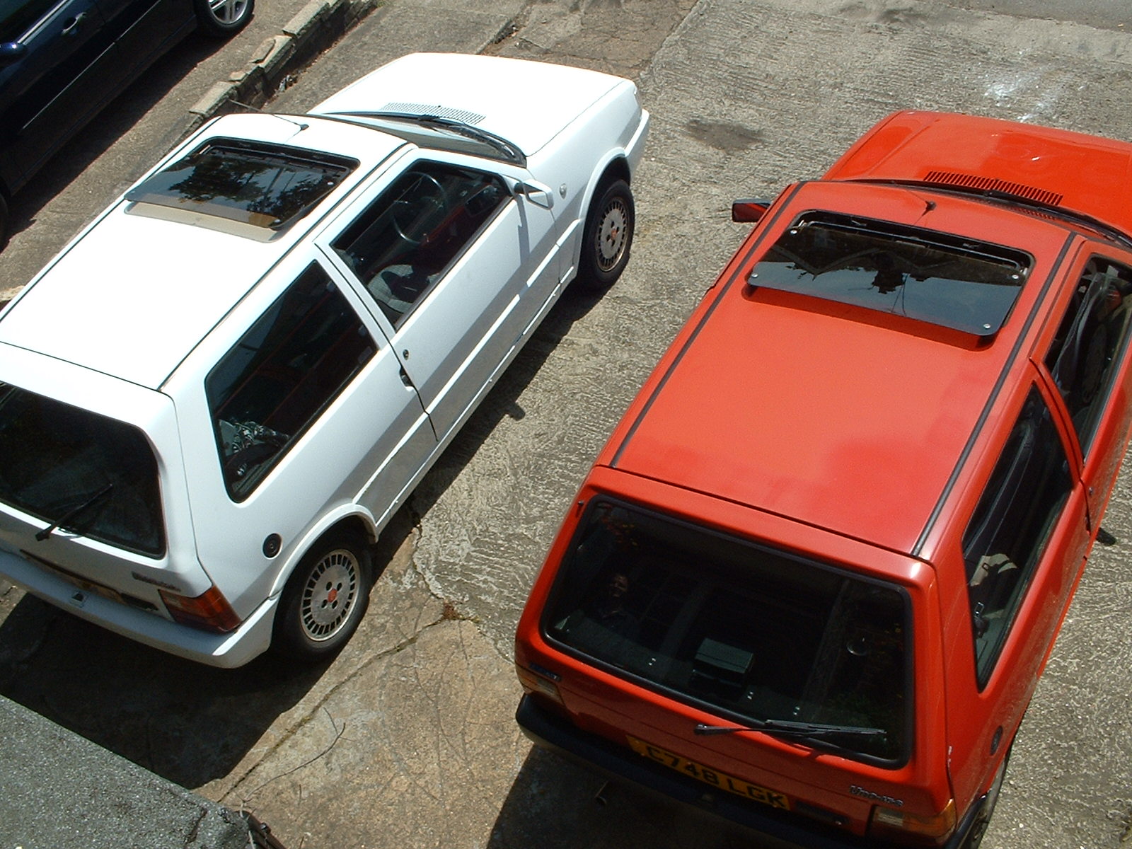

When you have some time it might be a good idea to take out the interior roof lining and maybe the sunroof and check around for any signs of rust. Take off all the rubbers and even if there is no rust give the metal lip some extra paint and rust preventative oil or similar. Also give some extra paint cover around the inside of the roof back about 50 -100 mm from the sunroof opening.
While the sunroof is good, these cars have a foolish design for mounting them and they rust around the sunroof. I have 3 here with sunroofs in them, they all have the cancer around the sunroof. I will take a picture and post it. Oh, and on two of these cars I can find no rust anywhere else.
Thanks for the advice. I could do with taking the headlining out and painting it or something as it has the dreaded dust producing desease. I can have a good look at the roof then.
