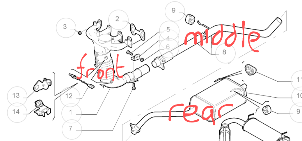

I got a cheap mk3 panda for my first car, its been great fun to use and drive but I am very aware of the exhaust, which on its MOT advisory has the front and rear listed as leaking a bit.
I've looked through the engine bay and can see that the front is definitely very rusted.
I've taken the car to a garage and they have said there are no issues other than that, but they said that they can only replace the rear exhaust, and that the front WILL NOT be replaced by anyone. Basically that the way the exhaust is the engine rests upon it or something and is dangerous to do? (roughly what he said from memory)
This is the first i've heard of such a thing and have been unable to verify this is the case.
Obviously i'm not a mechanic so I don't know but the engine seems small enough that I don't see why it couldn't be done
Is this definitely the case/have any of you had to do/get a front exhaust replacement? if so is it worth doing or just using the car till it dies. I got it for very cheap so it probably wouldn't be the end of the world if it only lasted a year but i've grown fond enough to be willing to take it to have that done, especially before i do anything else.

There are three parts to the exhaust system; a combined manifold/catalytic converter at the front, a centre pipe with a short integral flexible section at the front, and a rear box silencer with an integral short pipe section at the front.
The front manifold normally lasts the life of the car; it's replaceable but expensive. The other two sections are just mild steel exhaust parts and are commonly replaced together. Separating them is likely to be difficult/impossible, and if one has rusted out, chances are the other will have also.
There is a fixed rigid two part bracket at the front, which firmly secures the cat to the transmission housing; this is known to rust away and should be replaced if there is any doubt about its condition. If this bracket is compromised, the whole exhaust can flex and put enough pressure on the manicat to crack it and break its mounting studs; if that happens, you're facing an expensive, awkward and non-straightforward repair.
Generally speaking exhaust replacement involves replacing the centre and rear parts.

1.2 bore size is different to 1.1. Get the right size. Any garage can easily do the echaust. Its a simple job.
I think something got lost in the translation from the mechanic and here
Any part of the exhaust system is replaceable
And is easy for a garage to replace
Front, middle (centre) or rear
It's rare for the front to fail, unless it cracks due to impact damage
Advisory on an exhaust rear (back box) is common
leaking at the front is commonly the flex joint which is part of the centre section
What happens if you put your hand over the rear of the exhaust while it's running, does pressure build up can you hear where it's leaking
