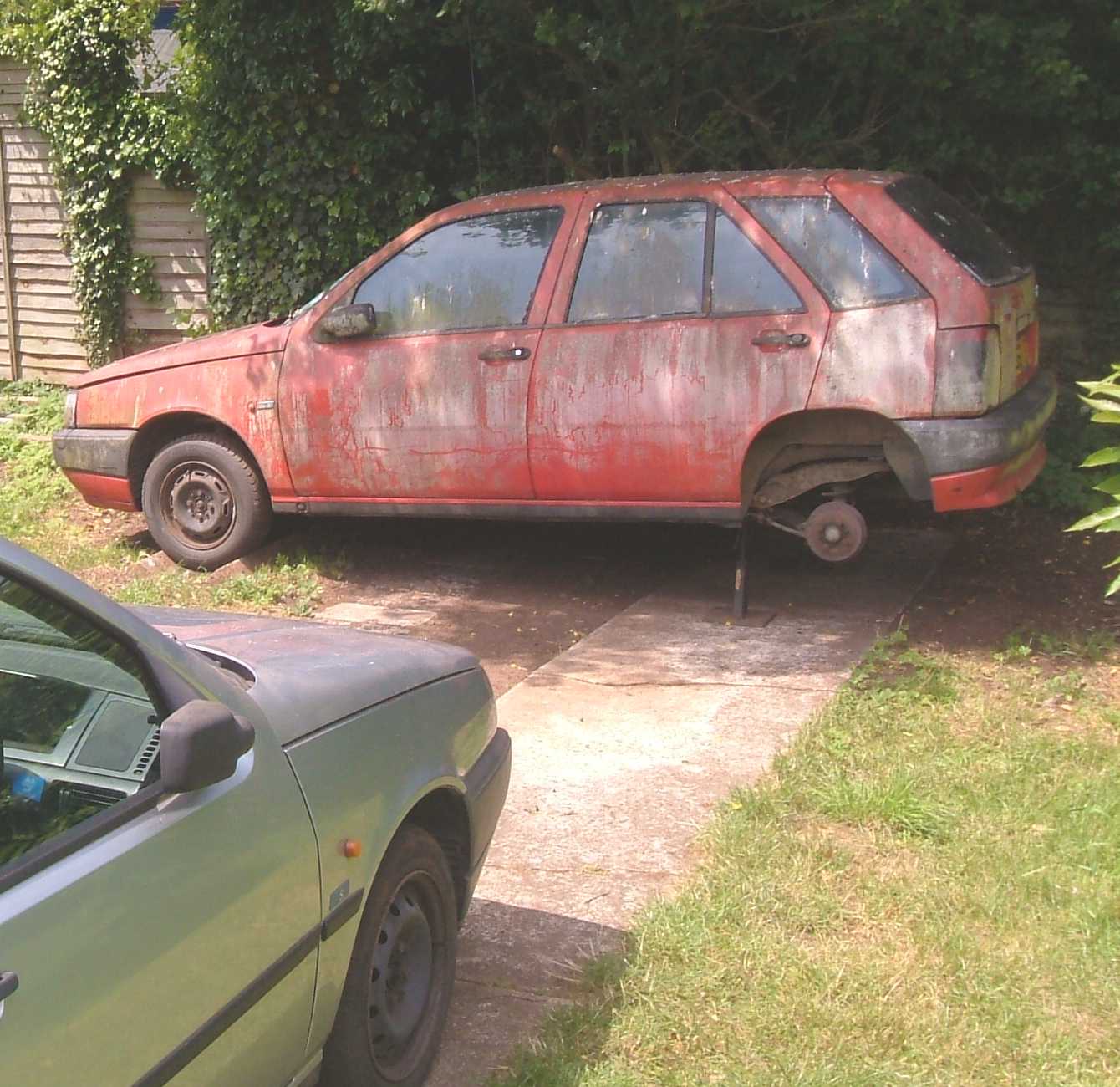

<<17>> i am doing RSF related trialling work on the 1992 red tipo in the picture, which is in theory a scrap car, to make it easy as possible when the RSF work starts on 1993 silver. 1992 red is anchored in place with front wheels in the V of a pair of half buried concrete posts and petrol tank is very soon to be lowered now that everything has been disconnected (a long and difficult job). then the RSF will be stripped before lowering it down. 1993 silver, sneaking into picture, has been made mobile (after clutch pedal initially stuck solid, for reasons unknown..) and is looking dusty in the daylight after just having been driven out of garage for the first time in 2 years.

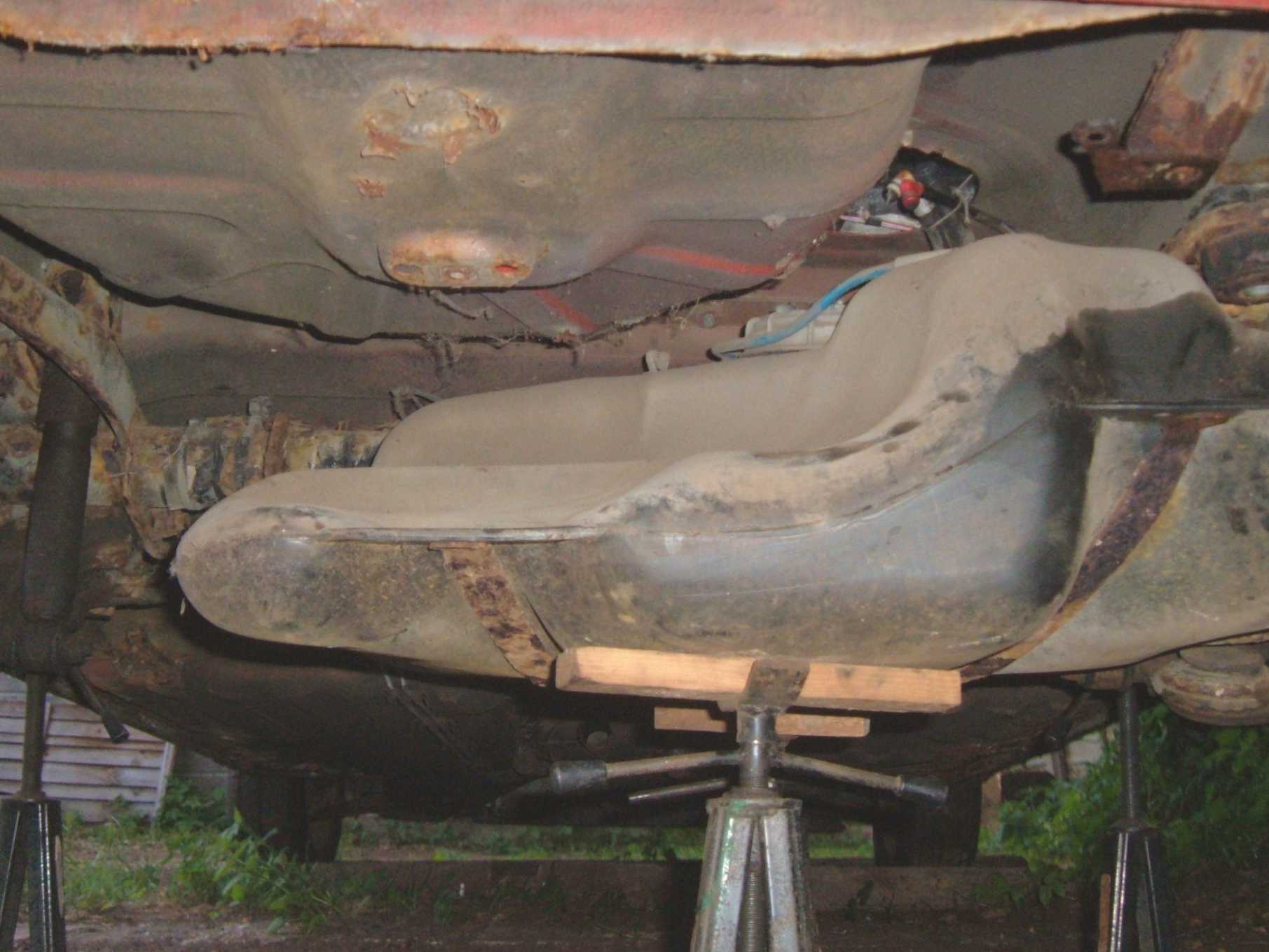

<+>photo-below<+> i include a random picture just to show how much dust hides on top of your tipos fuel tank! also just revealed is the blue fuel pipe (goes to roll over cut-off valve?) that came as a complete surprise after 3 pipes and 2 electrical plugs had already been disconnected from top of tank! this 4th (hidden) top one not mentioned specifically in the porter manual.. so shhh! i guess we must call it a 'secret' connection.
whooaah! 3 is enough 'secrets' for one post :cool:

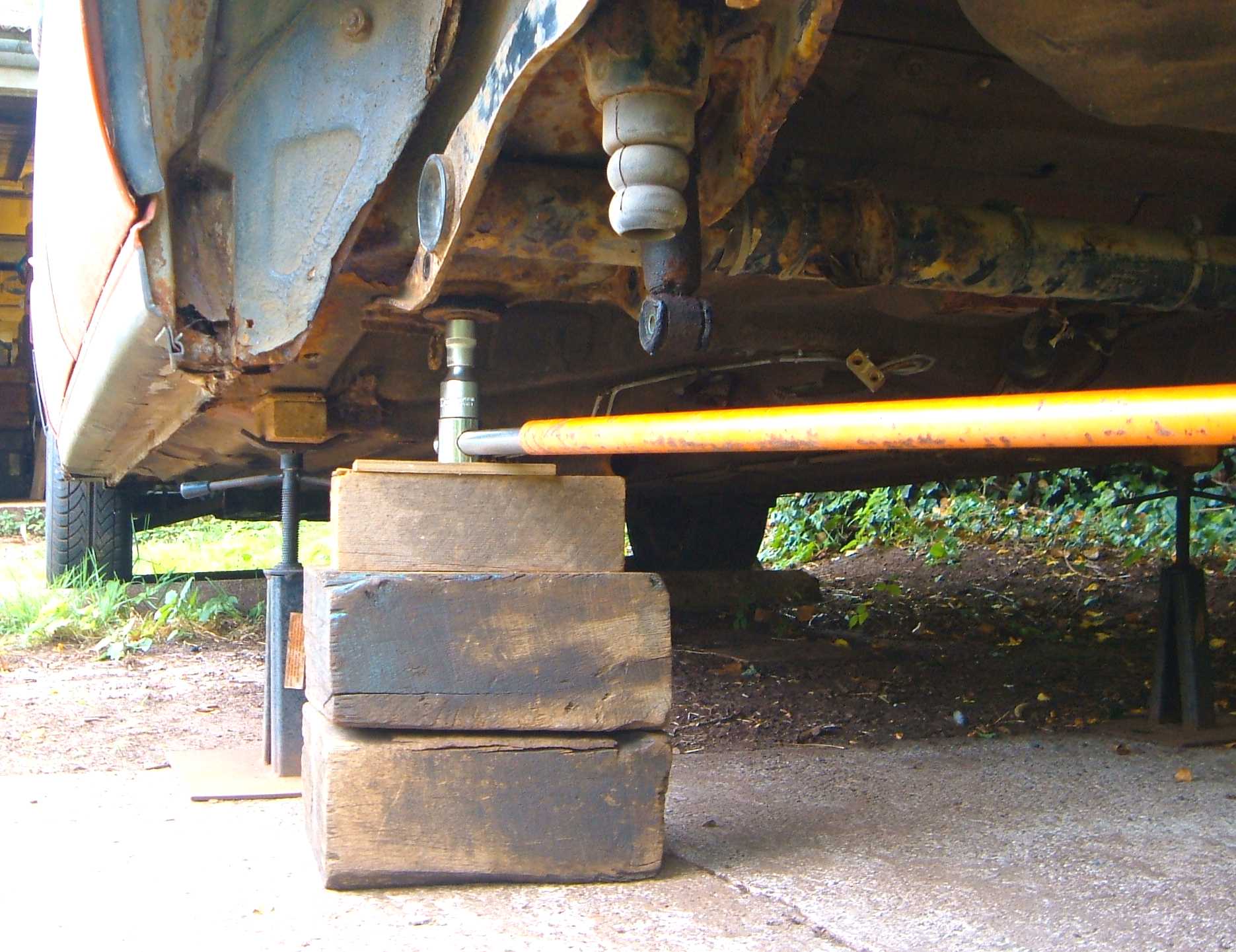

<<22>> red92 RSF is nearly dropped out now. very tough going getting all four bush bolts to turn, after 21 years set solid in there.. i really thought the captive nuts would be torn lose from inside the box sections. it took a lot of leverage and all were incredibly noisey before gradually giving up the fight and starting to turn smoothly..
<|>anyone-mad-enough<|> youll need an 18mm 6 sided socket, a 3/4" square drive T bar, a length of pipe on the T bar shaft and blocks of wood that will bear the weight of the car through the base of the T bar drive head, keeping the socket on the bolt head good and true.
<+>photo-below<+> me thinks best to try loosening those four bolts first rather than leaving it till last as i did, if youre intent on landing your RSF. youll not then have the possibility of a 'wont budge' situation confronting you after labouring for hours on all the other associated stuff.. silver93 patiently waits for further progress to be made on the previously mentioned RSF plan A.. red92, helping with RSF plan B, is theoretically a scrap car, but will keep options open for that one just in case i can find time to do the work needed and especially if i could put a diesel engine and transmission in, instead of the 1.4 ie one, some how or other eventually.
