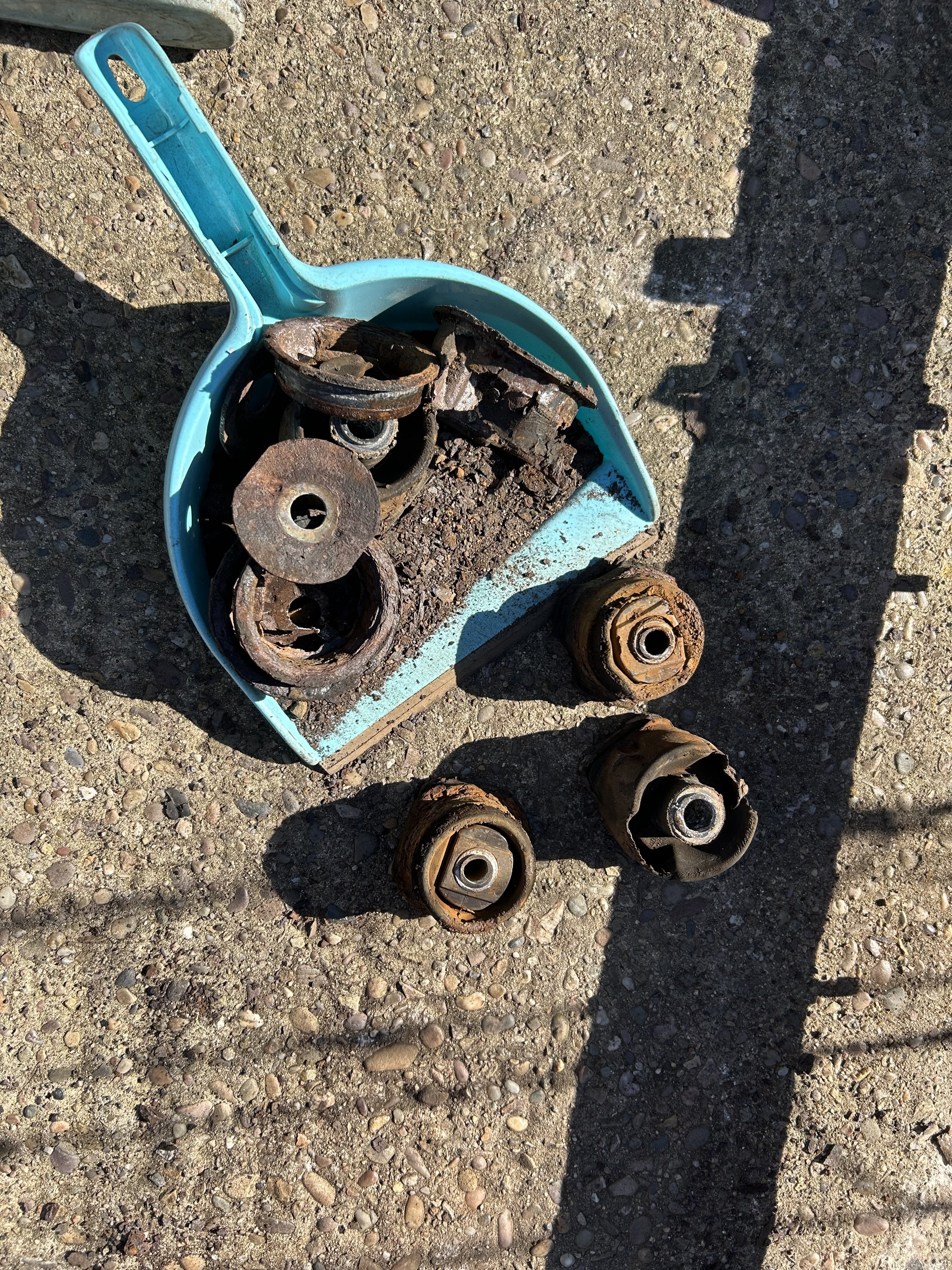

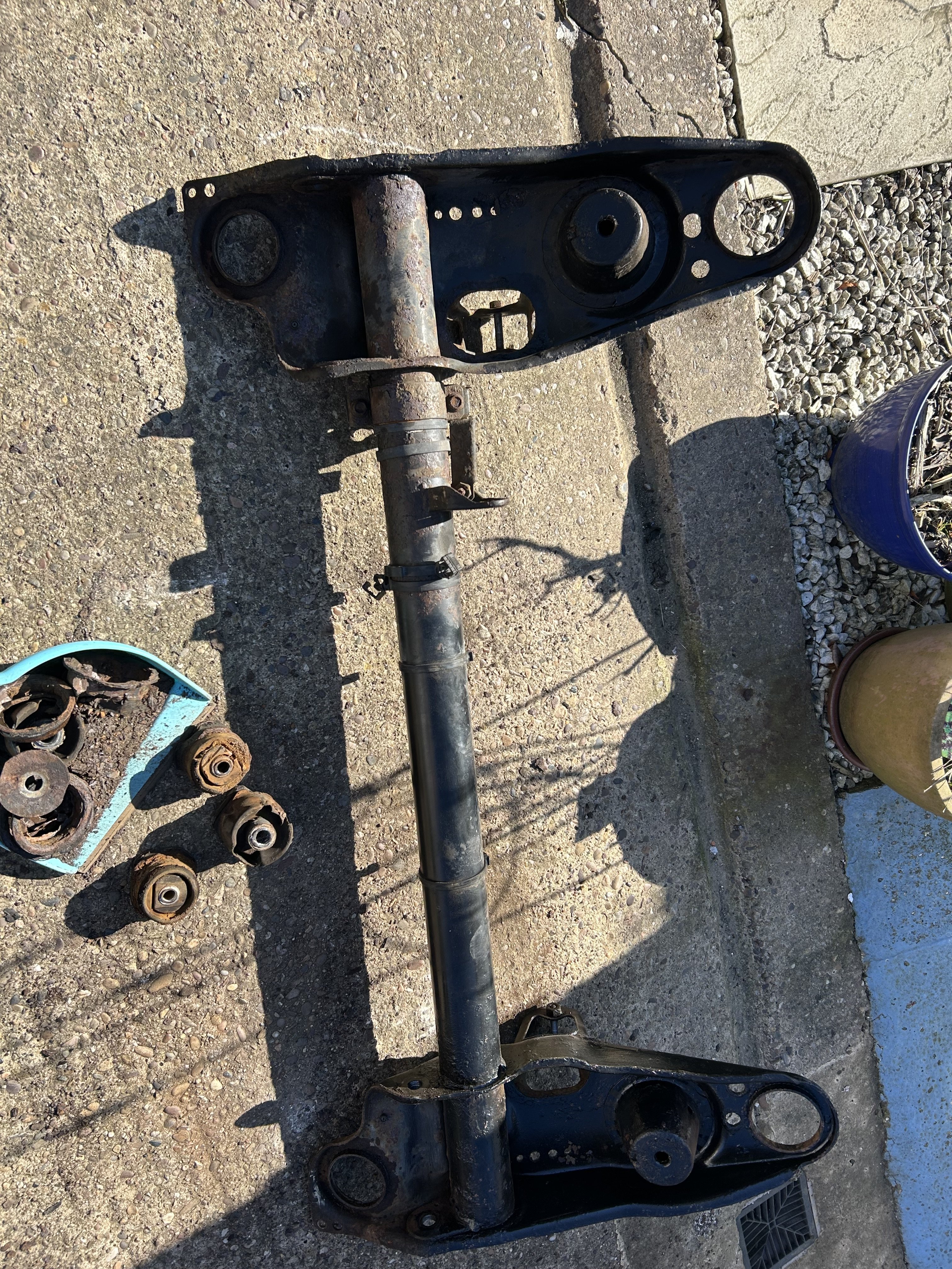

Still in the very long process of getting my 93 Sedici back on the road. Need to do some more welding (surprisingly!) at the back and will be easier with the rear subframe out the way. The bushes all look pretty rough but can’t see a definite answer as to whether they are the same as the Mulipla ones which seem readily available. The rear most are definitely the same parts from the part numbers but from ones don’t seem to be listed for the Tipo. I can’t imagine why Fiat would use a different part as the subframe was identical (?) on the Tipo/145/155/Coupe/Brava etc but want to be sure I’m not heading for a heap of trouble before I undo things.
Has anyone changed them or have any suggestions?

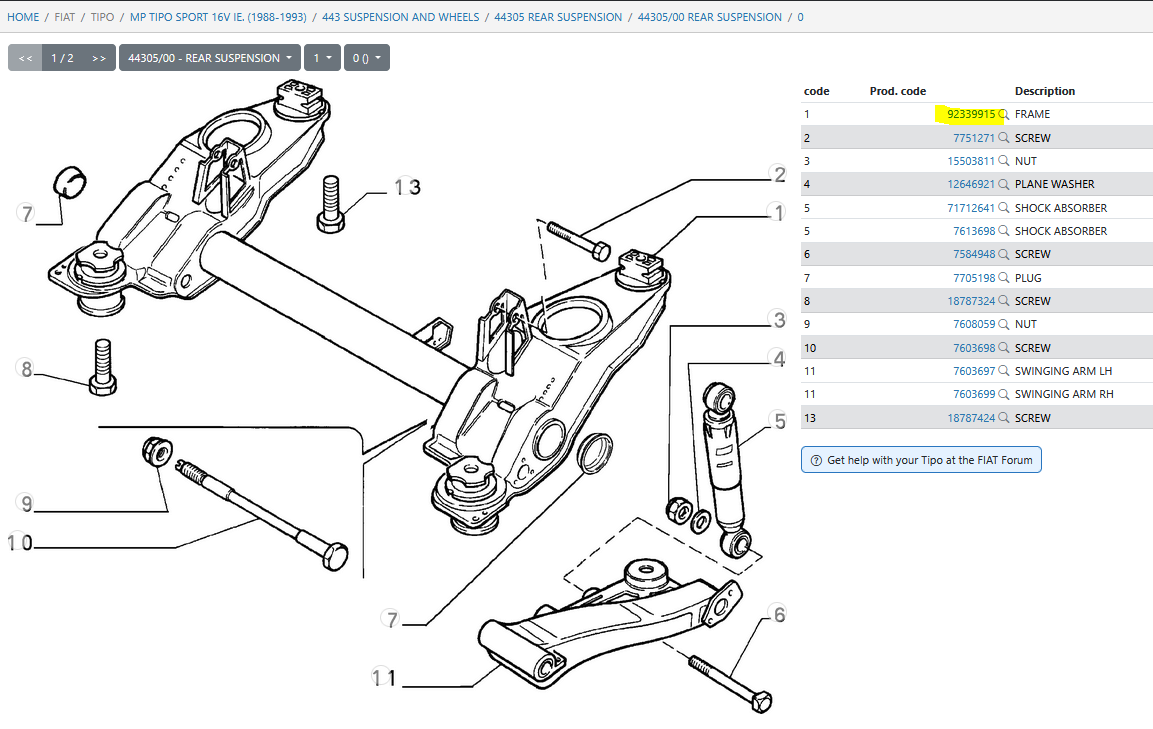

No idea what part do you call the rear subframe. Looking at ePER here might be the part marked 1 (FIAT P/N 92339915):
When you check the part details, it's listed only for the Tipo/Tempra.
Looking at the same part on the Alfa 145 it has the part number 92339898, which is different. And this one is listed for the Bravo / Brava / Marea / Lancia Dedra / Alfa 145 / 146.
Remember than the ePER diagrams might not totally reflect the exact real view of the part.
And have in mind that I might have picked up the wrong model in ePER, however I picked the 16v ;) It's better to check with the VIN of the car. Usually searching for the part number over the internet can give us some hints, but even specialized online shops can be mistaken.

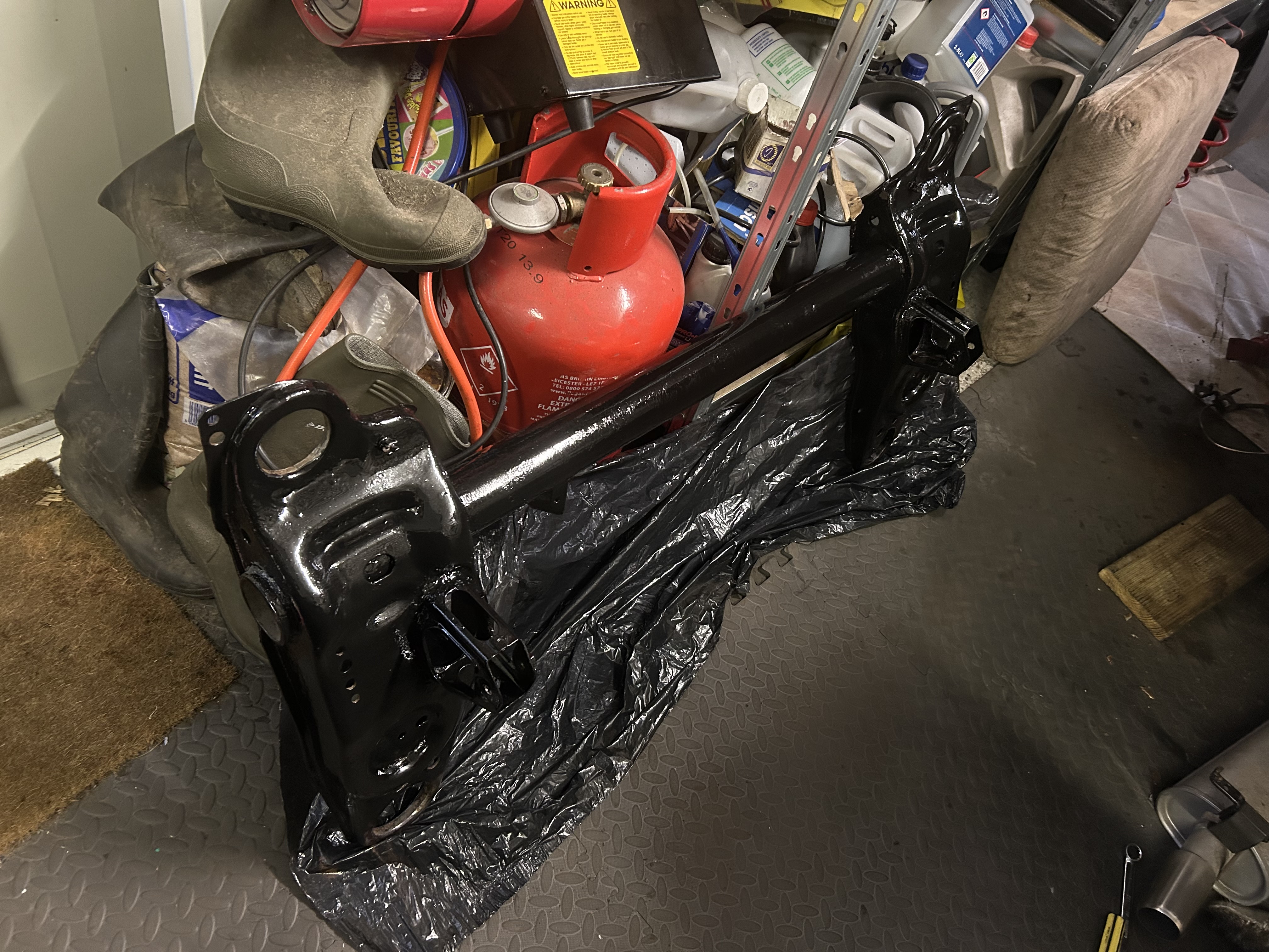

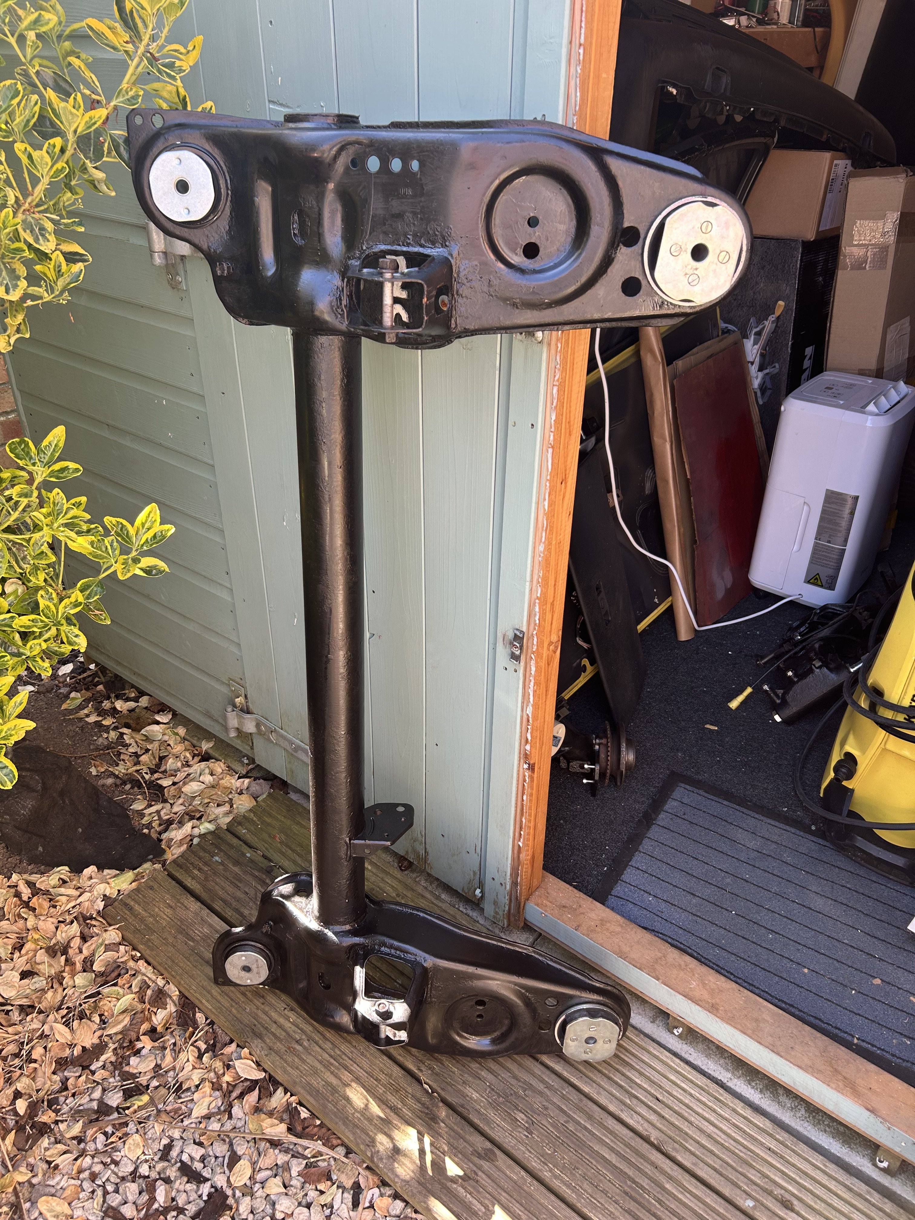

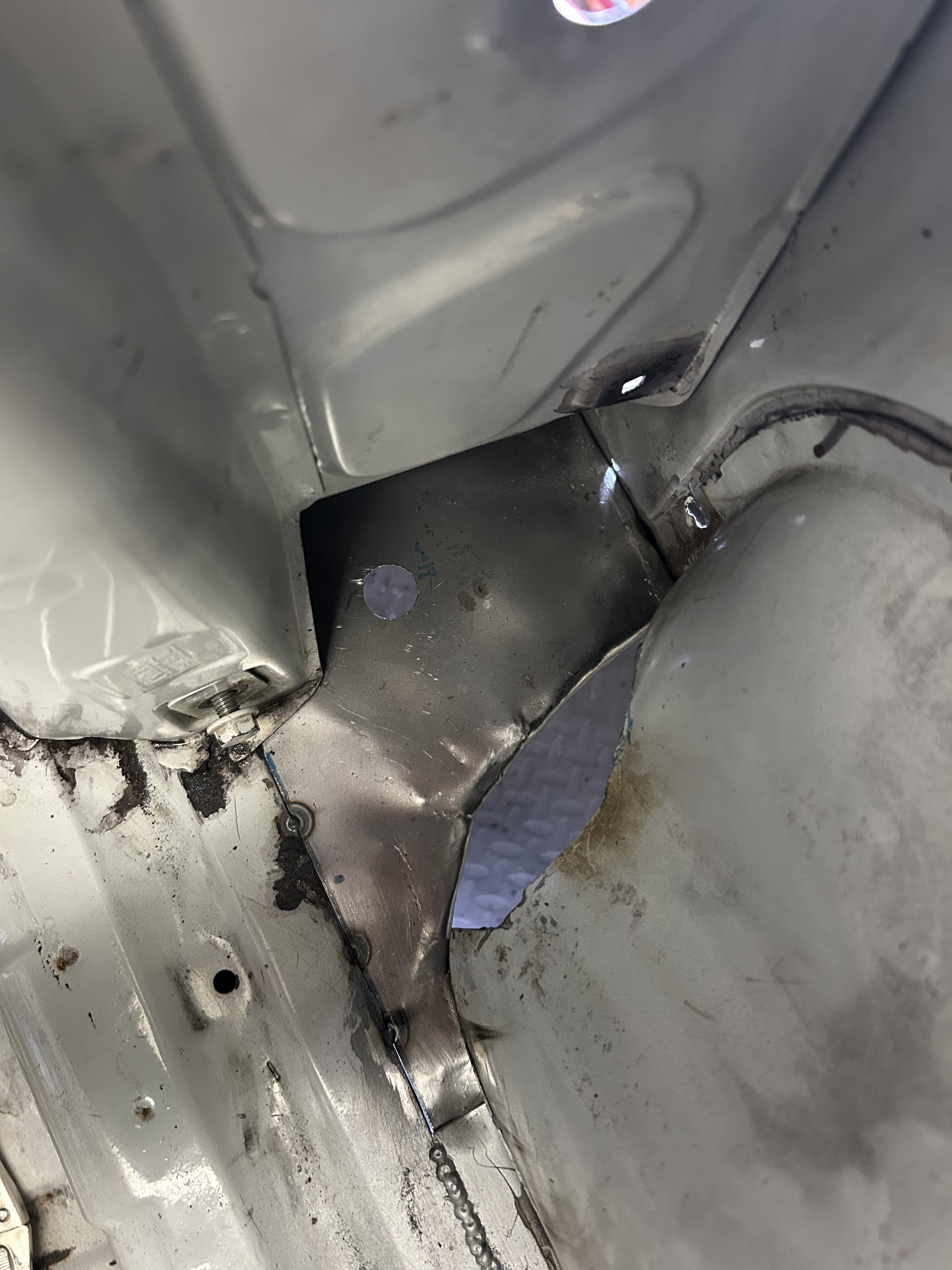

Finally managed to get all the correct bushes and a puller set with a sleeve that was big enough for the rear most bushes. Actually goes in quite easily with the right items and tools…!

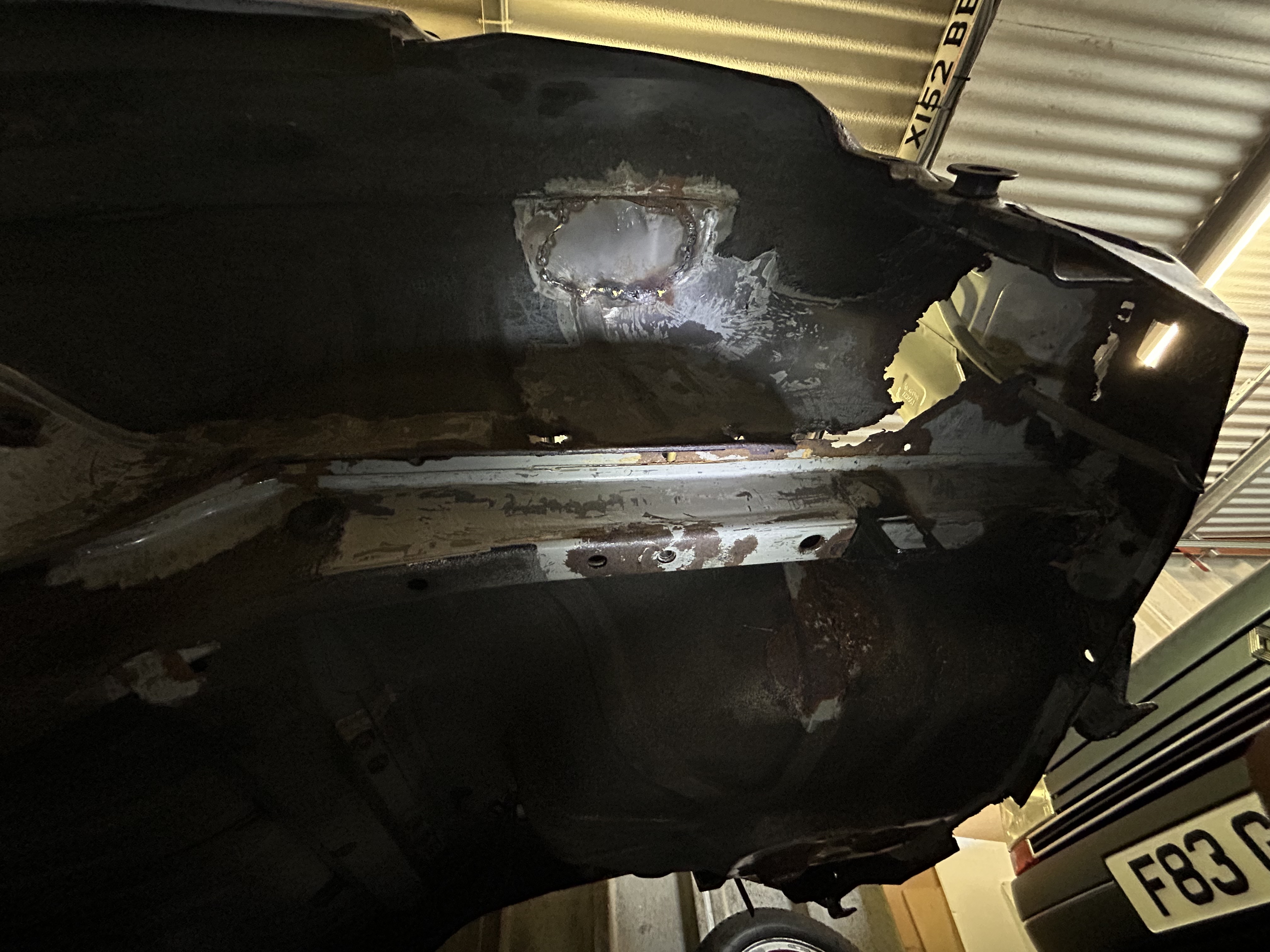

Just the rest of the boot floor and wheel arch welding to do and it can go back under the car 😒
