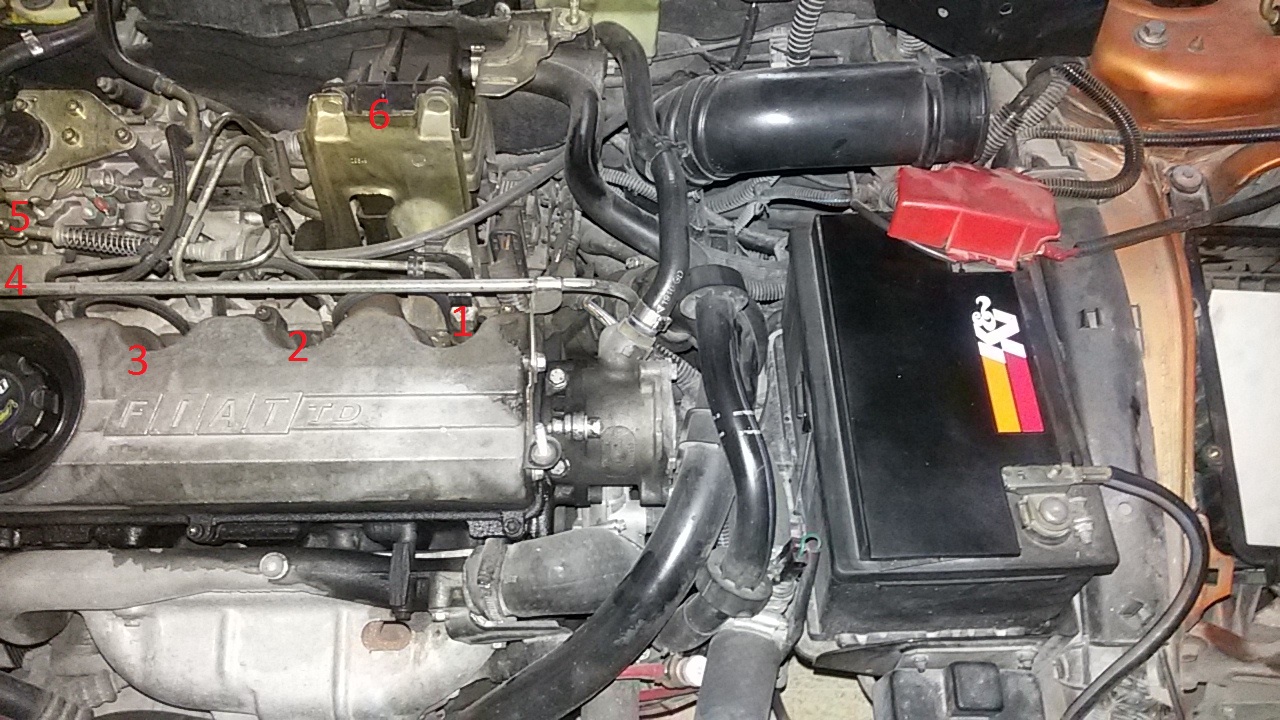

Soo, an update on this thread in case anyone else is in the situation to replace the glow plugs, my issue was getting worse over time with 2 out of 4 glow plugs dead. The job is not an easy one but not impossible, took about two hours and two people (one of which is pretty experienced to do this)
First things first, remove the battery negative terminal, remove the fuel filter (makes things a bit easier) and remove the three 10mm nuts from the oil breather box (black box thing marked no 6 in the picture) and push the box where the fuel filter used to sit, no need to remove it completely. Then remove the nuts holding the bracket for the oil breather and this should give easy access to the first two glow plugs.
Removing the throttle cable gives somewhat ok access to the 4th glow plug.
The 3rd glow plug is the real problem but is doable with the right ratchet. The socket need to be deep enough to grab the glow plugs nut but the total height of the the socket and ratchet needs to clear the bracket sitting exactly on top of the third glow plug, it is not worth it to try to remove this bracket as this requires to remove the whole fuel pump assembly.

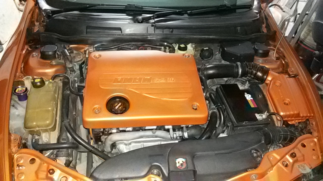

Well, I can assure you it looks much better in real life than in the picture, I already tried red and black for the engine cover and airbox and the colour coded ones looks the best so far (orange isn't really a great colour to match another colour to!). The front abarth sticker where the fan sticker used to be was replaced due to fan sticker being all torn up and looking really messy.
The last addition (about a month ago) is the abarth cap cover for the window washer bottle, I am still not sure about so I might remove it further down the road, the only reason I did it is that the original cap has a whole in it and is all cracked, for now, it looks better like this :)
