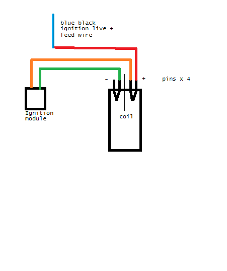

B bobish New member Joined May 16, 2015 Messages 7 Points 3 Jun 12, 2015 #1 Can anyone give me some advice about getting rid of the points and replacind them with a module on a Panda 750cc.Tried alot of companies but not having anyluck up to now.

VmanC The Panda whisperer Parked in the garage Joined May 6, 2009 Messages 5,830 Points 1,664 Location Alton, Hants. Jun 12, 2015 #2 A distributor and coil from a 4x4 is an easy swap.
Dragon Man I Void Warranties Staff member Parked in the garage Written a guide Joined May 7, 2011 Messages 5,372 Points 1,377 Location The East Midlands, Derby. Jun 12, 2015 #3 as Vmanc said.. this diagram should help: this is a bit more easy to follow. this is how it look on the car: Last edited: Jun 12, 2015

OP OP B bobish New member Joined May 16, 2015 Messages 7 Points 3 Jun 12, 2015 #4 Thanks for the helpbut where would I get the module?All the places I have spoken to do not do anything for a 750cc panda. Thanks

Dragon Man I Void Warranties Staff member Parked in the garage Written a guide Joined May 7, 2011 Messages 5,372 Points 1,377 Location The East Midlands, Derby. Jun 13, 2015 #5 just use the one from the 999cc panda.. they are the same engine. the fiat "Fire" engine.
OP OP B bobish New member Joined May 16, 2015 Messages 7 Points 3 Jun 13, 2015 #6 Dragon Man said: just use the one from the 999cc panda.. they are the same engine. the fiat "Fire" engine. Click to expand... Thanks for your help I think I have located the parts I need,Cheers.
