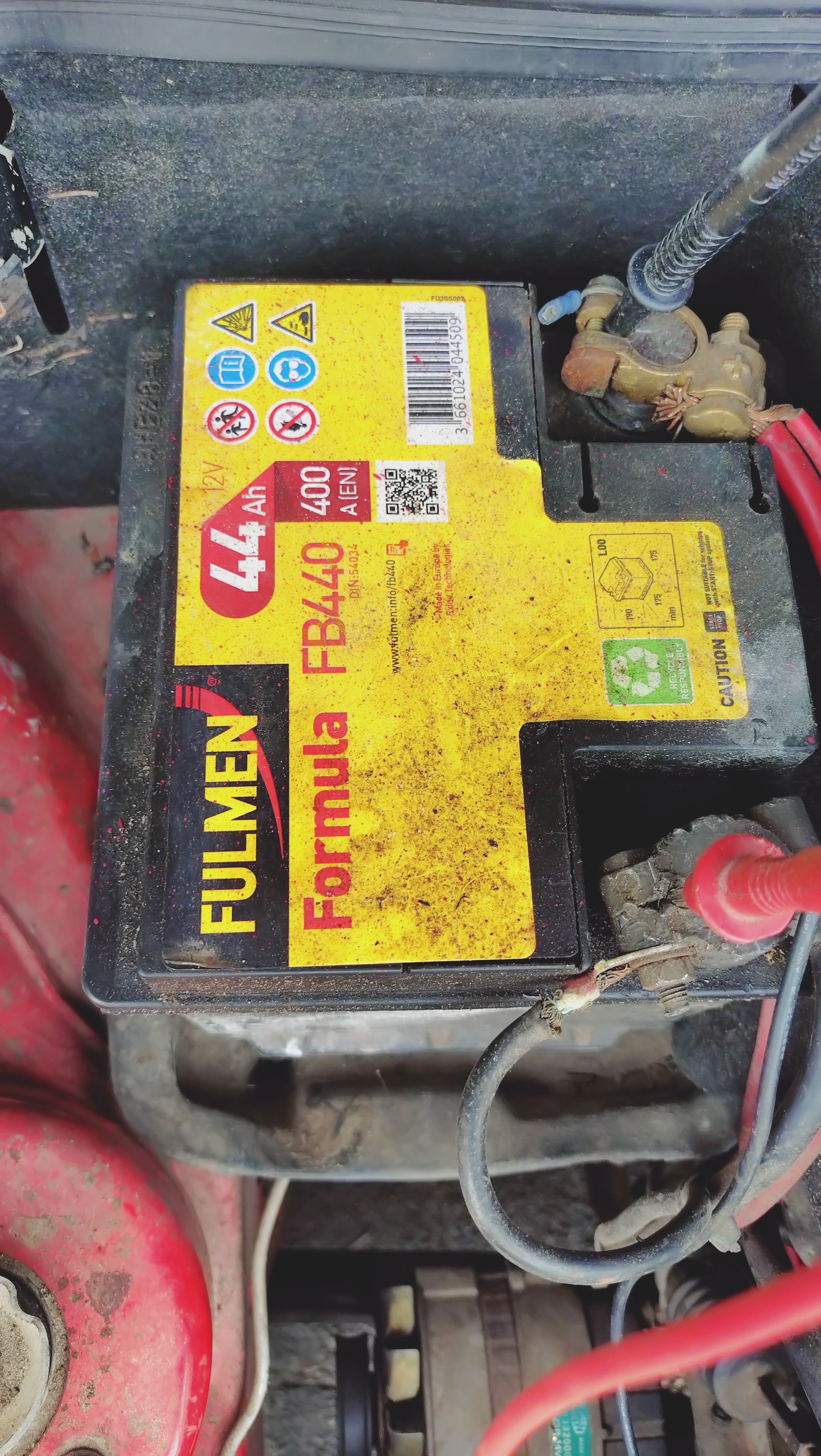

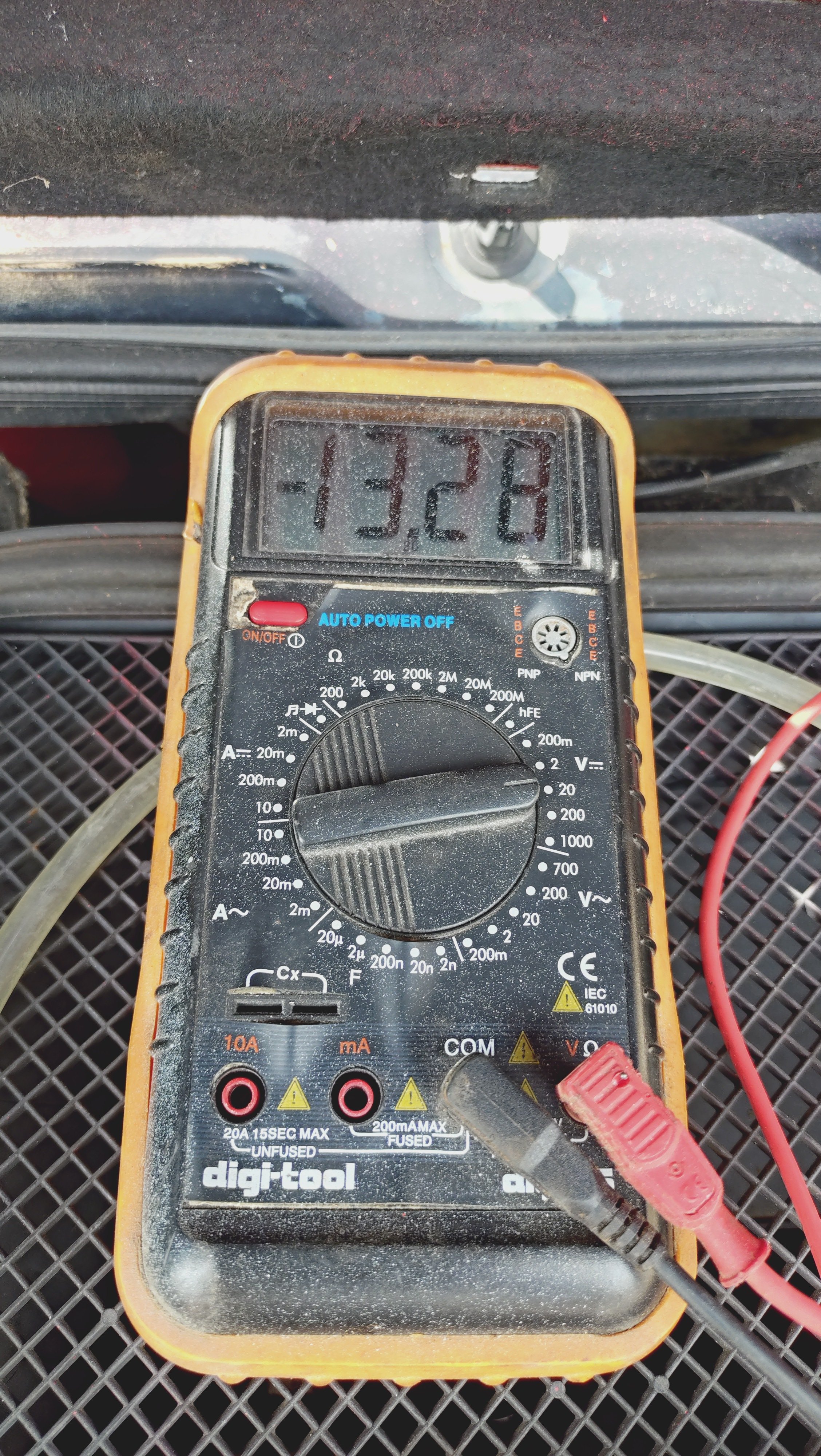

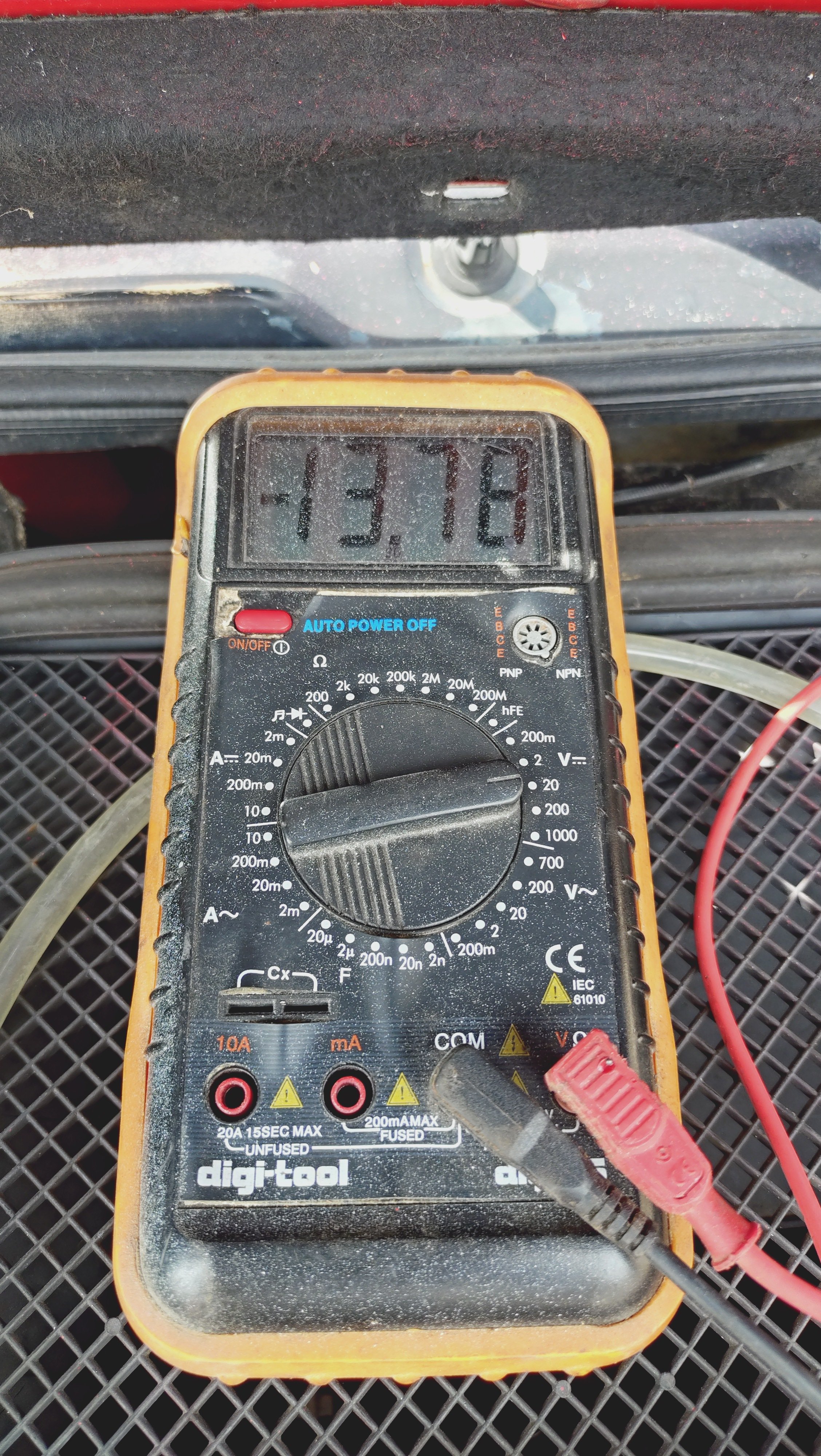

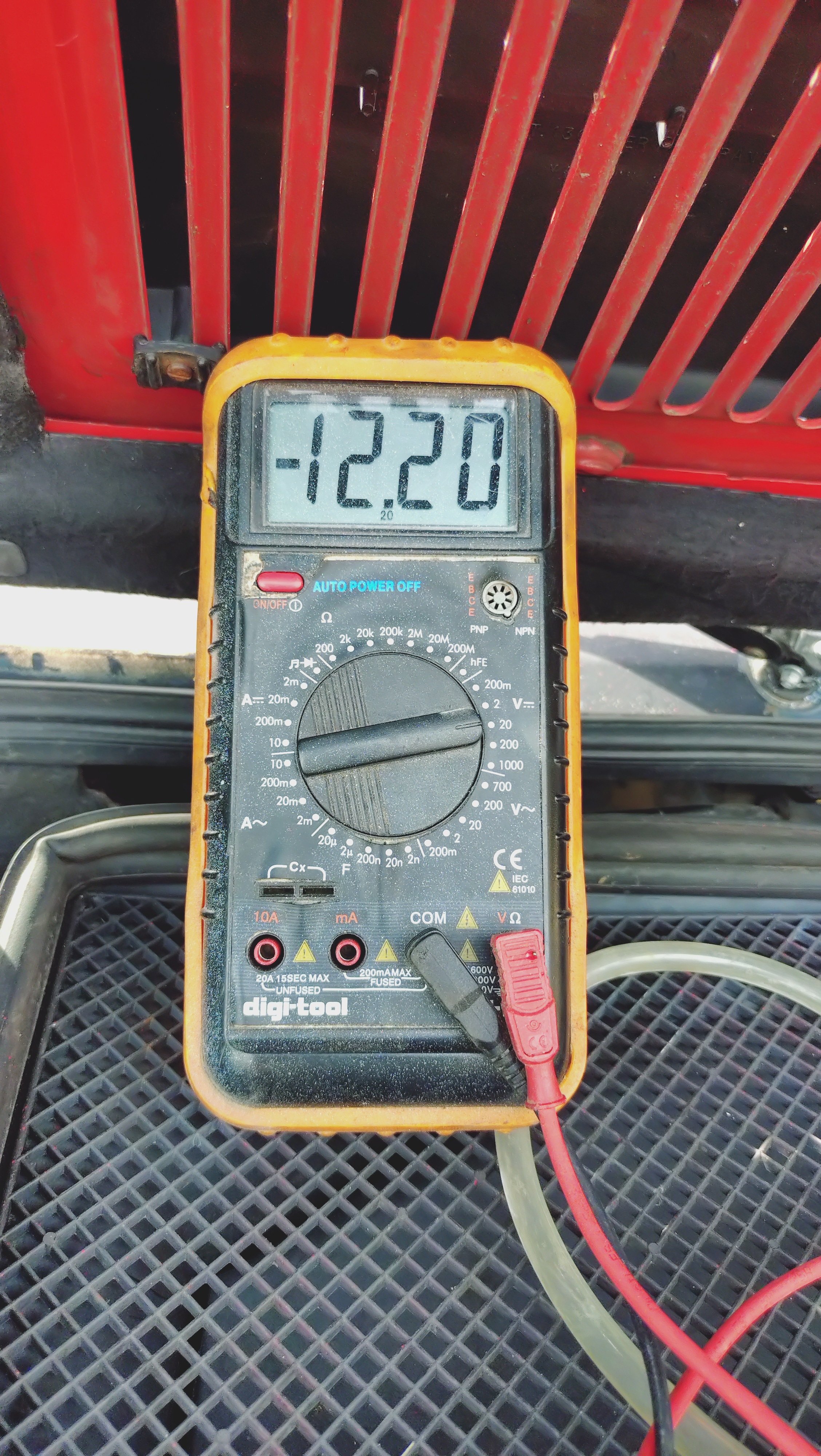

My 1987 panda 4x4 seems to me a little low battery voltage:
Engine off 12.2v / idle Engine 13.3 v/ rev 13.7v
To my information battery should have at least 12.4v off
Is battery and (or alternator) dying?
Current 44ah battery is installed by previous owner and a dont know age.
According to manual stock was 30ah
I want to install in future a winch. So if i need to install new battery I want be ready to power a winch
Will a 55ah battery like Varta blue cC22 or Bosch S4 002 be a good choice?

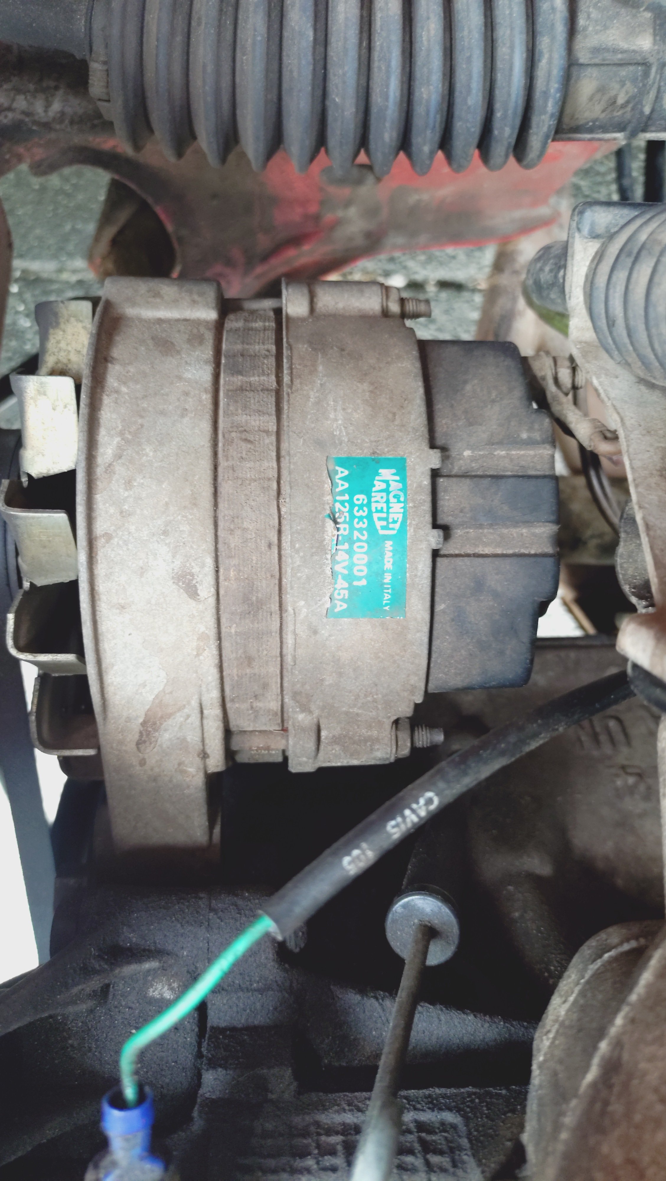

I have a spare alternator that looks new to me according to specs it can deliver 65a. Better to fit this to power battery when winching?

The battery might just be reading a little low because it's aged not because your alternator isn't up to it , a battery in good condition should have a resting voltage of about 12.6v (~30 mins after turning the engine off)
Look for a date code on the casing.
Any battery that will physically fit will work, and that physical size will be what limits its Ah capacity.
The alternator isn't related to the battery capacity per se, more the overall vehicle load.
I'd get the battery properly drop tested , and it'll probably 'fail' from that resting terminal voltage.
