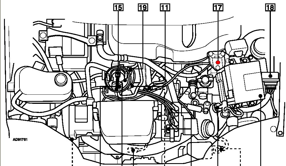

If its not a leaking head gasket again, it does sound like an air leak on the inlet side, these cause havoc to the idle...
I only skipped through this thread but have you made sure the pipe from the inlet to the map sensor [just by ecu] is sound? they can split easy and this will cause air to leak in under vacuum
It's a sort of block plastic box mounted on an almost triangular plate above the ECU: 1 wiring connector, 1 pipe.
item 17
it has a small bore rubber pipe connected to it, pipe joins at the inlet manifold where the brake servo vac pipe is, there may be another smaller bore pipe there too, check both for splits
