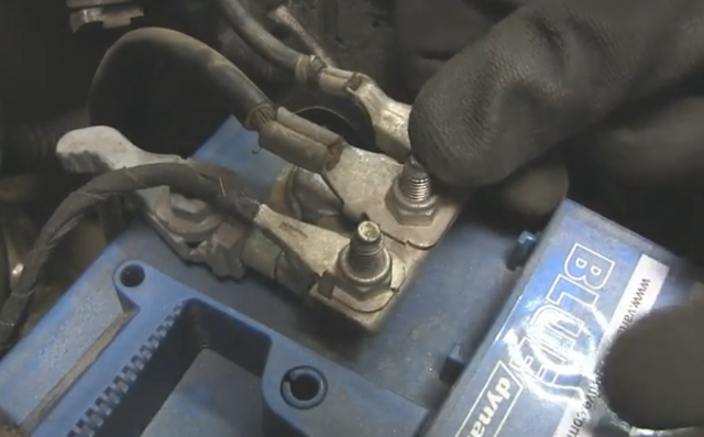

have you unbolted the two cables on top of the battery negative clamp and cleaned them up. One is the cable for the steering motor.

Yeah, done all of that.
The error code is c1002 which is for the torque sensor.

have you unbolted the cables on top of the battery negative and cleaned them ? picture below
have you tried a different battery ?
check the large 60A fuse for corrosion
