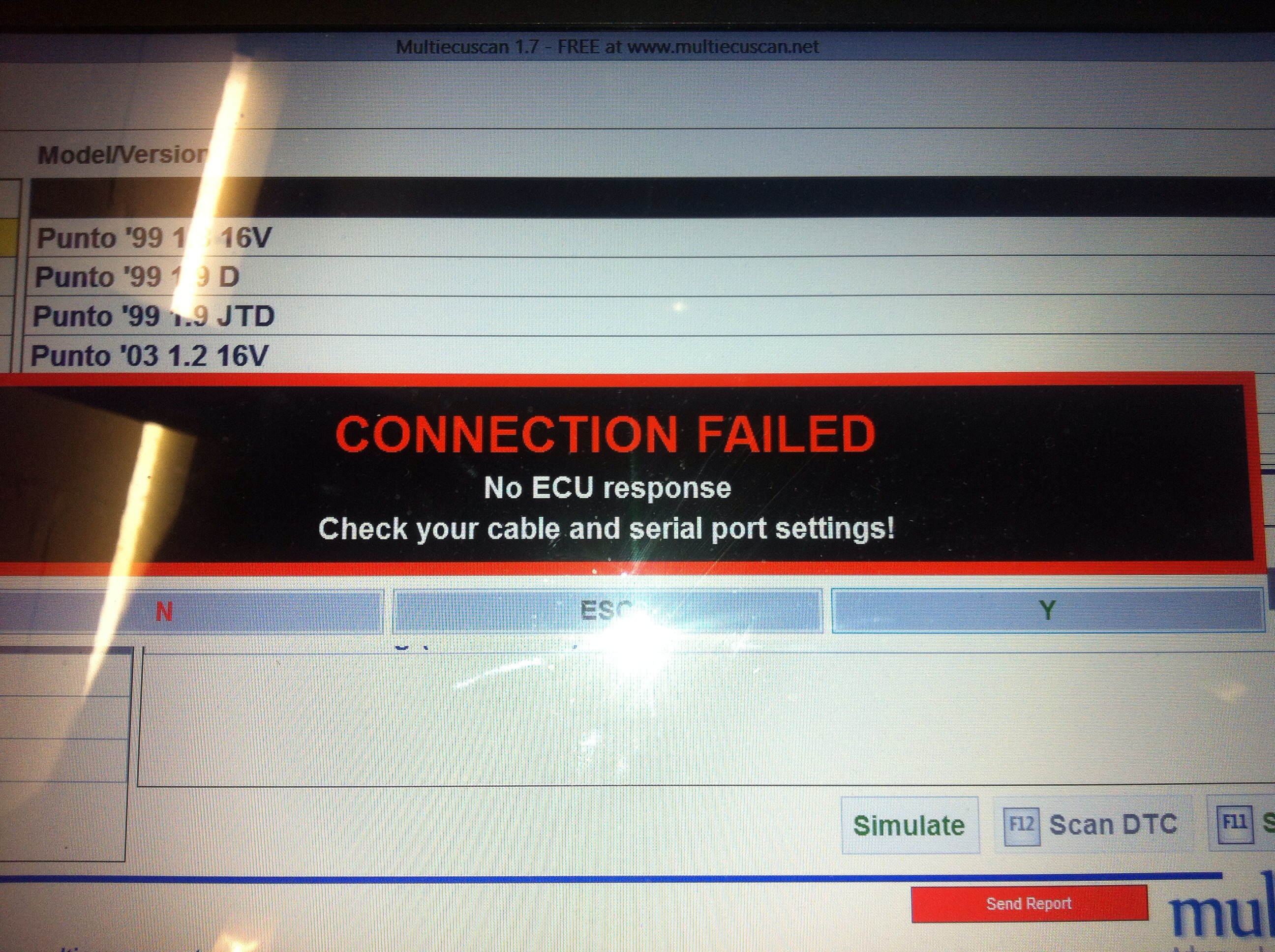

This guide is suitable for you if your airbag light is on and you cannot connect to the ecu through diagnostic tools.
If you have not attempted to reset the airbag light yet then first you should have a look at this video:
If you get this error when trying to connect to your airbag ecu then this guide is for you.

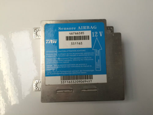

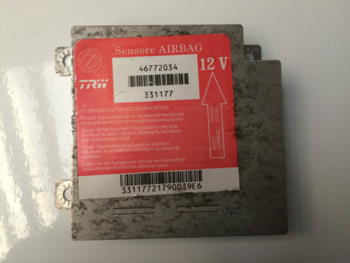

Your airbag ecu will look like one of the following (There are more around with different colour labels and serial numbers
To remove the ecu you need to unplug the cable from the side of it then remove the 3 bolts that attach it to the floor.
Once you have removed it you need to simply source a replacement from ebay, scrapyard or your local dealer. When getting your replacement its very important you get one with the same numbers on the front and with the same coloured label as this represents how many airbags are fitted in your car. So fit the wrong one and its highly likely the airbag will go off.
