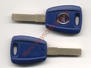

I have a problem to my 2008 Panda (1.1 gas): the key has not spin or very hard spin into start contact near steering wheel, so I want to replace it. But I don't want to replace it with another one but with two switces, one for ignition and one for engine start (or another combination). Problem is the chip from the key; how can I jump this for easy start ? Sometype of keyless start. Must be a solution ! Yes, I have electronical good skills.

Assuming the Panda using the transponder system, which I am sure it does, the chip in the key is tiny, it really is so tiny you wouldn't believe it works. It sends a radio signal to a receiver behind the barrel and if the receiver recognises the code the chip sends it will start the car.
So if you really wanted a push button start as longs as you keep the receiver where it is, and put the transponder (key chip) next to it you will be able to start it with the push button. The problem is so can anybody else.
It would also probably be difficult to bypass the immboliser altogether because it is apart of the ECU.
Yes, I understand; it was my first though, but my key is, like bellow, one single piece, so I don't know how to cut it
