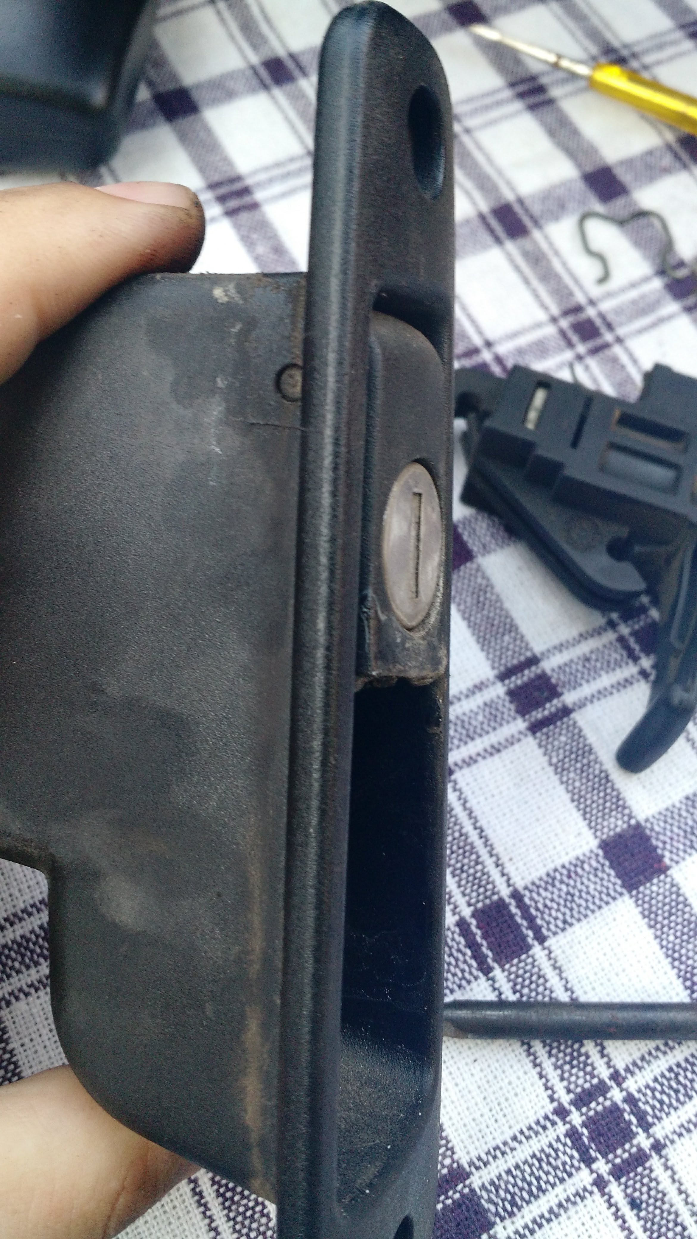

2. Dissasemble the lever
- you should see this
Press on the highlighted axis with a nail, a screwdriver or whatever works. Press on the LEFT side of the axle, AS SHOWN!
- once the axis is out completely, you can remove the lever by pulling it as you would open the boot and then pull it outwards.
- you should see (almost) this
Remove the safety wire numbered with 1 found in the place shown by the arrow.
- pull out the lock. You can use a screwdriver or, for the one with the correct key, use the key itself to drag it out. Push the key in, rotate 90 degrees and pull.
