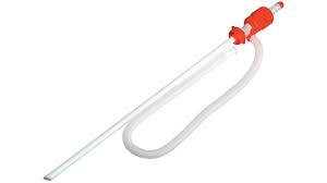

for a few pounds you can buy a syphoning tube with a simple pump on the top. Just done it on my car to clean up the top radiator hose which started leaking.
