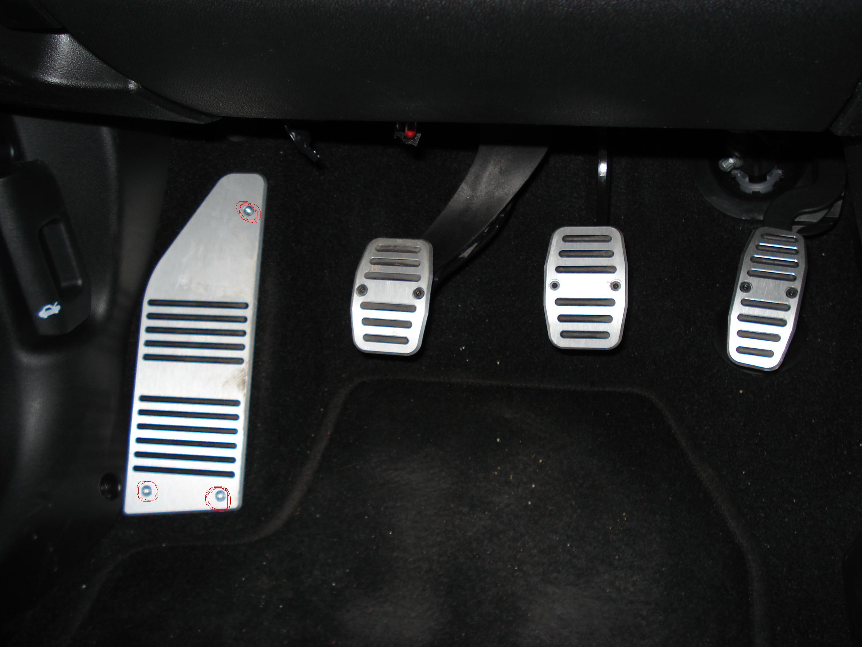

Does anyone know how to unscrew footrest screws?
Because, I have unscrewed one and I can't back the screw back.

But, that's for "regular" footrest (not for sport footrest).
As you can see on the picture, I have three screws.
I don't know how to screw it back.

I want to change original screws with new stainless steel screws. But the problem is that you have no chance to screw old screws back. So I have to use bigger screws, So, I wonder how are they originally tightened.
I don't know. I have to remove other two screws.
If you try put the first screw back, does it go loosely in, or does it not go in at all?
If the former, it may be there was a loose nut which you have now lost :cry::cry::cry:
If its the latter, then you may have a tuft of carpet or something blocking the thread on a captive nut. The solution to this might be to take the other two screws out. However, if its the loose nut problem, then it will only make matters worse, and it will likely be a "carpet (partially)out" job.

Thats what I thought, if he can't see the thread, there must be a nut there before but now dropped to the floor. nut insert time me think~~~:devil:

It makes sense.
But it's so stupid to put unfixed nut, isn't it?
Is it big problem to remove carpet out?
