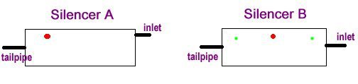

silencer A you can see its inlet and tailpipe are offset, you need to cut your hole at the part [red dot] that has the pipe in the centre, as this will be the section inside that has the fibre in
silencer B is a straight through type, cut your hole slightly off centre, if there is no fibre present then you may have a section at each end with it in, in which case cut where the green dot is
GREAT thanks very much!!!

its that backbox with inlet pipe offset(type A)

Once you start pulling the fibre, it should all come out, as its usually put in there as one long thread. if its the offset silencer, then ony one end if it will have the fibre in.
