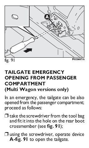

There's no setting to change the function of the driver's door switch panel. The lock/unlock button locks/unlocks the tailgate by default anyway. Your problem is probably with the micro switch in the tailgate handle that opens the tailgate. This has been posted about several times on the forum.
Emergency opening procedure for the tailgate as shown in the handbook is below.
You can download a Stilo handbook from the forum downloads section here: https://www.fiatforum.com/downloads.php?do=cat&id=5

Thanks Darren I hadn't looked into the micro switch as I thought on the active model it was not fitted.
