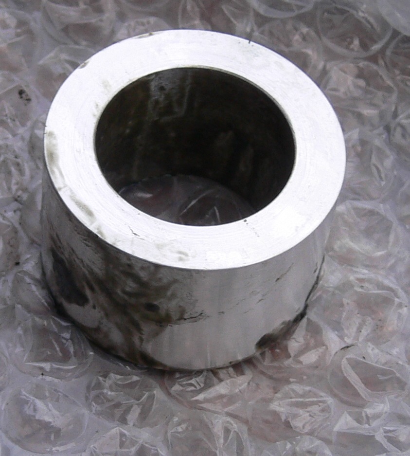

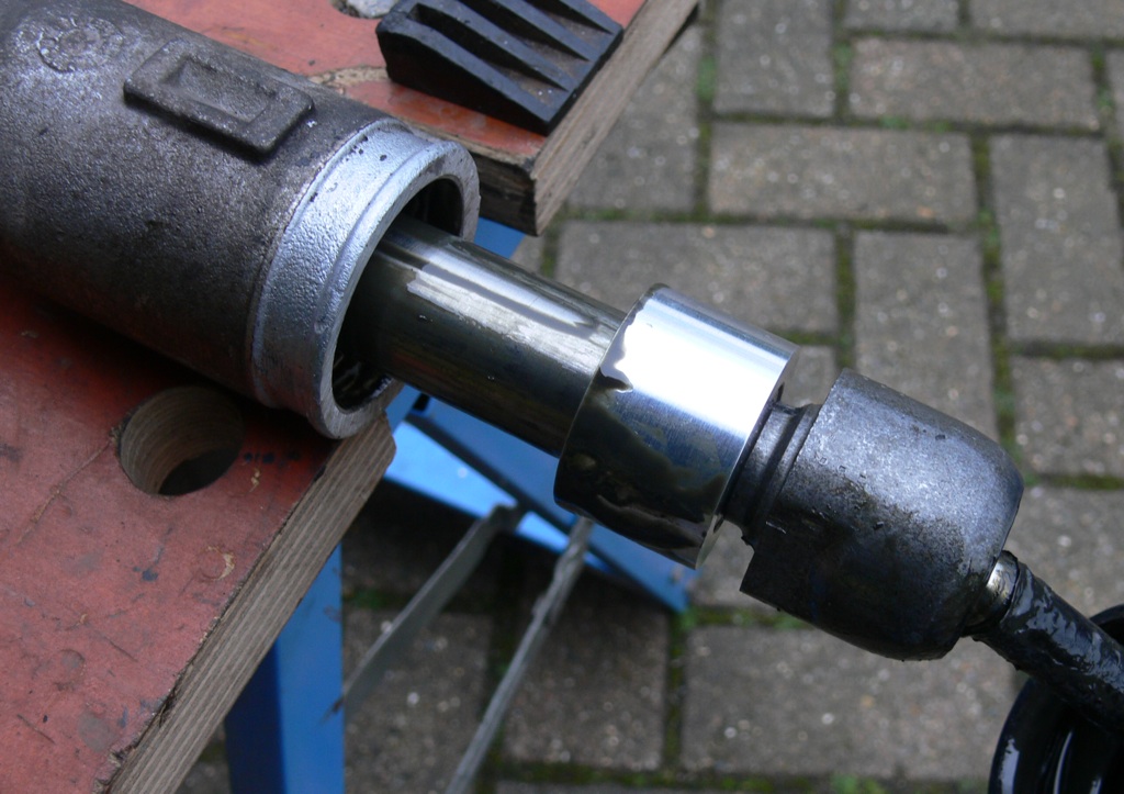

The stops are made up in aluminum, 22mm long, 35mm diameter, 23mm bore. Got a local place to make them up for £12, and got them the same day :)
They slip onto the rack, and are free to slide about. I should have possibly fixed them to the ends, but theres no way they are going to catch, and shouldn't wear very much at all.
If I do have problems in the future, i will redesign them slightly, but fingers crossed it'll all be fine.

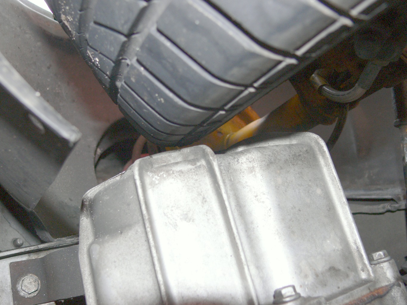

Lock to lock is now 2.5 turns!!!!! But as you can see from the pics, it couldn't possibly be any greater, as it's so close.

A stop:
On the rack:
Full lock, just clears the box:

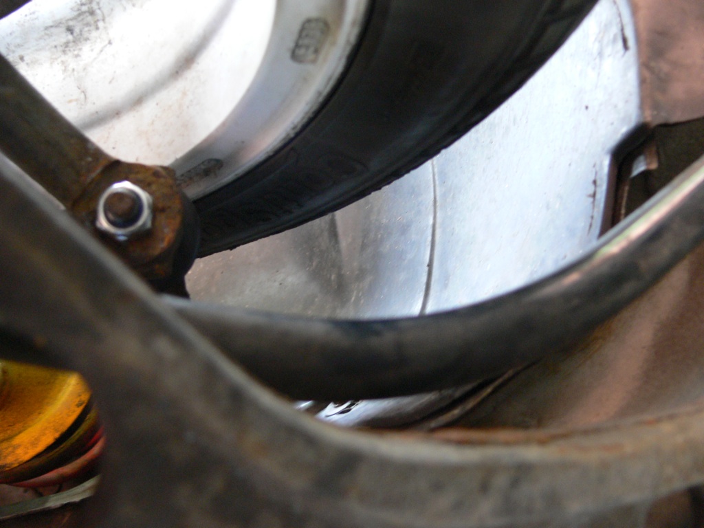

The ARB used to rub as well...not a chance now lol:
