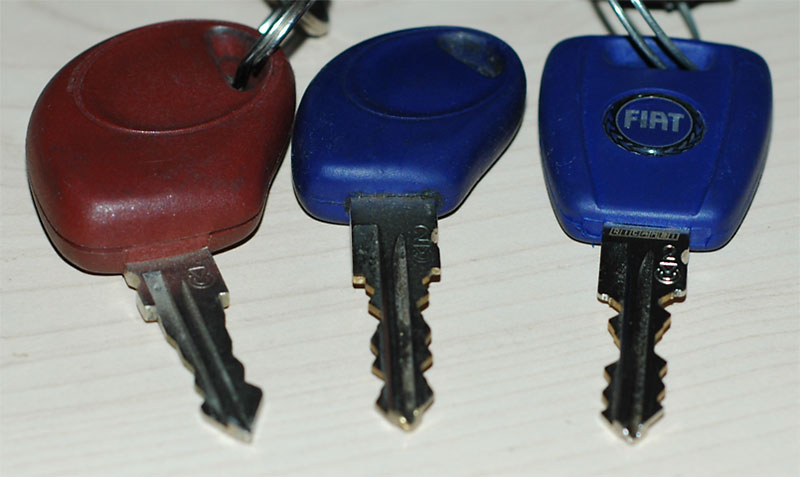

for the picture below:
The left key is a Code 1 Red/Brown
The middle key is an old style code 2 key
The right is a new style code 2 key

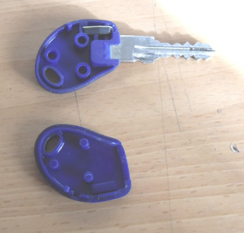

in this picture you can see the small transponder in the key casing
If the key has a transponder sign on it (Triangle with 2 little rings around the top) then it needs a master key. If it has a 2 on it, its a 2nd generation one and doesnt. If it has nothing then it dont need one either, according to Peter, chairman of FMCGB!
Thanks to thanks to pete(fixitagaintommorow),Centoevo and Alfanige for the Sei info and POWL for the picture
Sorry, I am somewhat confused. If a key has both (triangle with rings as well as a 2) is it a 2nd generation? So both blue keys in the picture above, (both have the number 2) are 2nd generation (=CODE 2)?
Am asking because I have 2 blue keys exactly like the middle one above. With both signs on them. Got the car second hand (Seicento Sporting Abarth '99 SPI) and never got a red key. Should I have gotten one, or are they 2nd generation because they have the "2" also, and I don't need a red key?

...I have 2 blue keys exactly like the middle one above. With both signs on them. Got the car second hand (Seicento Sporting Abarth '99 SPI) and never got a red key. Should I have gotten one, or are they 2nd generation because they have the "2" also, and I don't need a red key?
If they have a "2" on them, they are Code2.
So yes, yours are Code2 keys.

Makes sense surely to carefully cut out the transponder and tape it near the ign barrel where it will identify any fitting key? - esp. as I don't have the code card or a red key, just one blue and one black - and I'm not good with keys :eek:

With only one transponder (blue key) it still makes sense to take the chip out and fit nr ignition barrel surely..?

I'll put one on mi'chrimbo list lol - meanwhile works fine taped to the underside of the receiver unit - it's not going anywhere :slayer:
If it moves away from the receiver, even a small amount - car won't start anyway - it has to be right way round and just in the right place - pretty clever stuff really innit, though I'll need to check the tape from time to time of course. A piece of plasic shrink tube would be better - though just tight enough without applying any heat...
Galvanised or gold plated..? Well, as I was at Tesco anyway... the Timpson guy fair jumped to attention and quoted from £50 to £150 (+ a further contribution to the upkeep of our great nation...) for a key depending on the type of transponder... or £7 for just a plain old cut key... hmmm, decisions decisions... :rolleyes: - even he agreed it made more sense to tape the transponder to the receiver on a 14 yr old car...

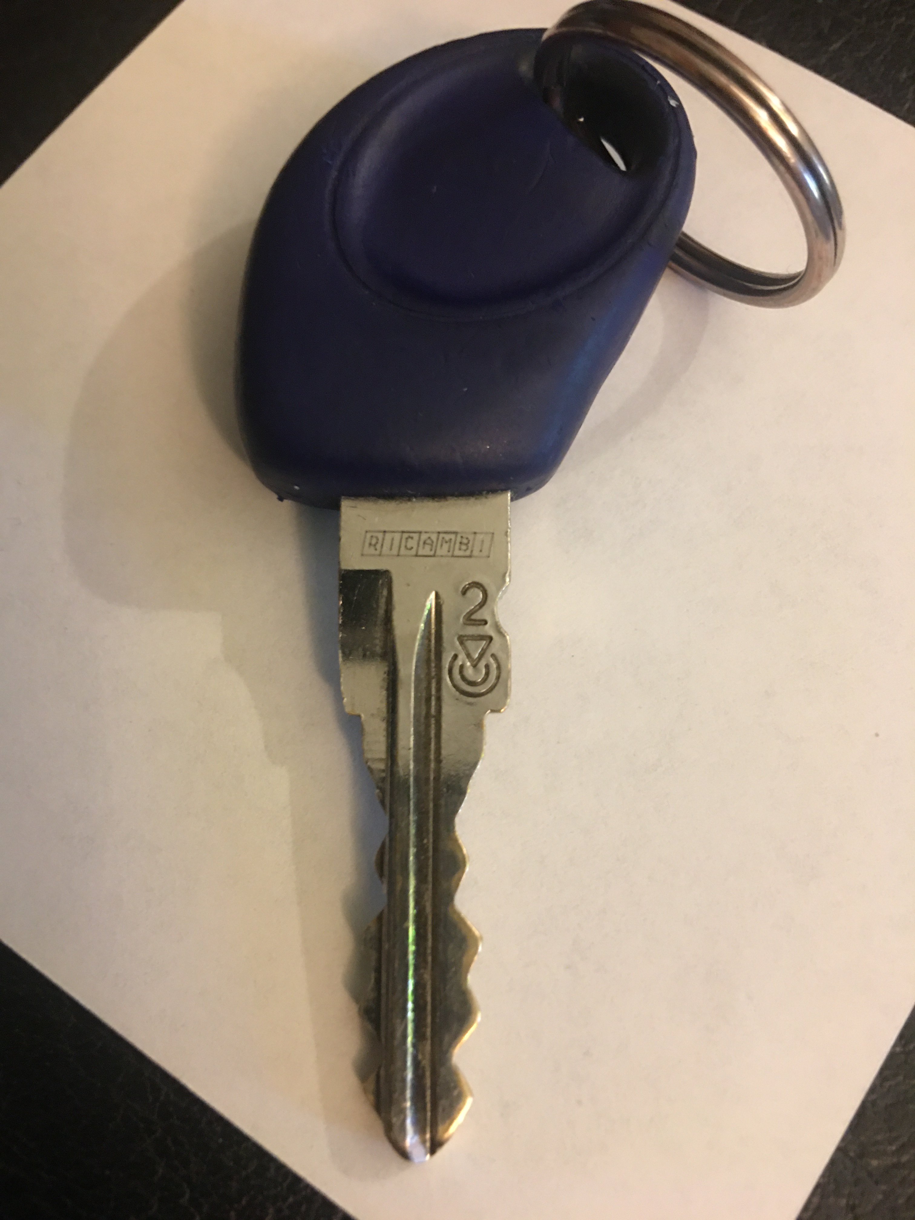

Hi,
My car is a 2001 seicento.
This is the key I have. I lost my other blue key of the same type / design, so I want a spare made. Can a standard locksmith make me a replacement key, or do i need to go to a specialist who can make another key with a transponder. If i need one with a transponder where can I go to get that?
Thanks for your forum.
