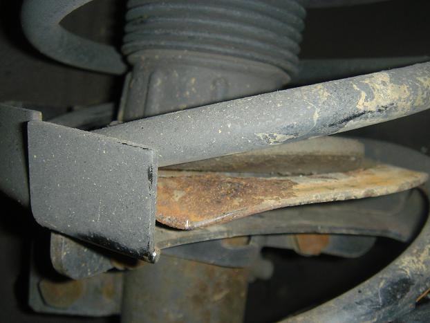

I must admit, this doesn't look like the sort of cup that was fitted to mine when the recall was done. Maybe it was fitted back to front??
Must have missed that one. Shall I post some pics of what a correct fit looks like?

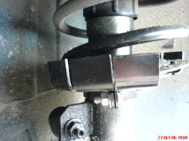

I think it's the right spring catcher mod (here's one)
but your picture looks like the broken spring has taken one or two of the side spring catcher legs out with it along with a chunk of the base which is why it doesn't look like it should. Got any more pictures?
The Pepsi can spring catcher mod doesn't look tough enough to stop an exploding spring and that kind of proves it. Glad i went for replacing springs instead then
No intention to rub it in, sorry if that's the way it sounded. Just think that the only surefire solution is a replacement of the spring with something different
New springs are very similar to the originals, same ride height, but less nose diving in corners
