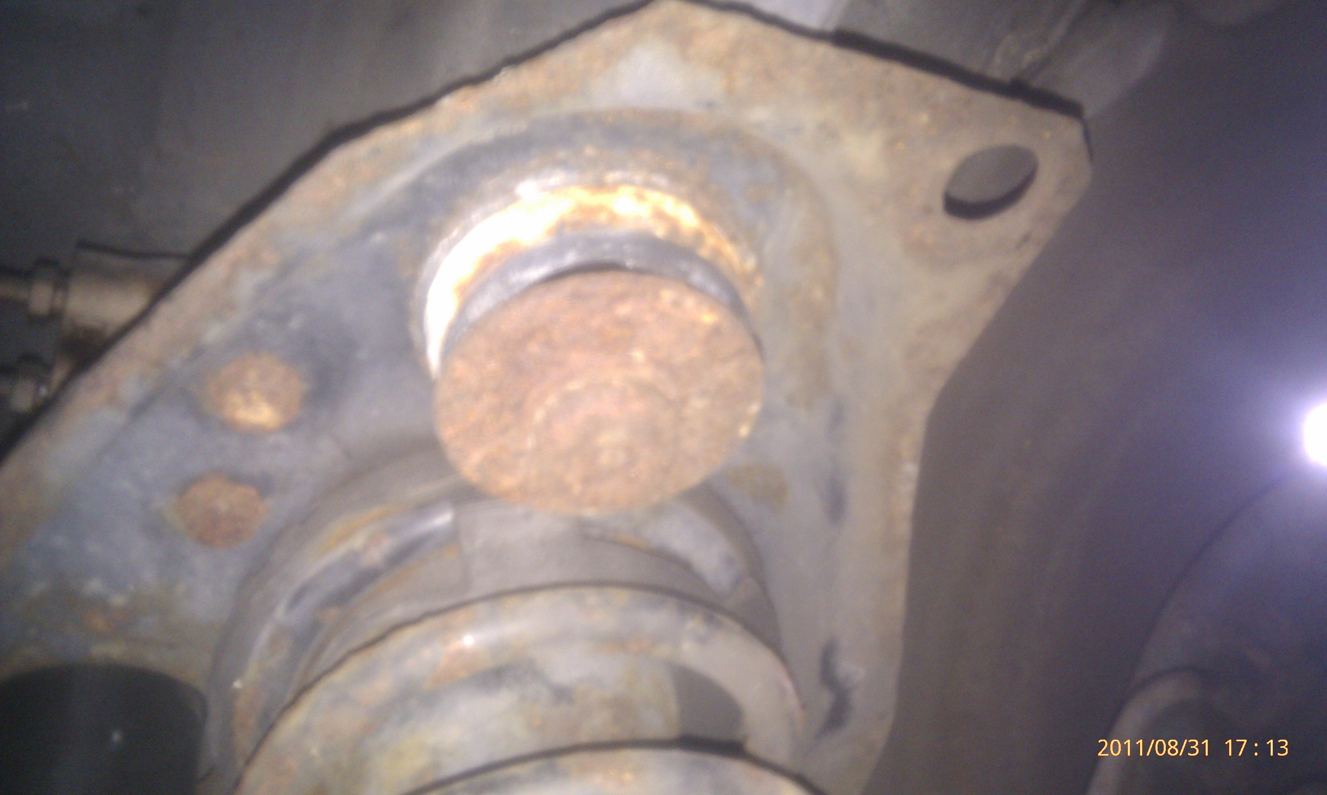

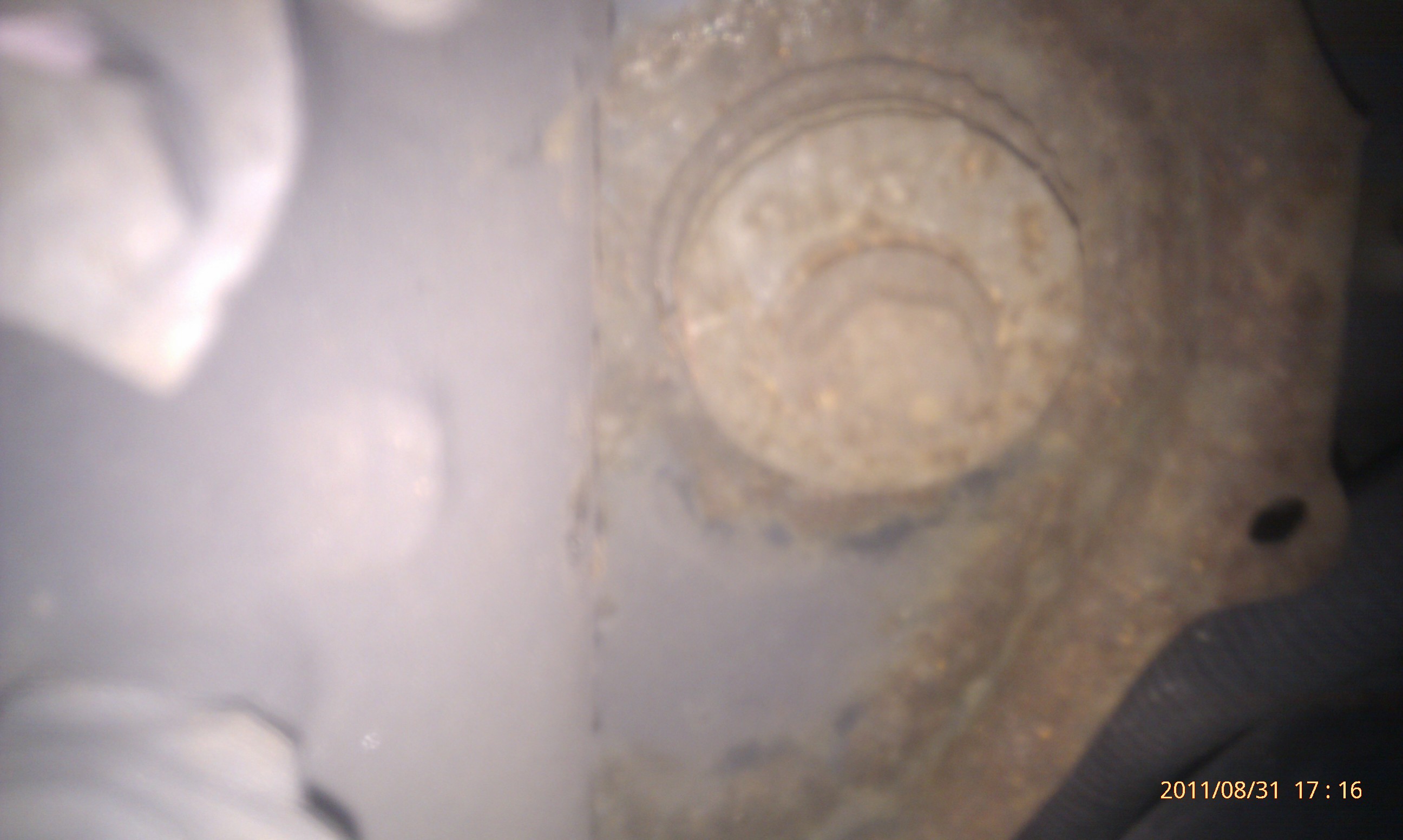

hi when you look at the back of the car do the wheels look like they are sloping outwards?
because of the design of the rear radius arms on a punto it can only be either the springs or the radius arm bushes that are are causing the problem, springs are not that expensive and are easy to fit, the radius arm is a different story as you have to remove all the rear brake components to remove it and put them on the replacement {iv`e just done both of mine} and don`t be tempted to buy the radius arm repair kits as they are a pain to fit and only last a few months.

as Barbo says buy the complete arms not the kits
they used to be £35 complete, main problem was shearing bolts and the anti roll bar was best dropped down to aid removal/refitting
the hub nut can be removed and all the back plate with brakes with pipes and handbrake cable slid up to one side while doing these so saves lots of hassle
to be honest if you dont feel confident find a back street garage to do them they arent that difficult if you have big hammers and the knowledge

These two I been told need replacing
What are they called ?
