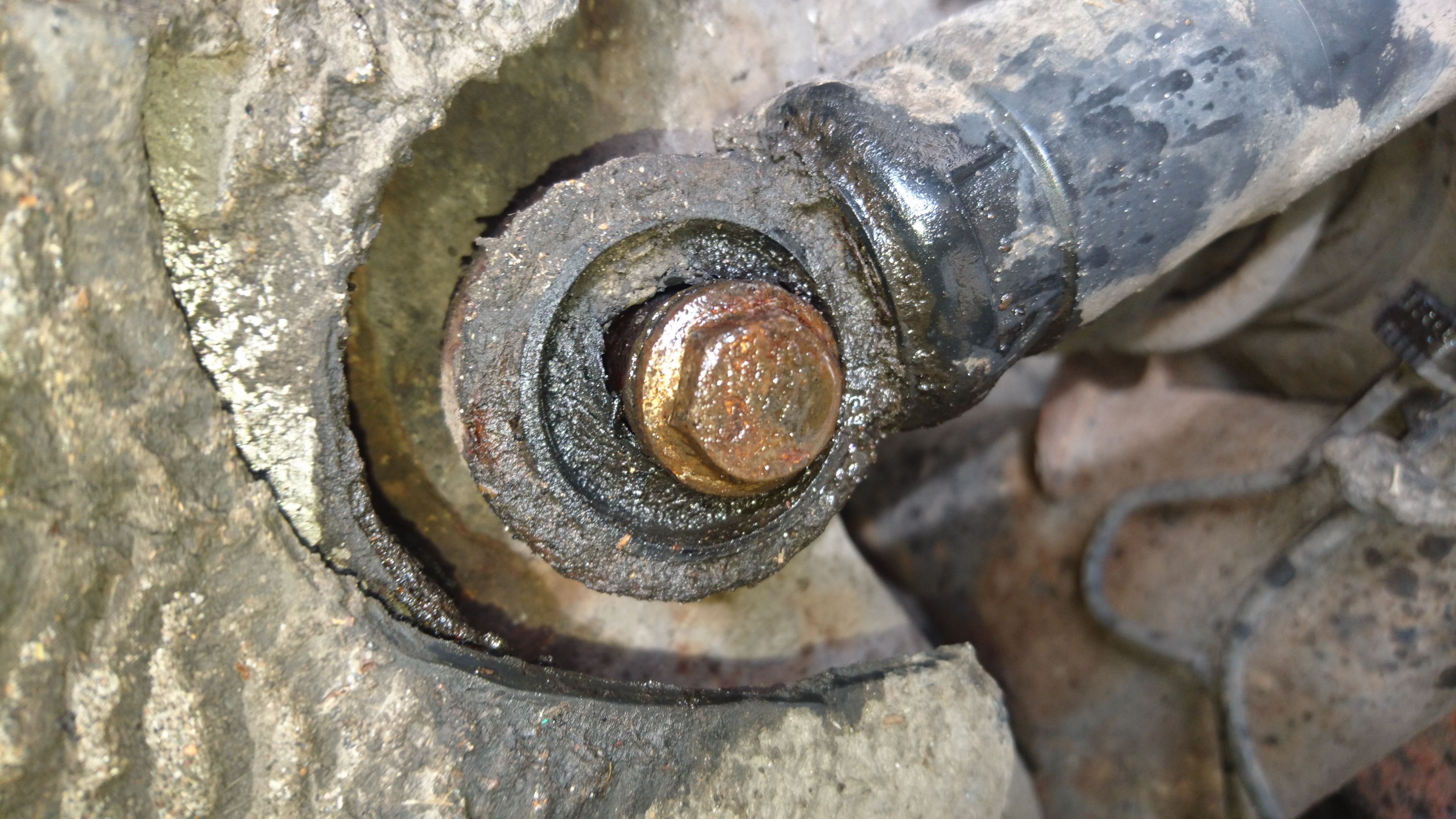

7 days for delivery fitted today simple job but hard work un-doing the lower bolts especially the exhaust side the shocks rubbers were shot
