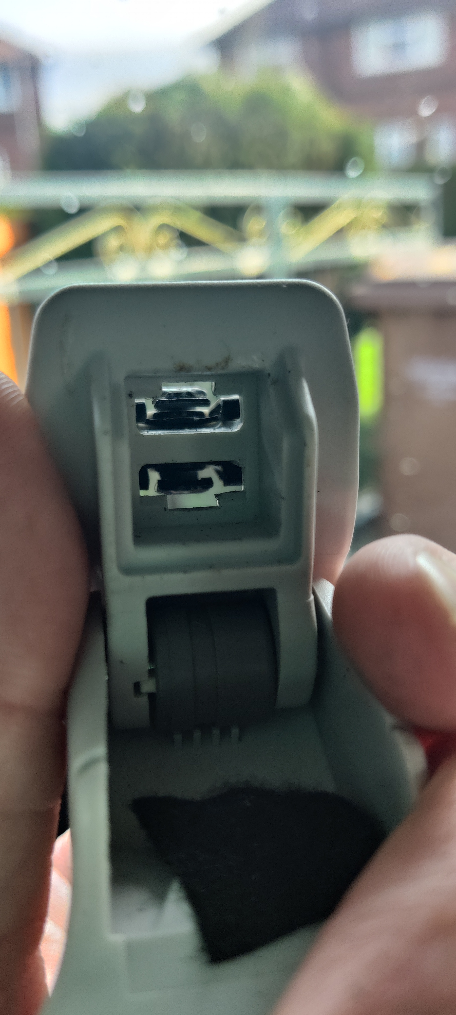

Anyone else has issue with them rattling when driving around?
It's by far the biggest noise in the inside of my tipo the handle seems a little loose fitting in my eyes but the fitting is wierd it some sort of clip rather then bolts like I was expecting under the covers
Any one how these this are supposed to hold or a way to stop it rattling as much?

Nobody any idea on how these are fixed then? Or how to remove them
I'm assuming some type of clip
Are you sure they are not covering bolts. I wouldn’t have thought clips would withstand someone pulling hard on the handles?

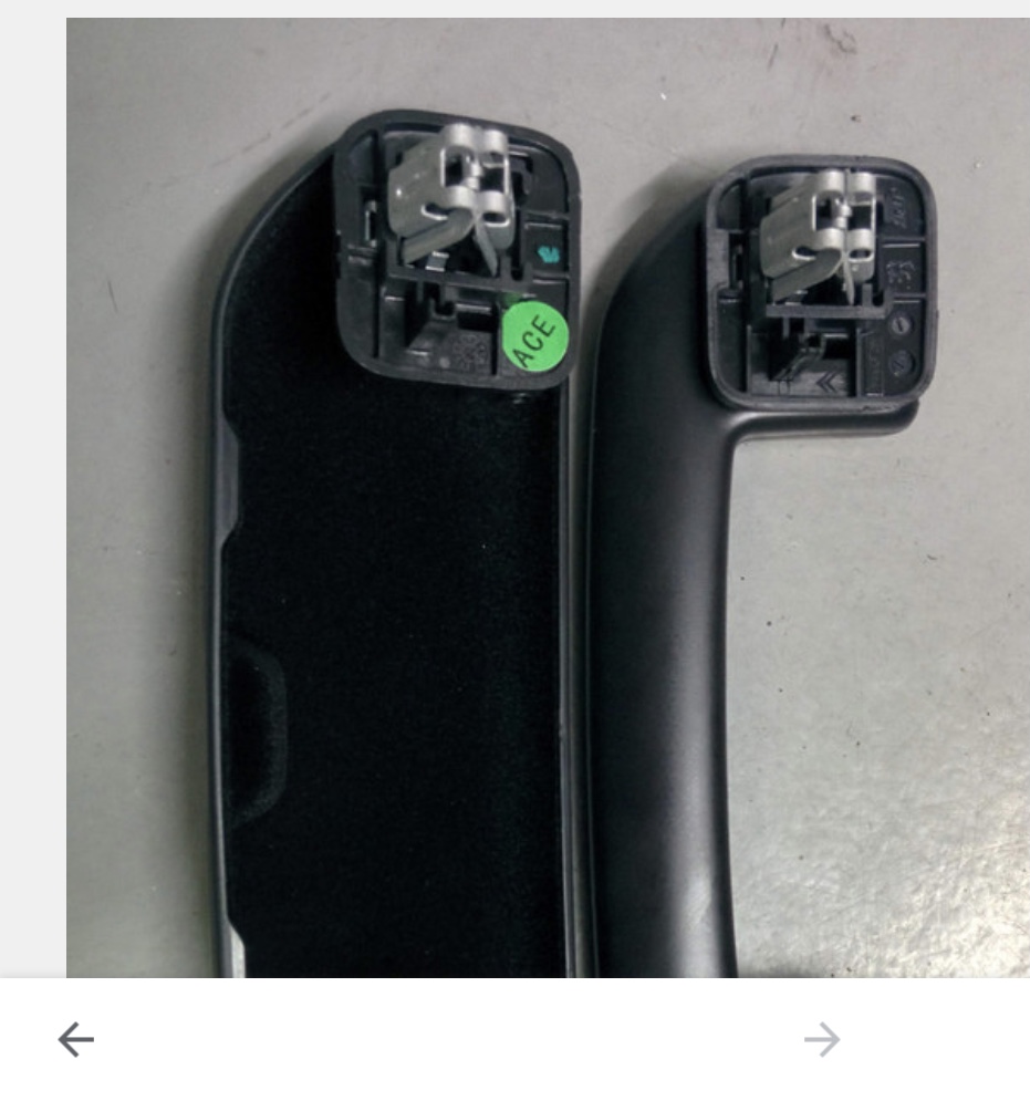

I would guess they are similar to those on a Peugeot . It looks like they use a small flathead screwdriver to press clips to release. Google for a video there seems to be a few. Weird way of holding them on.

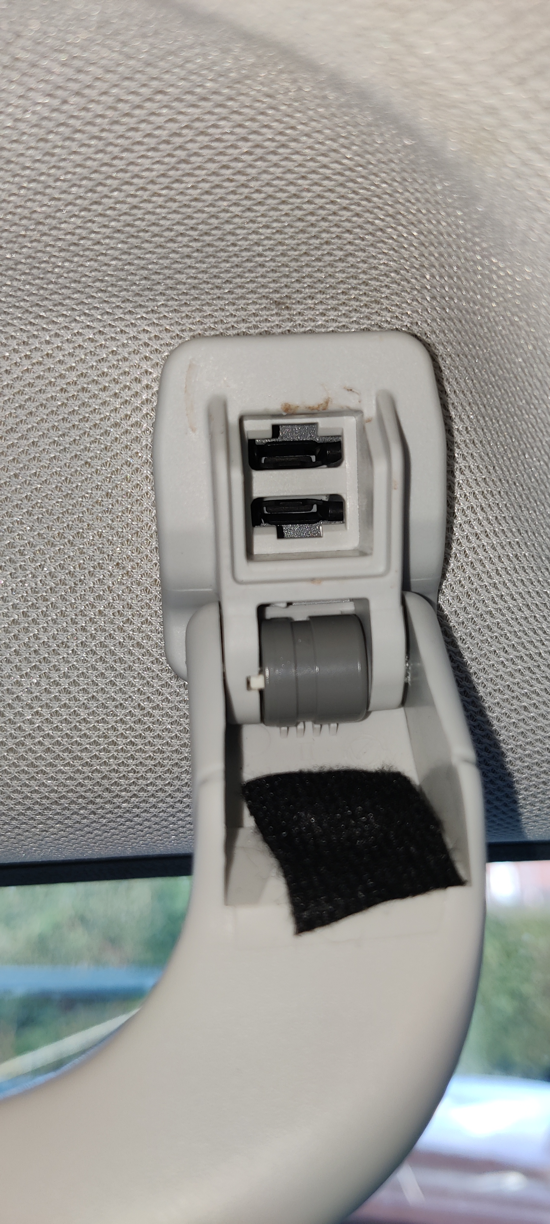

Finally got around to looking at this again and got them removed using a small flat blade screw driver to prise the clips off while pulling the handle away
After removing bend the tabs out a bit to hopefully allow it to hold a little better so it won't rattle now
