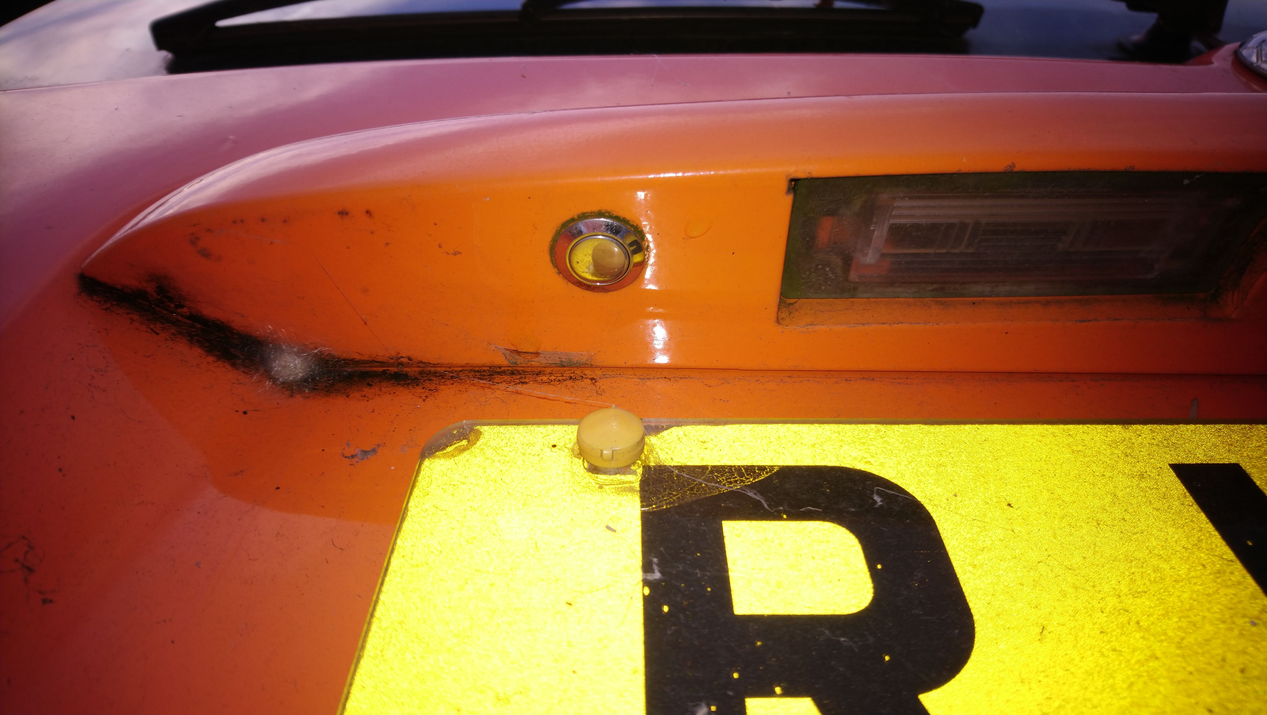

Hi Jock, I've also tried to fix our faulty hatch release. I agree, a microswitch without proper protection from the elements is asking for trouble. And it delivers!
I would recommend cleaning the handle, as lots of muck gets thrown up and forced in there. I followed the guide on here to remove the handle and clean with a toothbrush and warm soapy water. I didn't lubricate it as I didn't want to attract more muck. I'm not sure it needs lubrication, it's a simple plastic hinge and it pokes a (hopefully) sealed microswitch.
However, although cleaning improved ours, it's still not perfect.
It was trouble when we got our 54 plate (with remote unlocking) four years ago. The handle would hardly ever release the hatch, and then the hatch would occasionally open itself whilst driving!
It seems build-up of muck was keeping the handle in contact with the microswitch which would suddenly decide to operate.
After cleaning it stopped opening itself (now I check the handle to make sure it doesn't stick in the 'open' position). And the handle released the hatch reliably for a while, but over time it became more intermittent.
I've taken the handle off and cleaned it again, but it wasn't very dirty the second time, and the release microswitch is still intermittent.
On the occasions when the hatch fails to open, I can hear the switch clicking when I move the handle. It just doesn't do anything. I'm tempted to do the same as pb above and fit a separate switch.

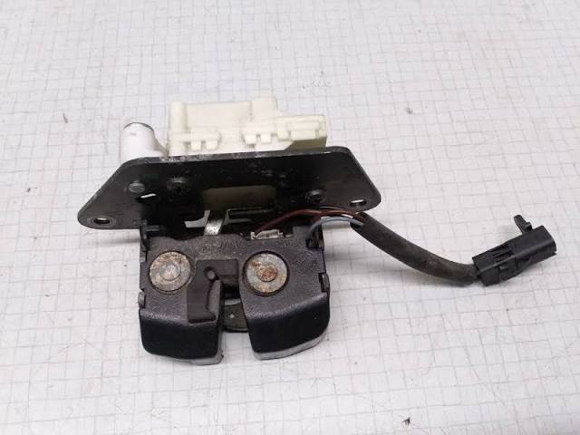

The key lock barrel pulls a rod that releases the latch, so possibly that frees up the latch mechanism, then after a while the handle/microswitch activated switch in the latch isn't strong enough to do so any more? Maybe cleaning and lubricating the latch itself might help? I'll give that a go too and see if it continues to work.

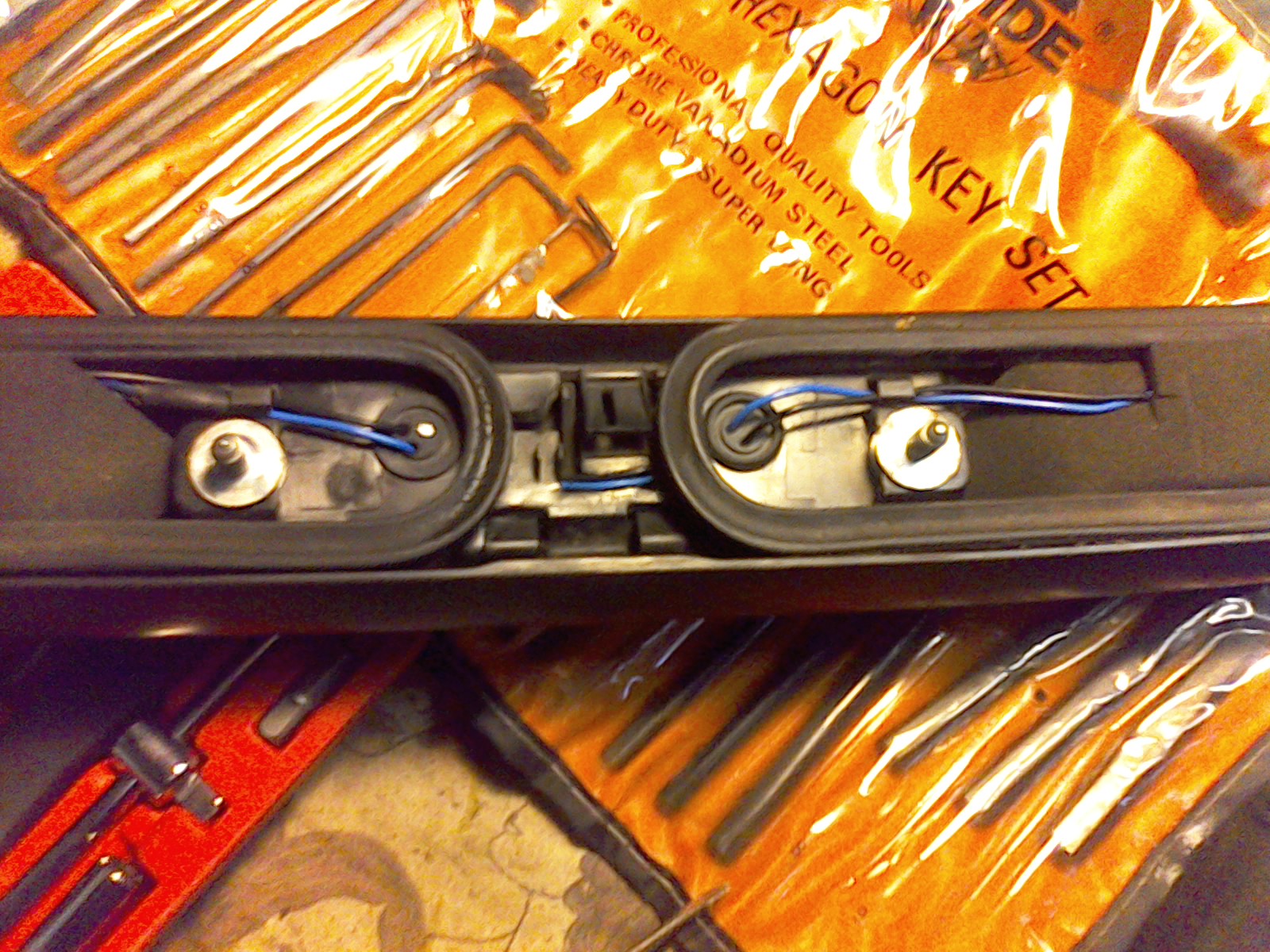

Thanks' for the video, I removed the assembly again today and there is no micro switch for the release handle. In the video it shows four wires on one side presumably two for the switch and two for the right number plate light.
I think because my car is a pretty basic model 2004 Dynamic it didn't come with the option, as with the boot light.
Also I don't have remote locking.

Yes it does have trip facility and also there are wires going to the latch mechanism, but as you can see in the pics no micro switch and no wires for it.
In the middle pic you can see something jutting out, that's a padlock I've placed there to hold the assembly in the best position for the photo. Hope that's not causing the confusion.
