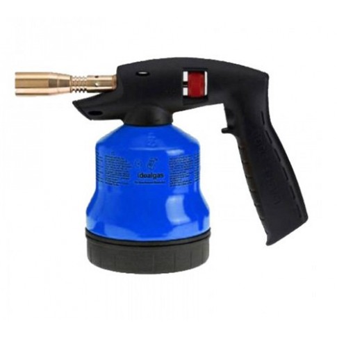

Thanks for the reply. Do you think this kind of butane torch will do the job?
