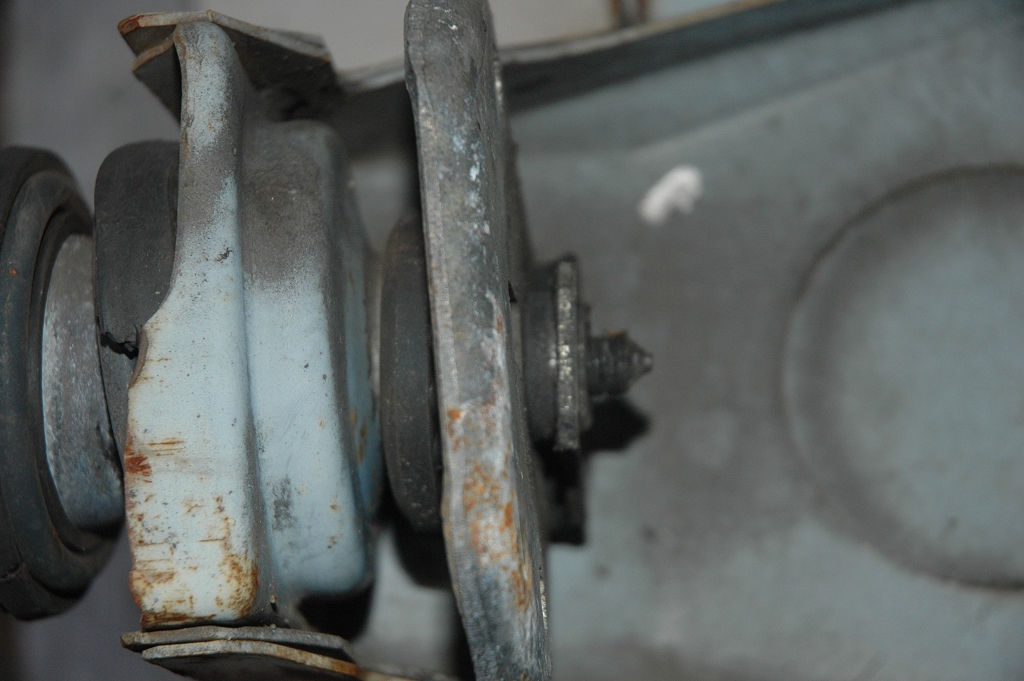

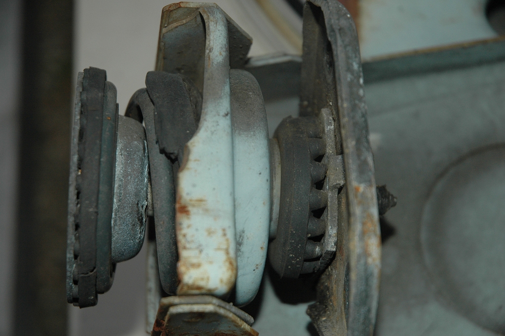

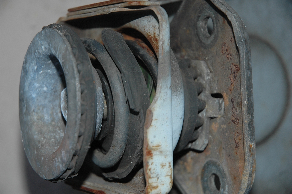

Does anyone have a pic of how the rubbers are fitted to a rear engine mount on a 126.
Thanks in advance.
Brinky.
Here are a few photos of one that I've got in the shed.
Hope they help,
Chris

Hi Guys- Great pics but the lower bump stop is upside down (pointed parts of rubber should point upwards) It is fairly self explanatory how it fits together if you have the kit- The Thinnest rubber is at the top, Thicker rubber at base of spring and bumpstop below the mount.
Happy mounting!
