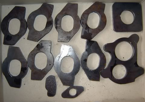

@ Asteris:
Do you have the autocad drawing of the custom plates?
Otherwise I should redraw it by my self in a 3d programm and convert it tot 2d CAD
I use solidworks 2006 at the moment for the drawings.
A few days ago I get this back from a company that does plasma cutting.
Only they weren't able to cut the screwholes in it.
This are my new turboplates and exhaustmanifold.

@ Asteris:
Will search for it when i am back at home and send it to you.
For whoever needs a ready made set, my mechanic has some modified sets left (for the 240mm disk). Price is 25£ + shipping, send PM for more...
